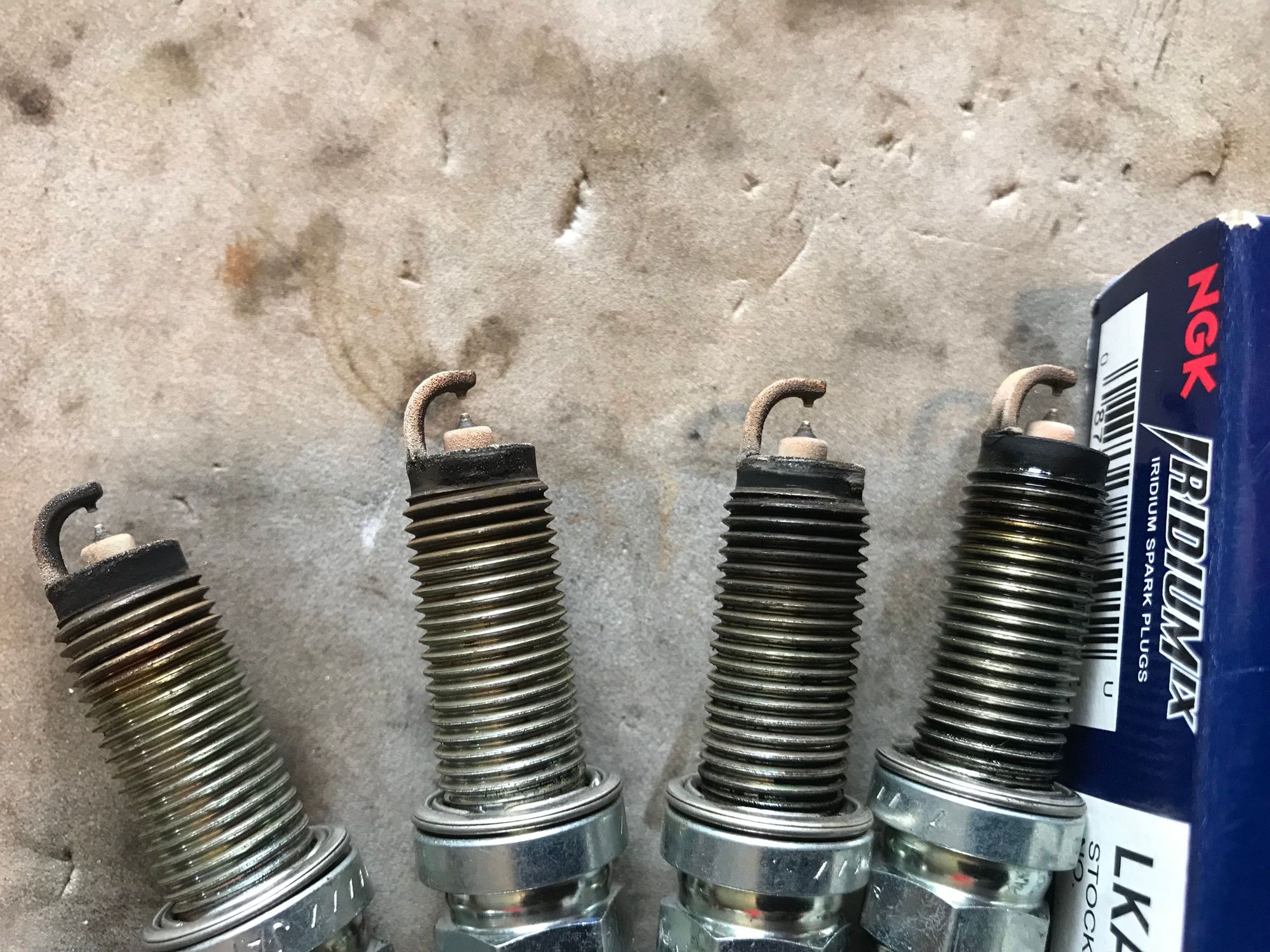

Old plugs, cylinder 1 through 4, from left to right. Electrode gap still looks ok but there are some whiteish deposits on the insulator and the ground electrode, probably from leaky valve seals.
