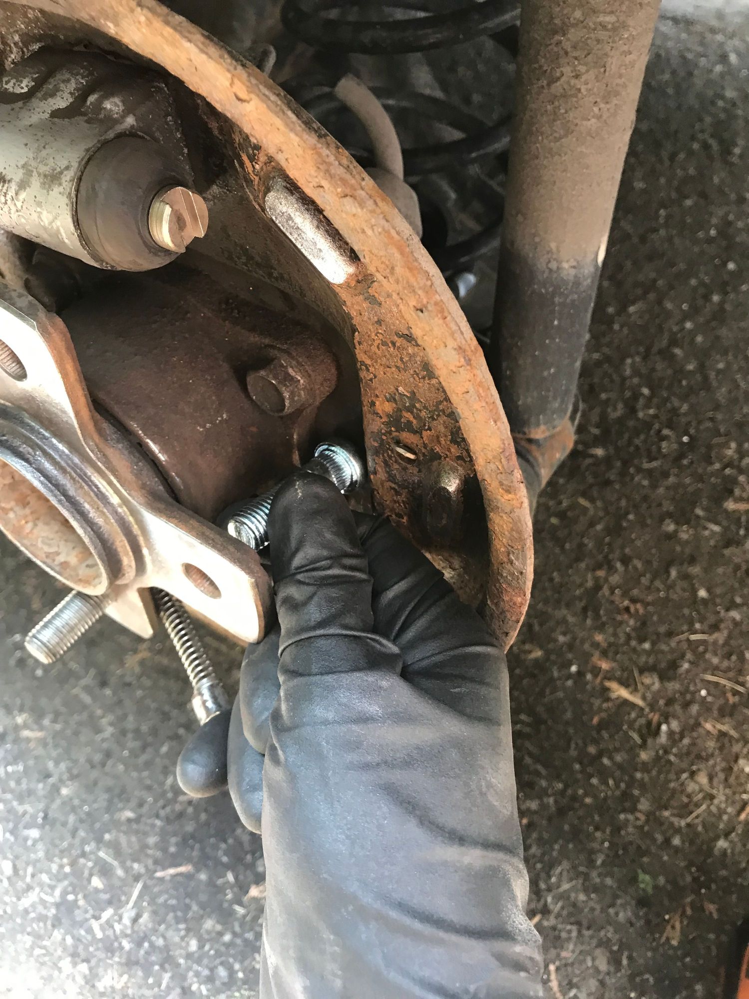

Loads of clearance to install the stud from behind. 2 good whacks from a regular hammer and out came the bad studs. No heat, no penetrating oil, nothing. I couldn’t get the “splines” to align with the old ones and it took nearly the highest setting on my impact driver to pull these through with lug nut. I wouldn’t want to attempt this with a wrench.
