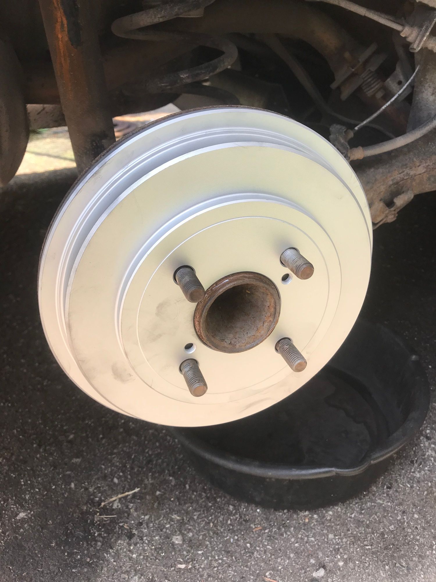

Powerstop Geomet coated drums. Probably due to the coating, when I was adjusting the shoes, no hand brake resulted in slight drag and one click meant impossible to turn by hand. It was possible to turn the wheel with difficultly at 1 click with the wheel on. Easiest adjustment I’ve ever done. The coating inside will likely wear out a bit in the next 100 km of driving.
