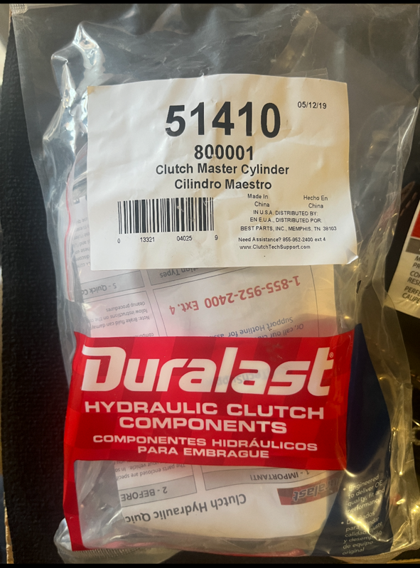

This model has the same bolt spacing, the same bolt length, the same cylinder diameter as OEM. The only difference is the slightly different angle that the hard OEM clutch hydraulic line bolts on, when it is installed. It is still workable.
