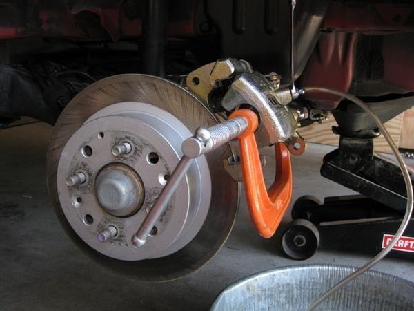

How to bleed the T1R rear dics brakes (2) »
Jodele June 20, 2009
Since the caliper is rotated up and out (with the pads removed) a 6” C-clamp is used to hold the piston in while the system is bled. Notice that the caliper has to rotate far enough so the bleed bolt is above horizontal (facing upwards slightly).
