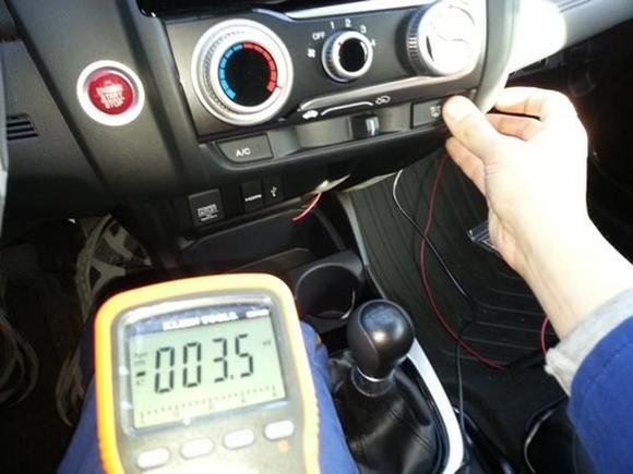

With defroster switch off. Ran red wire from 2ndary side of defroster relay. This is the 30AMP side to the defroster window grid. Do not connect wire to coil side thats controlled by the ICM
