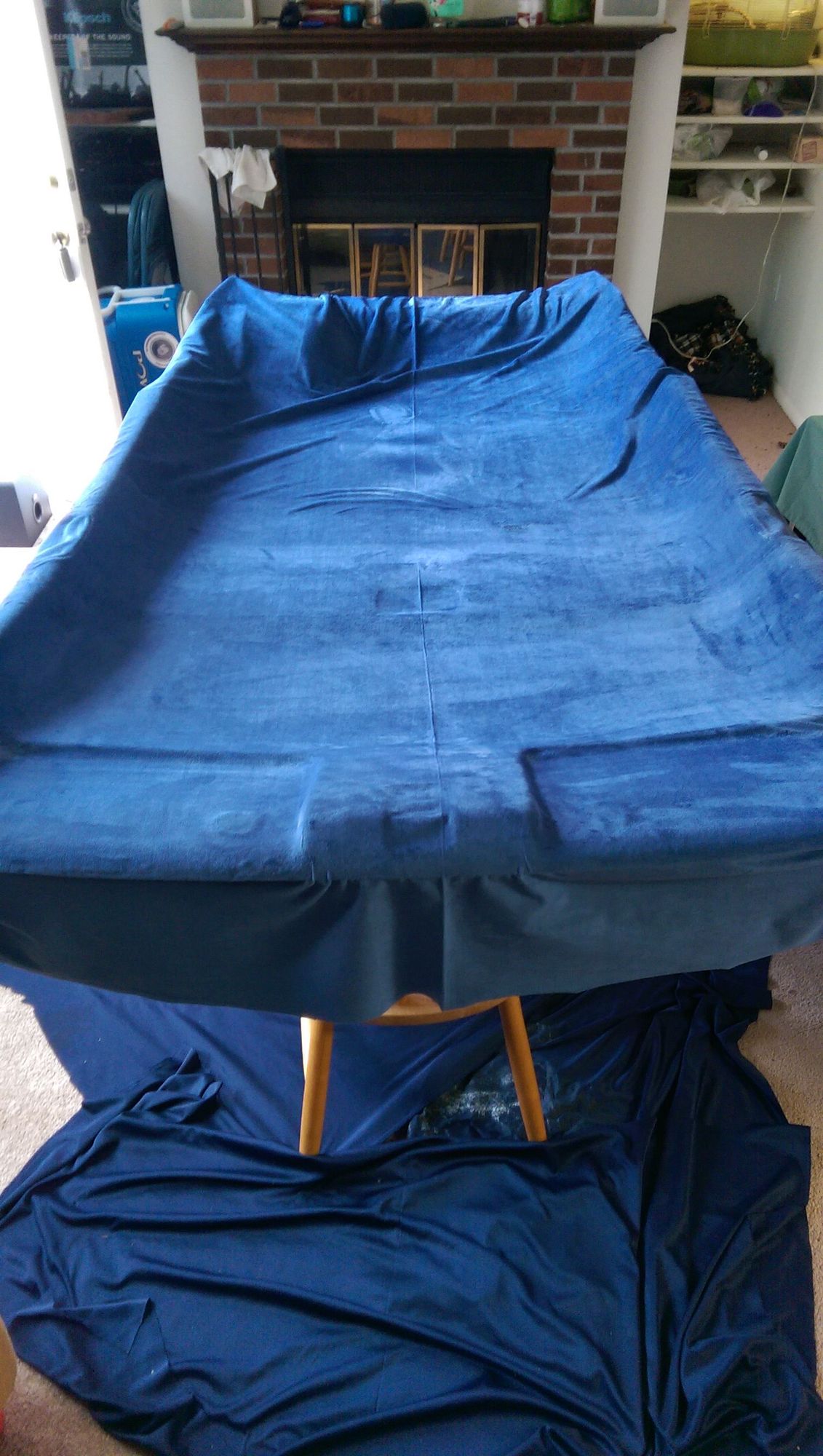

This is the progress half-way through the gluing. USE CONTACT CEMENT!!!! SPRAY ADHESIVE SUCKS MONKEY BALLS! Work from the middle in small strips. Cover both the headliner AND the fabric. Let them get tacky, and then adhere.
