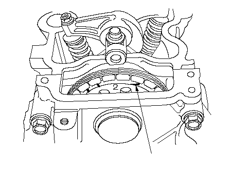

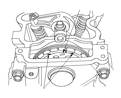

NOTE: Valves should be adjusted only when the cylinder head temperature is less than 38°C (100°F).
1.Remove the cylinder head cover.
2.Set the No. 1 piston at Top Dead Center (TDC). The ‘‘UP'' mark (A) on the camshaft sprocket should be at the top, and the TDC grooves (B) on the camshaft sprocket should line up with the top edge of the head.
AB
3.Select the correct thickness feeler gauge for the valves you're going to check.
Intake: 0.15-0.19 mm (0.006-0.007 in.) Exhaust: 0.26-0.30 mm (0.010-0.012 in.)

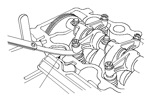

4.Insert the feeler gauge (A) between the adjusting screw and the end of the valve stem and slide it back and forth; you should feel a slight amount of drag.
A

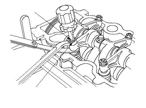

5.If you feel too much or too little drag, loosen the locknut (A), and turn the adjusting screw (B) until the drag on the feeler gauge is correct.
A
14 N·m
(1.4 kgf·m, 10 lbf·ft)
B
6.Tighten the locknut and recheck the clearance. Repeat the adjustment if necessary.

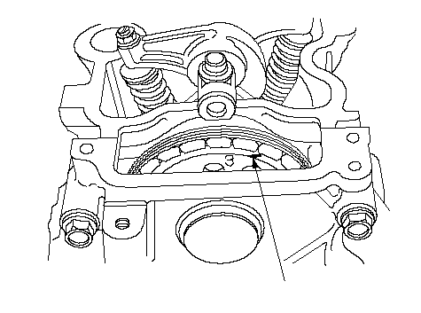

7.Rotate the crankshaft clockwise. Align the No. 3 piston TDC groove (A) on the camshaft sprocket with the top edge of the head.
A
8.Check and if necessary, adjust the valve clearance on No. 3 cylinder.

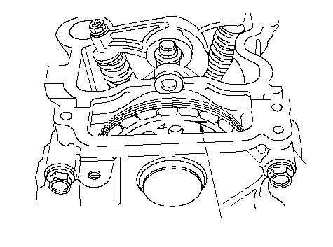

9.Rotate the crankshaft clockwise. Align the No. 4 piston TDC groove (A) on the camshaft sprocket with the top edge of the head.
A
10.Check and if necessary, adjust the valve clearance on No. 4 cylinder.
11.Rotate the crankshaft clockwise. Align the No. 2 piston TDC groove (A) on the camshaft sprocket with the top edge of the head.
A
12.Check and if necessary, adjust the valve clearance on No. 2 cylinder.

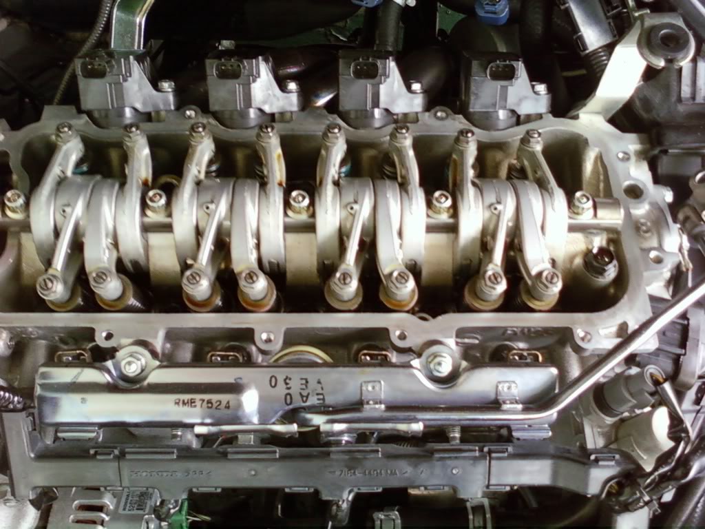

so I adjusted my valves today and they were way off, 5 of the intake were at .013!

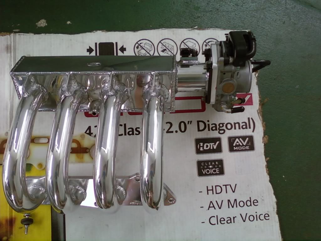

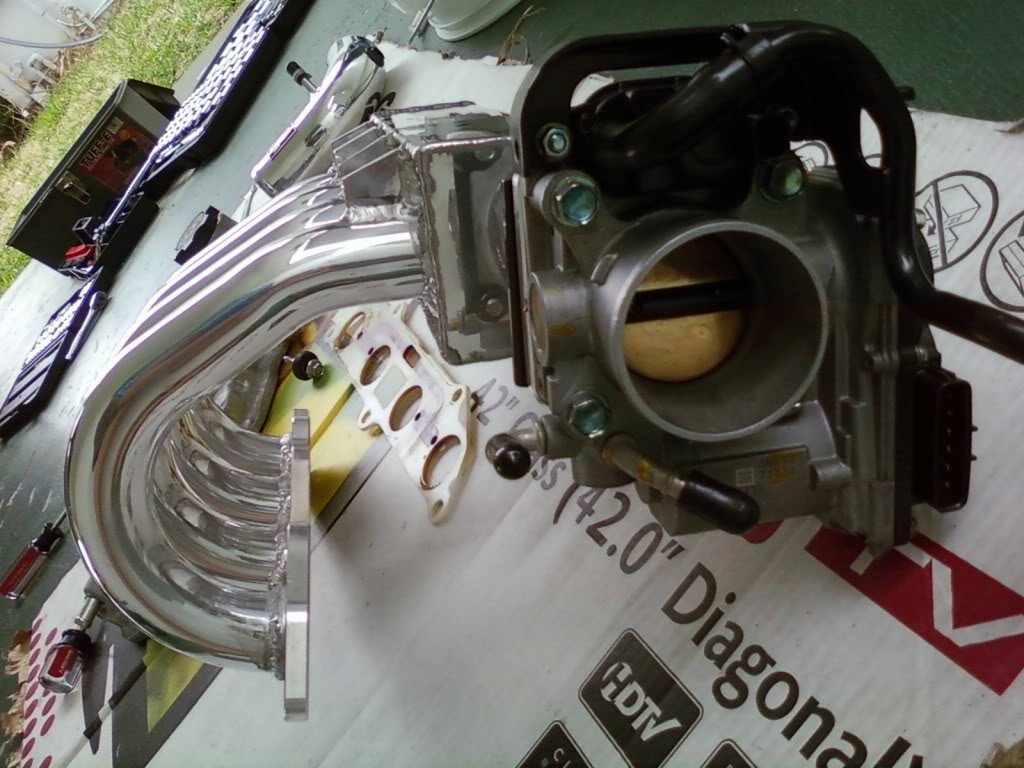

Here are some pics

Now the car is running much smoother with no knocking = )

Ick... upper manifold removal.
Related question-- how much does Honda charge to do it?
I've done it myself on a couple Hondas many times but never on a car under warranty. Got darn good at the y8, I could do the whole job in about 15 minutes from cover off to cover on with new gasket and hondabond. Dumb exhaust valves always changed on that car.
