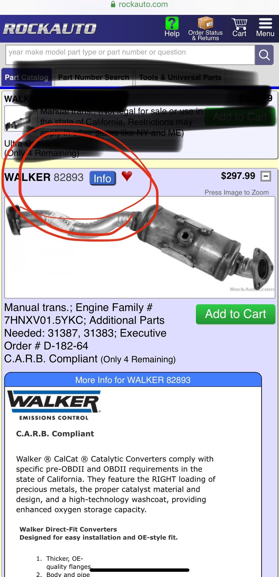

I did the same thing last month. Needed a cat and couldn’t find anything reasonable. I ended up going with this and it works for smog. Dealer only comes with cat no sensors. Hope this helps.

Thanks for the help. I'm a bit confused. How did you make this work? It clearly states here, "Not legal for sale or use in the state of California." So this passed smog? Did it come with sensors? What did you do on the sensors?
Sorry for the confusion. The part # circled in red is the CA compliant. I use the same old sensors that were in my straight pipe. No more check engine light.
OK thanks. BTW, the "Additional Parts Needed: 31387, 31383" are the gaskets?
yes, they are.

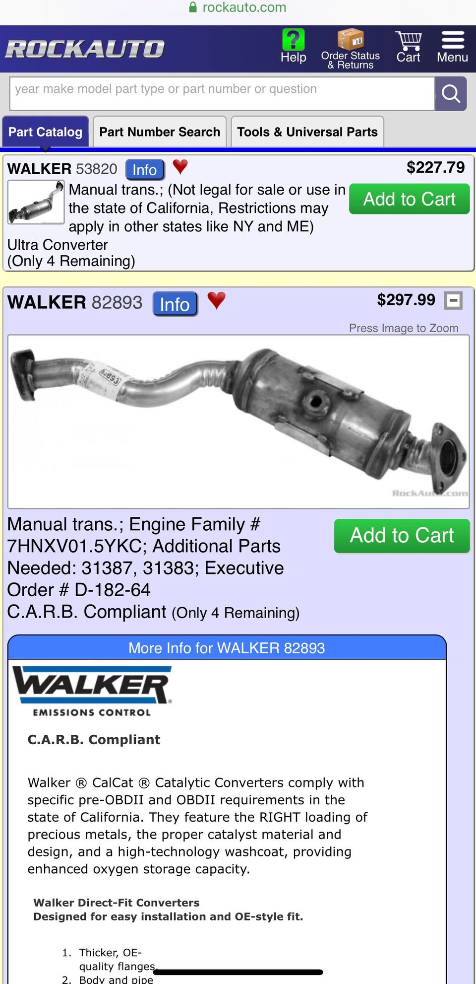

Thanks for the info Chris.
Is the cat still working / not giving a check engine light? I ask because it went from $297.99 to $657.99:
