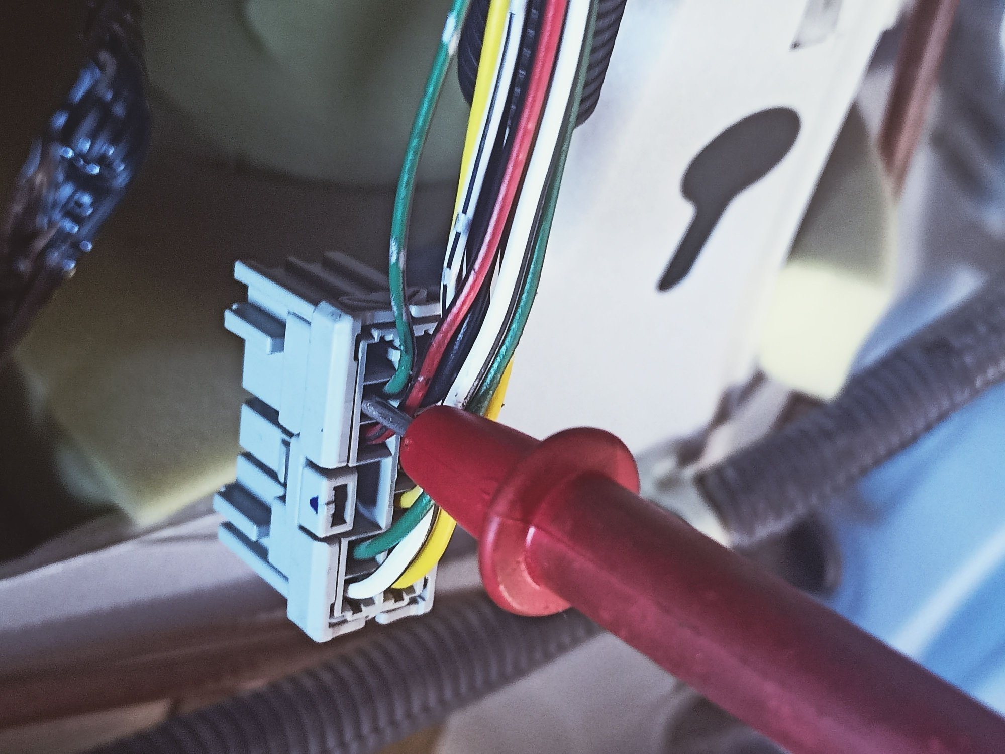

Success! I found the green/red wire in the tailgate wiring that connects to the tailgate switch, and spliced into that for the ground for the LED strip. I'm still powering it from the 12 V lighting circuit from the under-dash fuse box, so my earlier cable run was not in vain.
Checking green/red wire to tailgate switch
