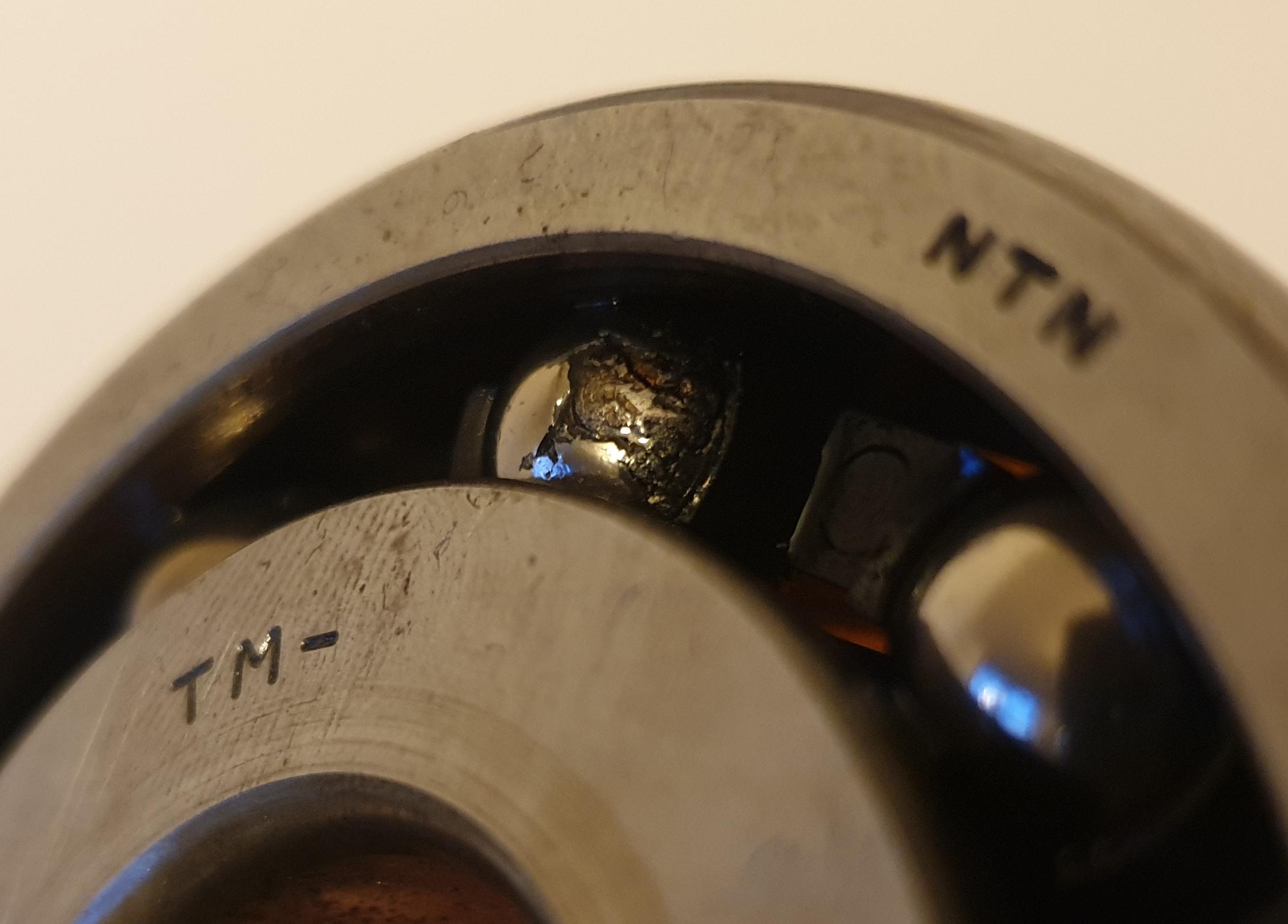

It's goooone. I don't know how much longer it could've lasted before falling apart completely. Probably enough to survive an event but I wouldn't have any confidence left. Every single ball looked like this up close
Attachment 85447
I had to heat up the casing from the outside and it fell off when I gently pulled it with a seal remover.

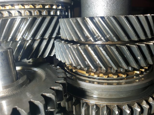

Other than that I suppose it was in pretty good condition for the distance it covered. Not much wear visible other than the low gear at the bottom right. This would explain the grinding I heard on the test drive when reversing. It seemed like it was in, but wasn't. I see many people starting reversing before coming to a stop so that's probably how it got so worn. A new gear is pretty expensive to put into a beater so it stays.
Attachment 85448

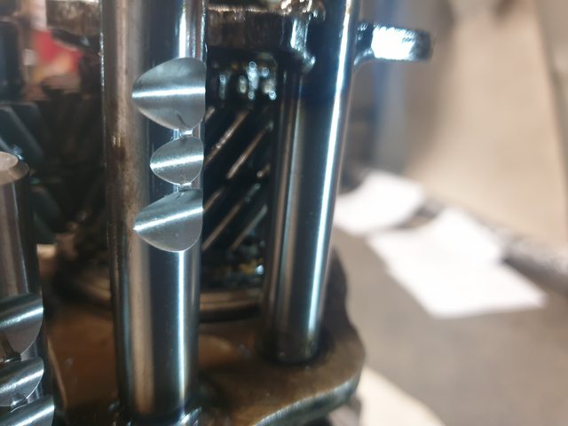

Somewhat surprising amount of wear by the ball detents, but far from actually being a problem.
Attachment 85449

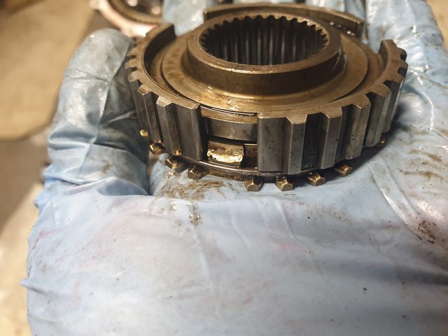

My big new bearing has to be pressed into the housing, right? So I started hammering it through rubber and wooden blocks until it seemed to be mostly seated. Started tightening the bolts a bit and... there's weird crunching sounds. Damn. I removed everything and the transmission was now jammed and 5th/reverse wouldn't switch at all. Shit. Poking at it for a bit, I finally got reverse to engage. This also let me start disassembling the shaft. Eventually I found the issue: somehow the 5th gear synchro hub and ring got misaligned (even though I didn't touch anything on the shafts) and I didn't notice it before the final re-assembly, so it got a bit crushed.
Attachment 85450
Ooops! Thankfully it seems like there was enough meat left to prevent the ring from spinning so I cleaned everything up, made super-certain that everything was seated properly this time, and easily put the case back together. Huh.

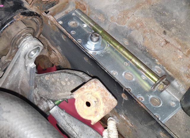

Everything else was the reverse of removal. But first I had to do something with the broken trans mount nut on the rusty bracket. Thankfully the rail to which it was attached had a 10mm hole that matched up with a hole in the mount. $2 of threaded rod and nuts later, the solution is complete. Would TUV approve this? Probably not, but nobody won't see it, and if it's stupid and works, it's not stupid as far as I'm concerned. I did order a new mount from Febi Bilstein ($15) but I'd have to somehow cut out the old bolt and I really didn't want to deal with it now.
Attachment 85451
