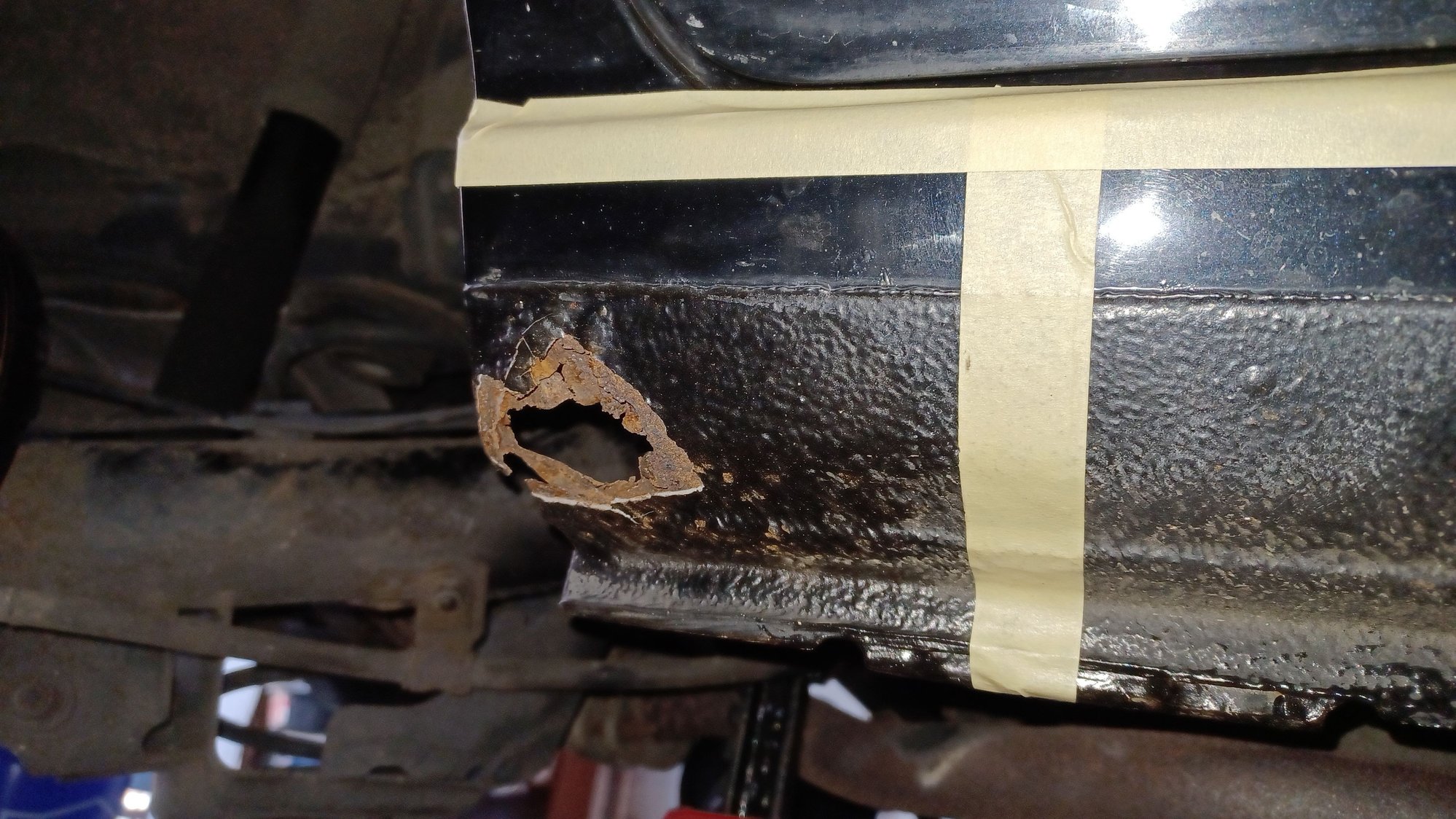

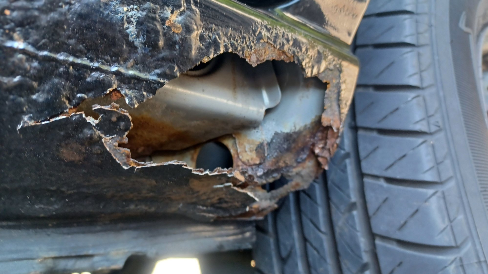

1) Rocker panels
This area is well known and the most visible. But be aware if someone has coated part of the panels in some sort of rhino liner like on my car. It will hold the rusty metal together while it falls apart. Below is the my passenger side rear before starting anything
The rust actually extended another 2 inches to the right of the tape
The drivers side. This is after I started really poking at it. Before I did that the liner was holding it together.

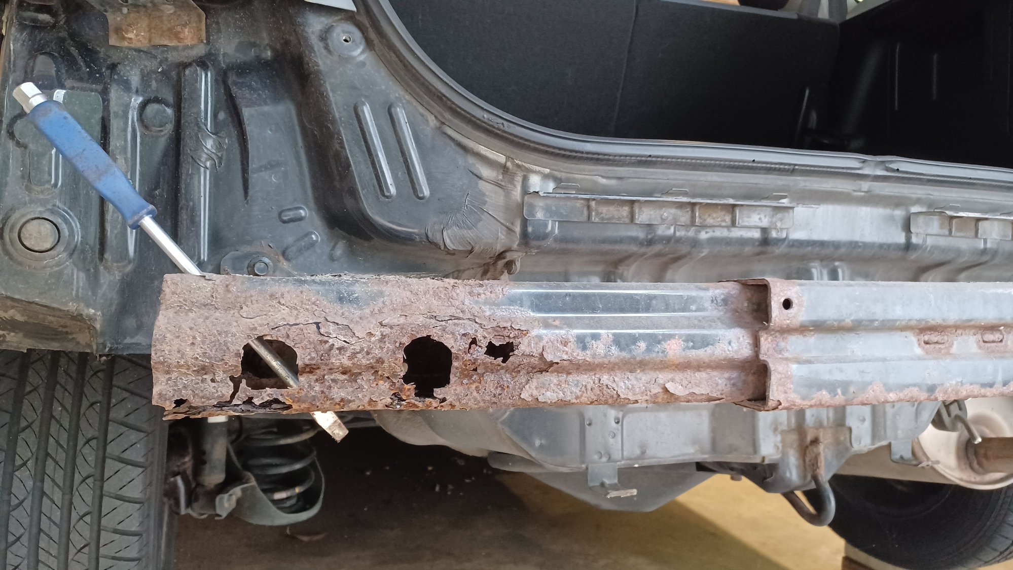

4) Rear crash bumper
This was caused by the rear tires kicking water and salt up into that area. Only way to stop it is to DIY some mud flaps / fender linings for the rear

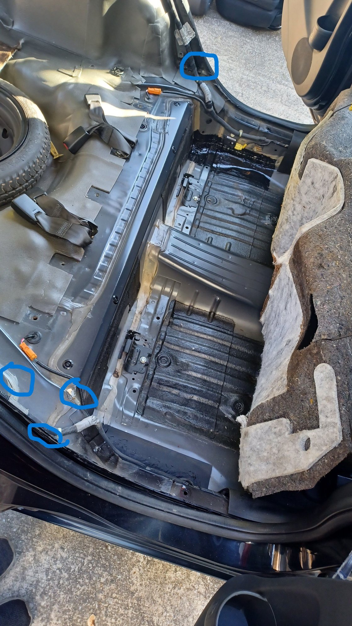

5) Rear seat belt bolt seems, shelf seams and wheel well
Found these while sound deadening the inside of the car. The rear seat belt bolt mount, I found some rust on the other side where the panels meet when I was in the rear tire well. Water came through the seam sealer and caused some rust inside. The wheel well seam was small and was from water getting kicked around in the rear wheel well. The shelf seam is the oddball but it occurred on both sides so it wasn't a fluke (i forgot to circle the other side in the pic)

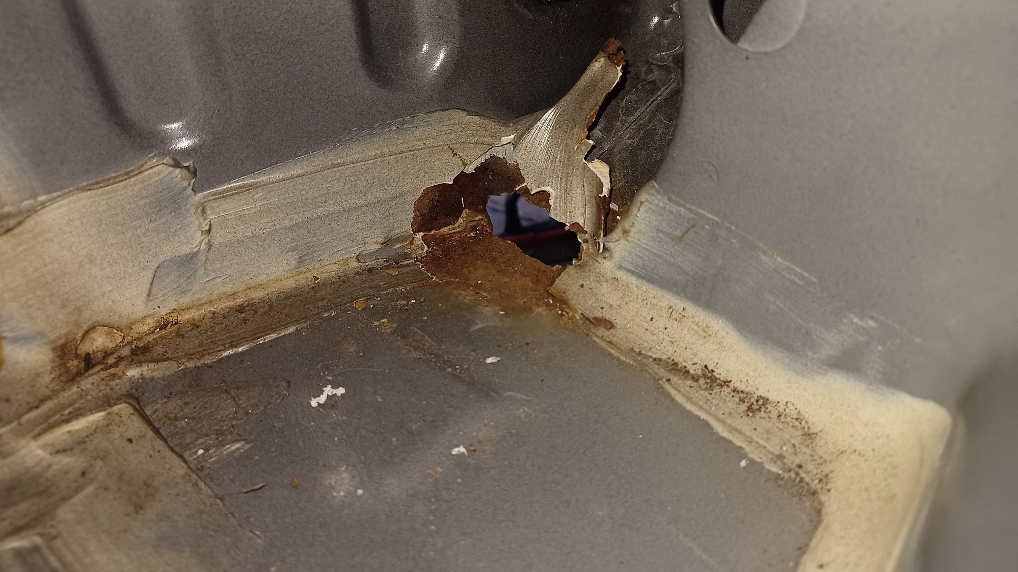

6) Rear seat floor are
In the above pic you may have noticed the black paint on the floor. Below you can see what I found after poking around with a screwdriver. Both sides of the floor were like this. Had to cut the metal out and weld in new pieces.

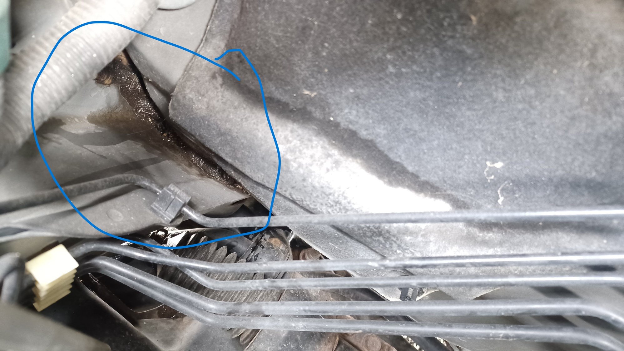

8) Front passenger foot well
This area needs more study. I have seen reports on other forums of rust and water getting into the passenger foot well and I suspect this is one of the entry point. The water may be traveling from the roof, under the windshield and to here. Where eventually the seam sealer fails (like it has everywhere else) and lets water in. Water could also be from the passenger tire as that area has a lot of holes in the sheet metal

To be honest, I've never seen a hatchback or SUV over maybe 5 years old in the salty Midwest or Northeast where the rear crash bumper (the metal under the plastic you see from the outside) isn't rusting, often considerably. This area catches all the mist, salt, and debris thrown up by the rear tires. My dad bought a 4 year old Chevy Equinox in Missouri and when he removed the plastic bumper cover to install a hitch receiver he found that the rear crash bumper was basically red dust.
