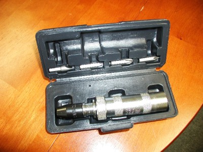

Pads look new, but if you plan on changing out yourself be sure to get a hand held impact with a #3 philips bit to remove the screws!! and a 5 lb. hammer. If you try to just use a regular screw driver the heads may break off ( and Yes ya need them ). What this thing does is "jar" the rusted threads loose and after a couple of good blows they turn out the rest of the way as easy as butter.
$16.50 on Ebay with shipping!! It's called a "hand impact".
