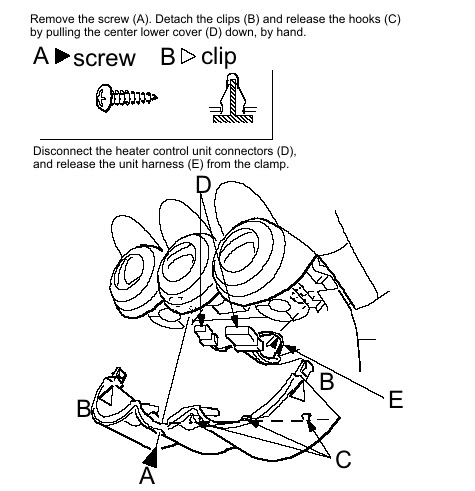

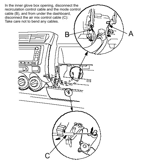

Don't know if this might help you but this is how we remove the center console for the Philippine Jazz. HTH

Pull the radio out using FITTOGO's instructions and the faceplate does come off. Be aware that Bolt 2 can be a royal pain in the ass to get to and get out. I'd have to go look at the spare HU I have in the shop, but it should be fairly simple to take the top off and get at the coins.
As it happens, I have a stock head unit (minus the faceplate) in the shop that does work.
