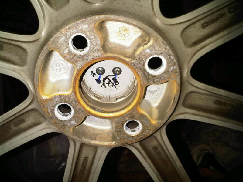

I want to put some spacers on my HFP wheels. Just the back. 15mm is fine i just want to make it more flush with the rear fender.
Im in class just want to make sure that the back of the HFP wheel has room for the studs to sit behind rite? Does anyone have a picture of the back of an HFP wheel? Also is anyone running spacers with these pictures would be a huge help! Thanks!

These spacers work differently. They go over your old studs and have new ones on them. That's why you need room behind the wheel.
You can see more information here.
15MM Aluminum Bolt-On Wheel Spacers
And after class I will measure the gap i think 15mm shouldnt rub

Not too sure man. i know there's a little space between the holes. I'll check tonight. They are just sitting in my garage -.-

You've 2 type of spacers. The one that slide over the oem studs. Those the max thickness you can run is 5mm so you've enough thread left on the studs to tighten your wheel nuts. The second type bolt up to the oem studs and have new studs pressed into them to mount your wheels. If you don't get the second type in a thick enough thickness then the oem studs will protrude past the spacers. That's when you need the spaces in the back of the wheels to clear the oem studs. If you want the 15mm spacing then go for the second type(i.e. bolt on spacers).

Confirmed, you can use those spacers.

thank you very much blue cell. I just need to measure and make sure 15mm wont rub..
