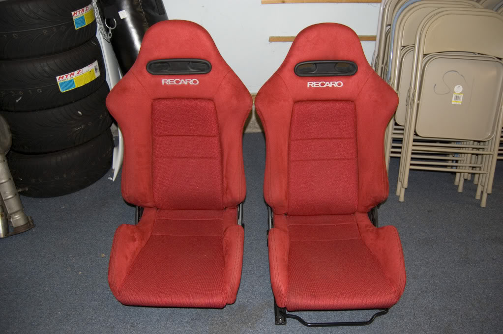

MNfit's Avatar
Posts: 3,380
ok cool thanks
here is a pic of the seats im looking at picking up, he is asking $900
Old Jun 23, 2010 | 04:19 PM
grtpumpkin's Avatar
Posts: 1,616
From: inwood WV
Not a terrible price! And they appear to be well cared for. The black ones I found on E-bay yesterday are obviously well worn, and I think still more money! I would rock them, but i have a family to think of first (not that you don't of course LOL)
Old Jun 23, 2010 | 08:17 PM
Type 100's Avatar
Posts: 1,888
Darn, can't see the photos from my workplace. Will check 'em out later. Good price though for the seats, I agree.
