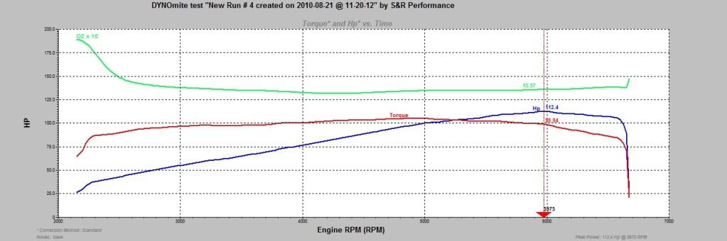

i made 112whp on nothing but a test pipe, muffler, and intake.
these numbers are not common apparently, but altogether I think I've spent 300 dollars on parts, got them all used. Wait for good deals and do the most basic bolt ons. Doesn't hurt to try.

those numbers are not bad, did you get a baseline number before the upgrades?

i never did a baseline unfortunately, never really planned on doing much perfiormance wise to the car because i have a project DA as well.
at least i have a baseline for NA vs boost now though...if i ever get around to it.

5speedwonder for example, has brought the power to the ground up from the low-mid 90s up a full 20whp with only a couple exhaust mods and new intake pipe. That should tell you how restricted this car is. We are talking about ~20% gain on a 1.5l with $300 in bolt-ons, which is phenomenal.
