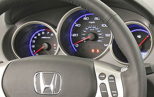

In the US, we do not have the CVT transmission that you have. Ours are either a manual transmission or a regular automatic transmission. As a result, there is no switch to make a CVT act like it has gears. On the Automatic transmission, Sport model, there are the paddle shifters to make our AT shift more like a MT.
We can either move the gearshift from D to S, and the paddles are always in control (unless the computer decides that damage might occur from over revving the engine or the car is moving too slowly for the engine's minimum speed), or we can just leave the shifter in D and use the paddles. If we leave it in D, the computer takes back regular transmission control in a few seconds after the last paddle is pulled.
Hope this helps!
This pic shows the right side paddle shifter poking up above the wheel (look for the silver circle with a + just where the silver meets the black leather) and also a is a good up close view of the cruise control buttons.
http://media.ed.edmunds-media.com/pi...20144380-E.jpg

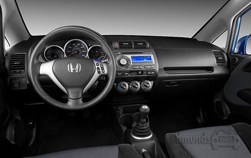

Here's a good overall picture: http://media.ed.edmunds-media.com/pi...20234923-E.jpg

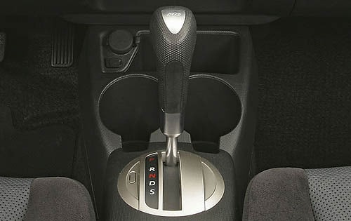

And one of the gear selector: http://media.ed.edmunds-media.com/pi...20144381-E.jpg

Now it is clear that the American version of Honda Fit is no such button, which is on the European version.
Then another 2 issue of the lower-left control button Cruise control:
1. When you click on the top of the button includes a function, but when pressed on the bottom part of the turn is another function?
2. What controls the functions of the lower left control button cruise control?
