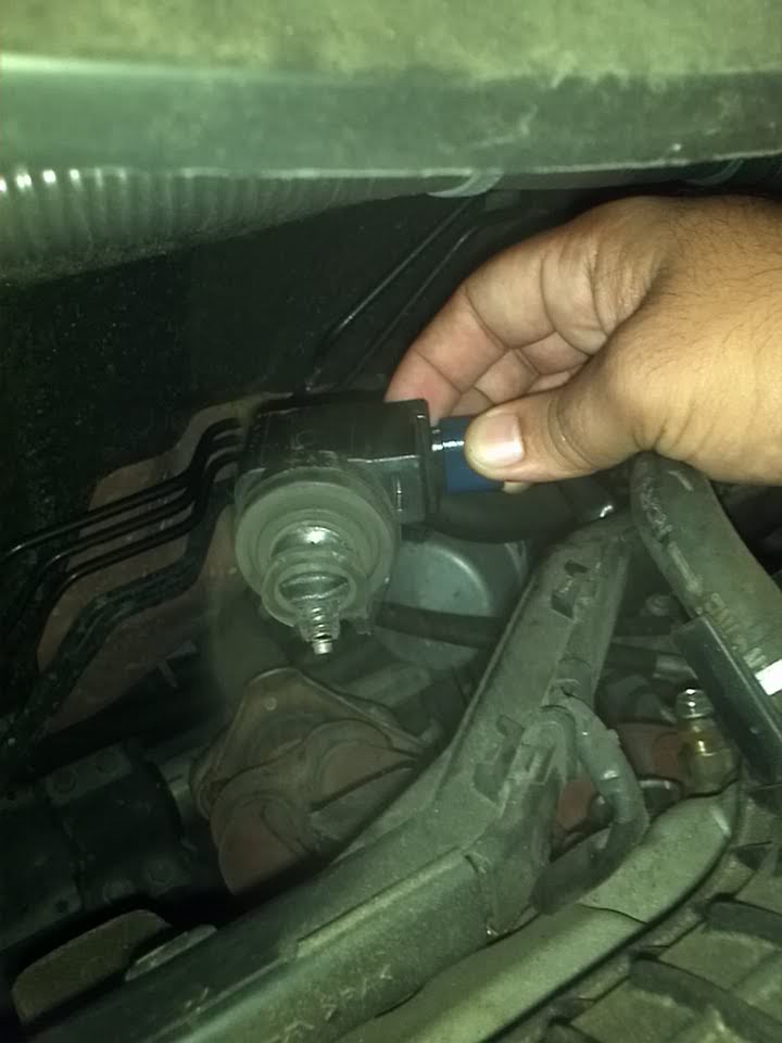

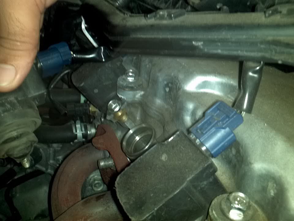

Hey mornin everyone im having some trouble with my old girl here my dad was driving her for a while I was planning to take her back since i didnt really need a car while in school but the other day while driving he said he heard a pop and the car started sounding like a jet engine. At first I thought it was an exhaust leak something to do with the stock headers after I put them back in i really feel like I didnt do a good job a year back but she ran since. I have some pics of the problem any suggestions would be great thanks.

did it blow out a spark plug? Or wait did the coil pack break?

yea coil C looks like it blew off while they where on the highway. So is the rest of it still in there? or did it desintergrate lol? I was going to try and take it to the shop but could I just buy a new coil and pop it in there or do I have to break it down see whats going on inside?

what do you mean by jet engine sound? did it continue to drive without coil c?

yea they made it home alright and i turned it on to move it this morning so I can take a better look at it. When they told me it sounded like a jet I thought it was something with the exhaust but when I looked by the headers thats when I saw it just dangling off

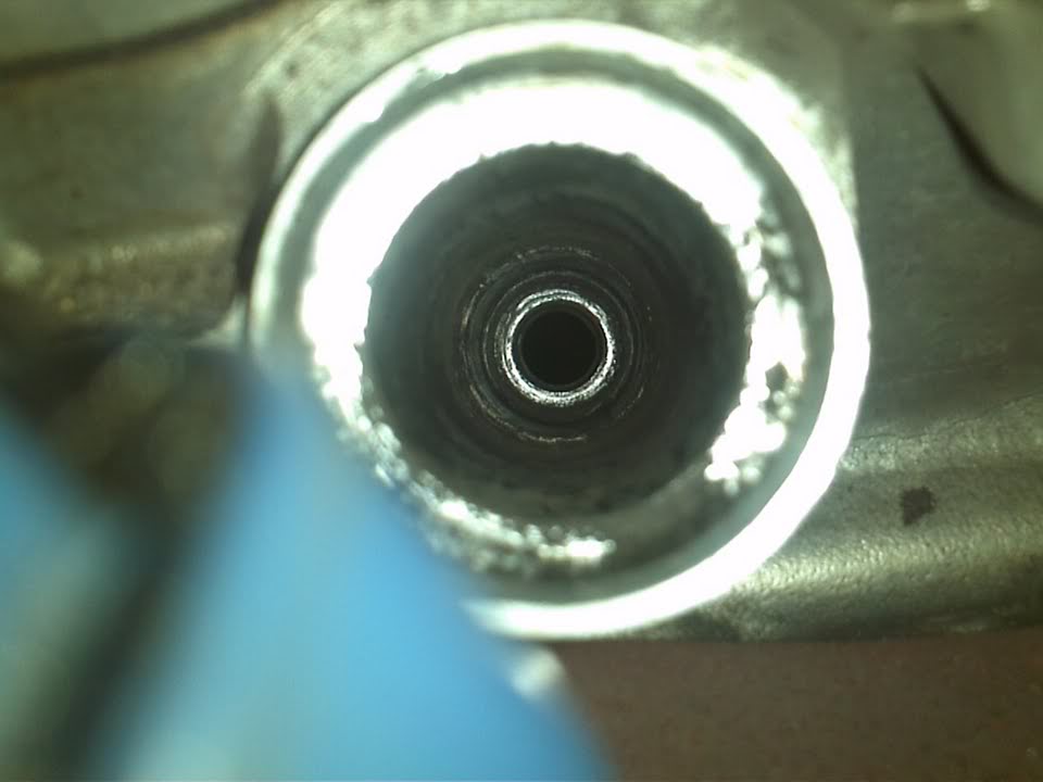

this is a pic inside. I dont see any pieces of the coil in there but i can't tell if their is a spark plug in there or not. I tried one of the other spark plugs and i can get it in there but it will not tigthen in like something is in the way or as if there was no thread. Help please

Tap it out 1st using a shop vac to help suckup any shavings. As you said it was driven so it sounds like your ok in the cylinder. install a new set of plugs and a ciol pack & you should be good2go. Check the rest of the plugs i've heard of this b4 here when a plug loosens up and flys out!

I am wondering if the same thing happen to mines. But I think the spark plug or a piece is still in there melted or broken because I cant pull anything out with the socket and I cant put in another spark plug. man I really want this car back lol I hope she will be alright. I will try to clean it out with a vaccumm see if anything comes out. Thanks Perrenoud

nothing seems to want to come out blah I think ima have to dish out some cash to the stealership because I cant seem to figure out if the sprk plug is still in. Since my parents drove the car like 10 miles after it happened could the spark plug have melted or just blown off as well? I know the pic isnt very well but it does look like something is on the walls.

Is it possible for a spark plug to split in two? The threaded portion of the body vs everything else? Maybe they were overtightened and that separated the two parts, leaving the threaded portion stuck in there.

Looks to me like that plug is long gone. And the reason you can't get another one to thread in is the same reaon the OE went bye-bye in the first place. The threads have been ripped out of the head. Had you replaced the spark plugs yourself at some point in the past?

Tapping the threads with the head on the engine is... well, foolish at best. It sucks to do, but you need to pull the head OFF the block so that NO cuttings fall down into the cylinder. Even microscopic pieces that fall in can end up causing cylinder wall scoring or ring damage - meaning an even bigger job down the road a few months.
If you've never messed with the plugs, then this should fall under the powertrain warranty - at least look into it before doing any work yourself.
This is a significant amount of work, especially if the head is completely stripped - either the head will need replacement or a good machine shop can repair yours.

A plug blowing out more than likely would be due to it being over torqued when installed... The idea that an overly oiled air cleaner would be the cause is pure chicken shit... The air cleaner oil if very excessive would bring down the octane of the air/fuel mixture but the ECU would of pulled back the timing enough to correct for that if that was the case unless there was also very contaminated low octane fuel in the tank as well... I use an oiled K&N type filter, I'm guessing about twice the wheel horsepower of what my car originally came with with 38000 miles on my car, 16000 with a supercharger and have had no problems.... The only way that I have ever seen a plug blow out taking all if the threads with them has been from some one over tightening the plug... It was pretty common on old air cooled VW engines back in the days that almost all cars had cast iron heads.
