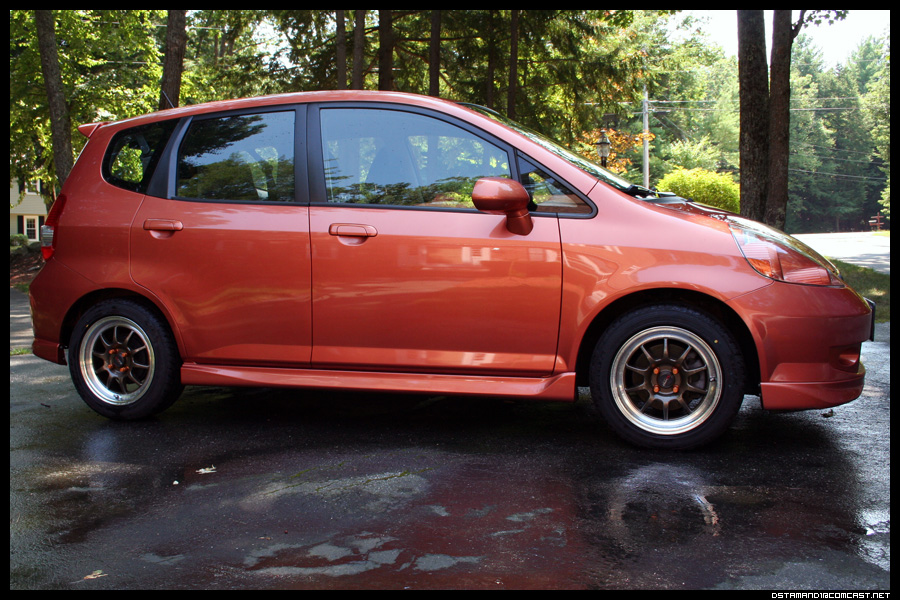

Hello all,
I joined up because I am a somewhat new owner of a 2008 Fit Sport, and I need a little help.
I plan on getting my Fit lowered over the weekend using a set of Tein S-tech springs (on stock strut). I've been digging up information on the rubber bump stops, and trying to figure out whether or not they need to be cut etc. At first I was finding 1" to 1.2" to be cut from the short end (easy enough), but the Tein manual states otherwise...
According to the manual that came with my springs, I am to reinstall the stops with NO modification. The table that they show, which lists all the makes/models, shows no data for the Fit GD3... therefore (according to the note at the bottom) the bump stops do not need to be cut.
So now, I don't know what to tell my mechanic when we get this done and I'd rather not be wrong. I think the springs I have will lower the car 1.5" or so; I am not sure what to go with. Seems like a LOT of people are suggesting that I cut them, but the manual says not to. I'm guessing this varies across spring brands but I can't find any conclusive data. Ugh.
Anyway, thanks in advance for any info and I appreciate the help.
