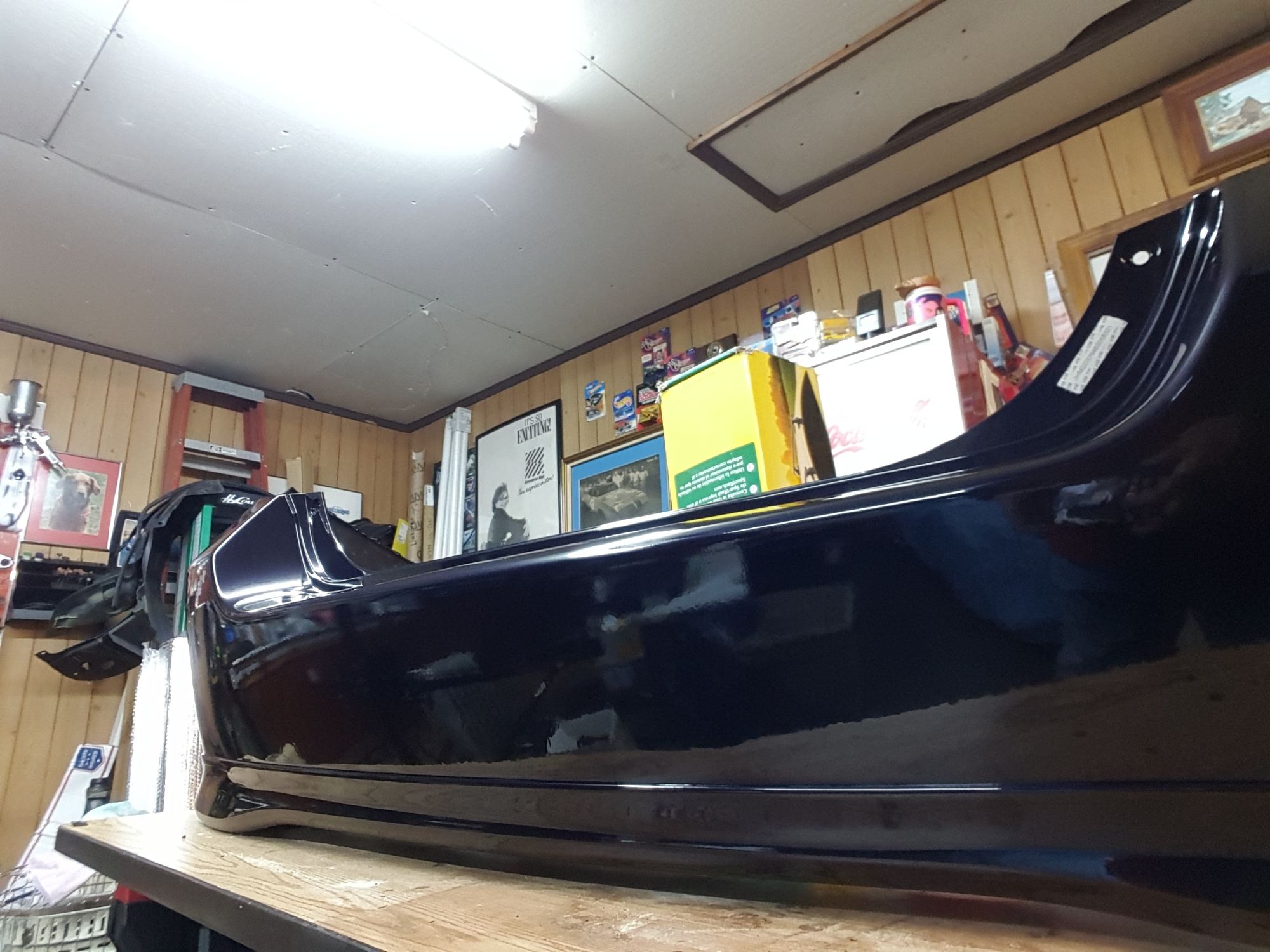

Attached Thumbnails BPM 2008 5 spd.-80-20151228_201653_c3a65e32caa22a433c423a067946394bbf7409eb.jpg

Above is the finished bumper and I re-installed it yesterday. It looks even better back on the Fit! ha ha. The lil thing is a great car took it over to the inspection shop and had an up close and personal under side inspection. And it looks great under there! very happy. The DS caliper is tight not locked up but have a rebuild kit at Advanced Auto & ill install tomorrow, and that will be the last issue with this car. Then it's off to Great Bridge at the bank parking lot with a for sale sign. This is my first car I have bought by myself to re-sell and am actually doing that! not keeping this one.
