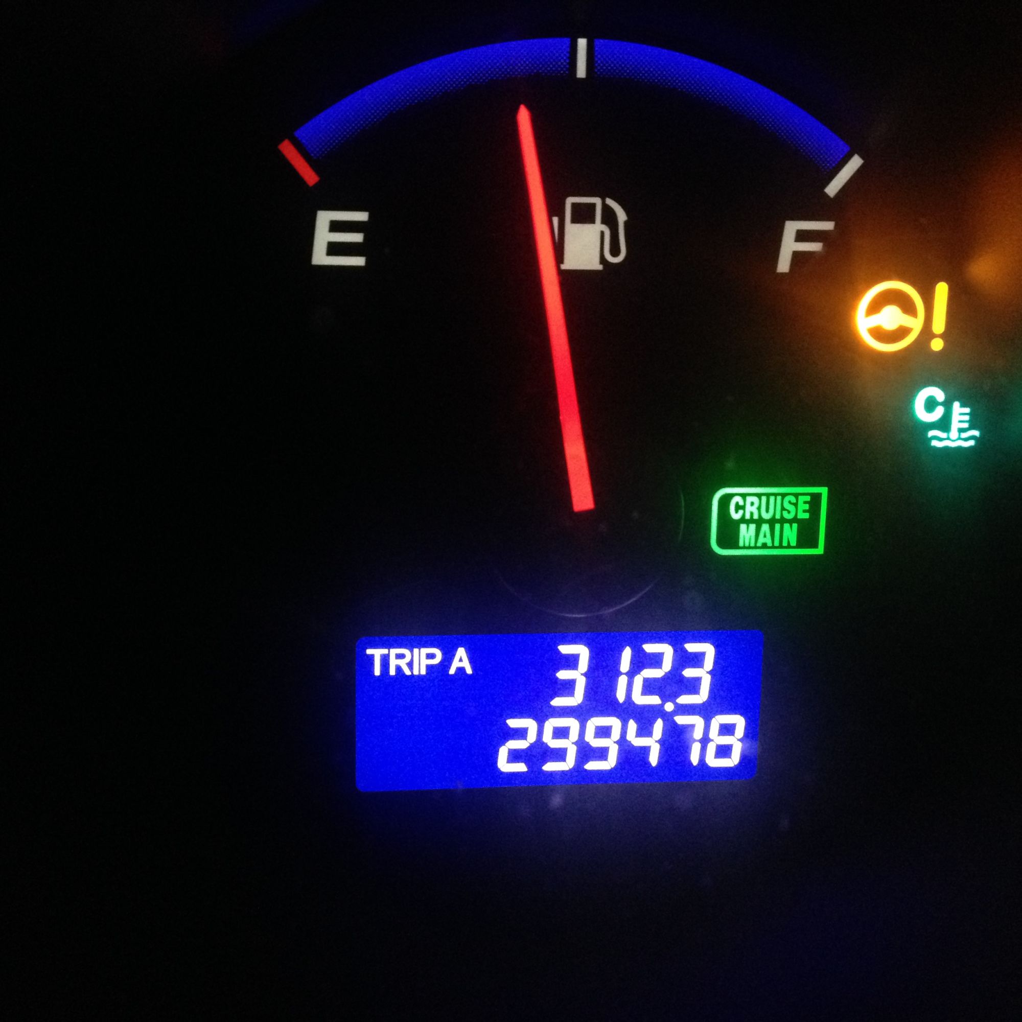

Still going strong...
fifit, I've owned my '07 GD3 5AT since April 28, 2006. So far, it's continued to be a good addition to our family fleet of Hondas. We also have a 2000 Odyssey, 1983 Interceptor and 2006 Civic.
Other than normal wear items, I've had to replace 2 coilpacks. 1 radiator fan, and 1 A/C compressor, I feel that this car has been very reliable for a 10 year old with 299,478 miles on it.
I try not to abuse my rides, but I don't exactly treat this Fit like a baby. I paddle shift this car daily with 4K rpm, or greater shift points. If the need arises, I will occasionally shift at 7,000 to 7,200 rpm (as I have reset the rev limit to 7,500 rpm, via Hondata FlashPro). I did Autox this car one season, and had no issues other than wearing out tires and brakes at an alarmingly expensive rate.
I do try to somewhat follow Honda's recommended maintenance schedule as a guideline. I change the oil at least once a year, using Amsoil lube. I've changed the ATF 3X so far. The valve lash has been adjusted twice. 4 sets of Denso IK22 plugs. Replaced the brake fluid once.
I presently average about 34.5+ mpg. I can get an occasional 36-37mpg tank average when the driving conditions are in my favor. It burns maybe a quart of oil every 10K or so.
I live in Central California, so I don't have any experience with rust issues. That may be a concern if the Fit you are buying has been subjected to a lot of road salt.
Hopefully, if you find a GD3 that has been taken care of as well, or better than mine, you will know that it will "last" at least 299,478 miles!
Attached Thumbnails Buying used high mileage 2007-08 Fit-80-299478_odometer_9972eeba56b34673d9db332f7929ecfbcbdcc3a0.jpg
