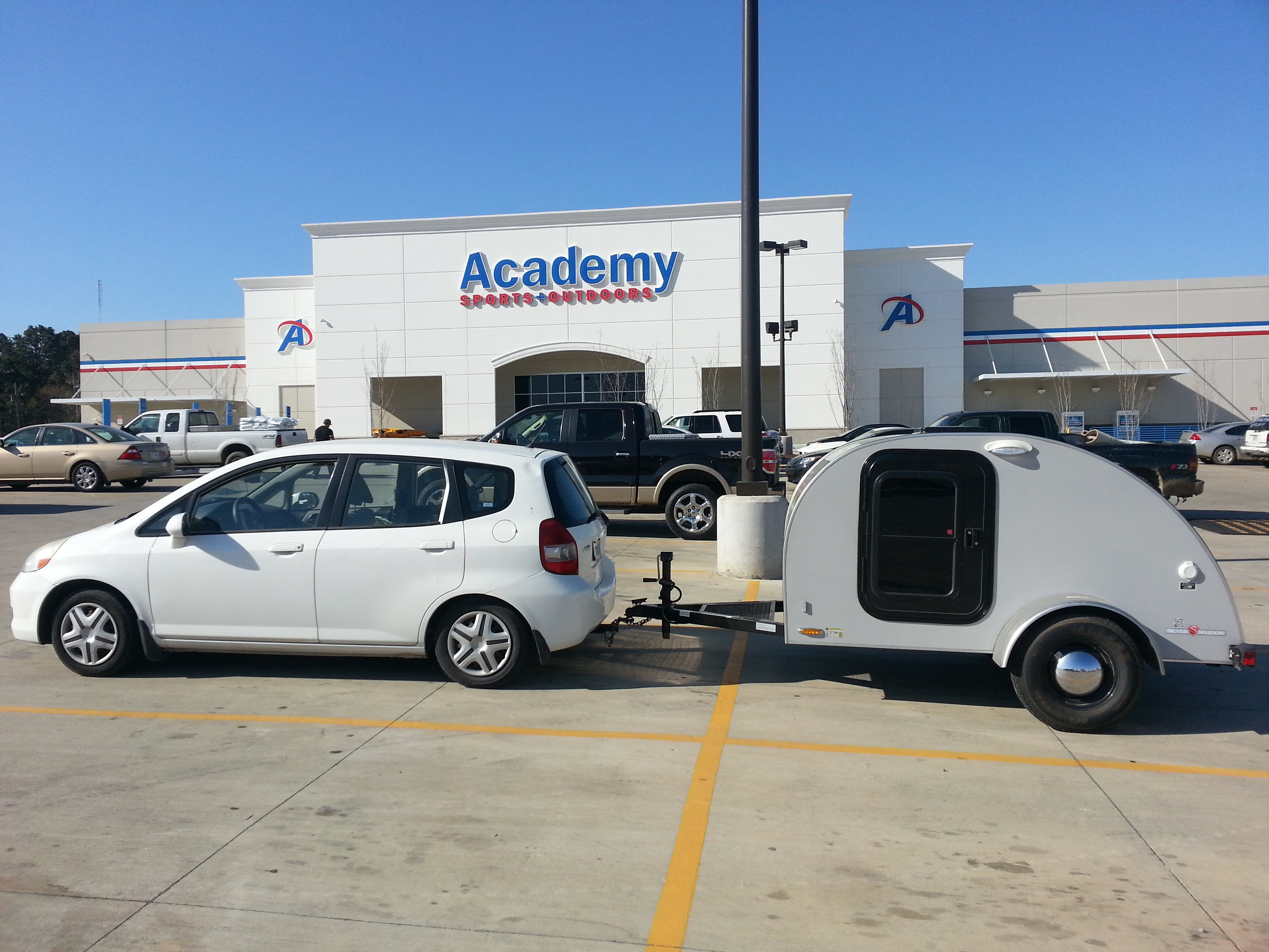

I've been towing a Harbor Freight utility trailer around for some time now with my 2007 Honda Fit. Haven't had any issues whatsoever with handling although I've taken care to distribute the weight evenly to maintain tongue weight.
I recently decided to buy a small teardrop camper (850lbs) for a roadtrip this summer with the '07 Fit. I've noticed that the rear sags just a bit with no cargo on the camper. I can probably alleviate that a little bit once I have a loaded cooler, spare tire, etc, loaded up in the back of the camper. However, the trailer wheel is far enough back I don't think I'll be able to completely compensate for the slight sag.
A friend of mine who had a similar situation with a small SUV recommended air bag suspension inserts in the rear. I've looked and I only see these made for 2010 and later Fits, although I suspect they'd fit a first generation.
Wanted to ask if anyone else had installed these Firestone Coil-Rite air bags or seen them installed? 2010-2012 Honda Fit, Insight - Firestone Coil-Rite Air Bag Helper Springs [REAR] [4183] | $104.65 | SD Truck Springs | Leaf Springs, Helper Springs and Suspension Parts

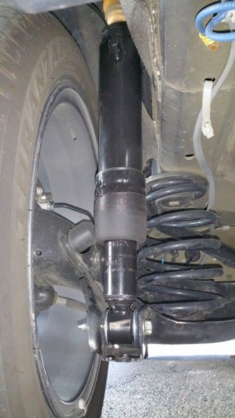

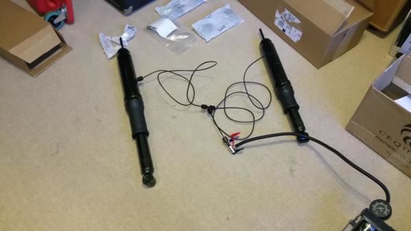

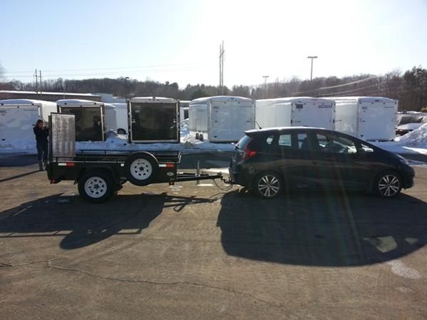

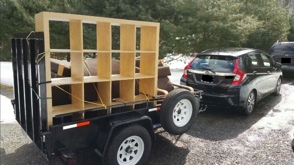

Highly recommend the air shocks over the air bags inside the springs. I too have an 875lb utility trailer empty. Without the air shocks the rear squats too low for my liking. I put 50 psi in the shocks and that keeps it at normal ride height with a max 200lb tongue weight.

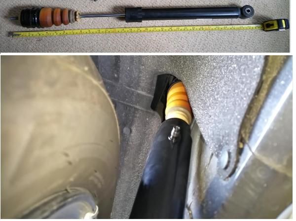

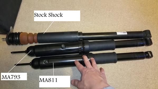

It makes the ride more "spongy" yes. The air bags only stiffen the springs, they dont provide any vertical lift with a heavy load. The air shocks do.
I have the Monroe MA811 with some small modification extending the upper stem mount with some 3/8" threaded rod. Bottom mounts accept the stock 10mm diameter bolt thats 73mm long with fine thread, but you need to use the washers it comes with, and reuse the oem upper bump stop, seals, and spacers. All detailed in my thread.
All told, if i had to do it over again knowing how to do them with the mods, two hours at most.
