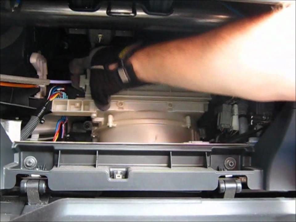

There's no mention of having to disconnect anything but the airbag connector in the FSM/ESI, and if you flop open the glovebox the airbag fasteners (3 nuts) should be unobstructed.
Disconnect airbag connector, remove 3 nuts, pry the unit up and out of the dash.
Oh yeah, disconnect the battery first and wait 3 minutes
I don't have my GFs car to look at right now, but I can see the bottom of the airbag mounting bracket in this googled pic, looks like there is nothing is in the way to me..
https://i.ytimg.com/vi/RfIVvWYO6wY/maxresdefault.jpg

It's a pretty straightforward remove and install of the airbag unit.
