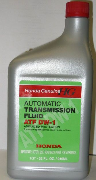

Old Jun 22, 2016 | 01:51 PM
ezone's Avatar
Joined: Sep 2015
Posts: 1,128
From: Digging in your fridge
The mechanic just told me that H-1 is a Honda product and is the correct fluid for my car.
Call any Honda dealership parts department and ask for this H-1 fluid.
I'm pretty sure you won't be able to find any H-1 fluid at any Honda dealership.
The closest letters anyone will mention is the old Z-1, if anyone has been there long enough to remember it.
I've never heard of H-1 ATF, and there is nothing on our shelves with those letters.
'Nuff said?
EDIT: Maybe they are just calling it by the wrong name. Do their bottles say Honda on them?
