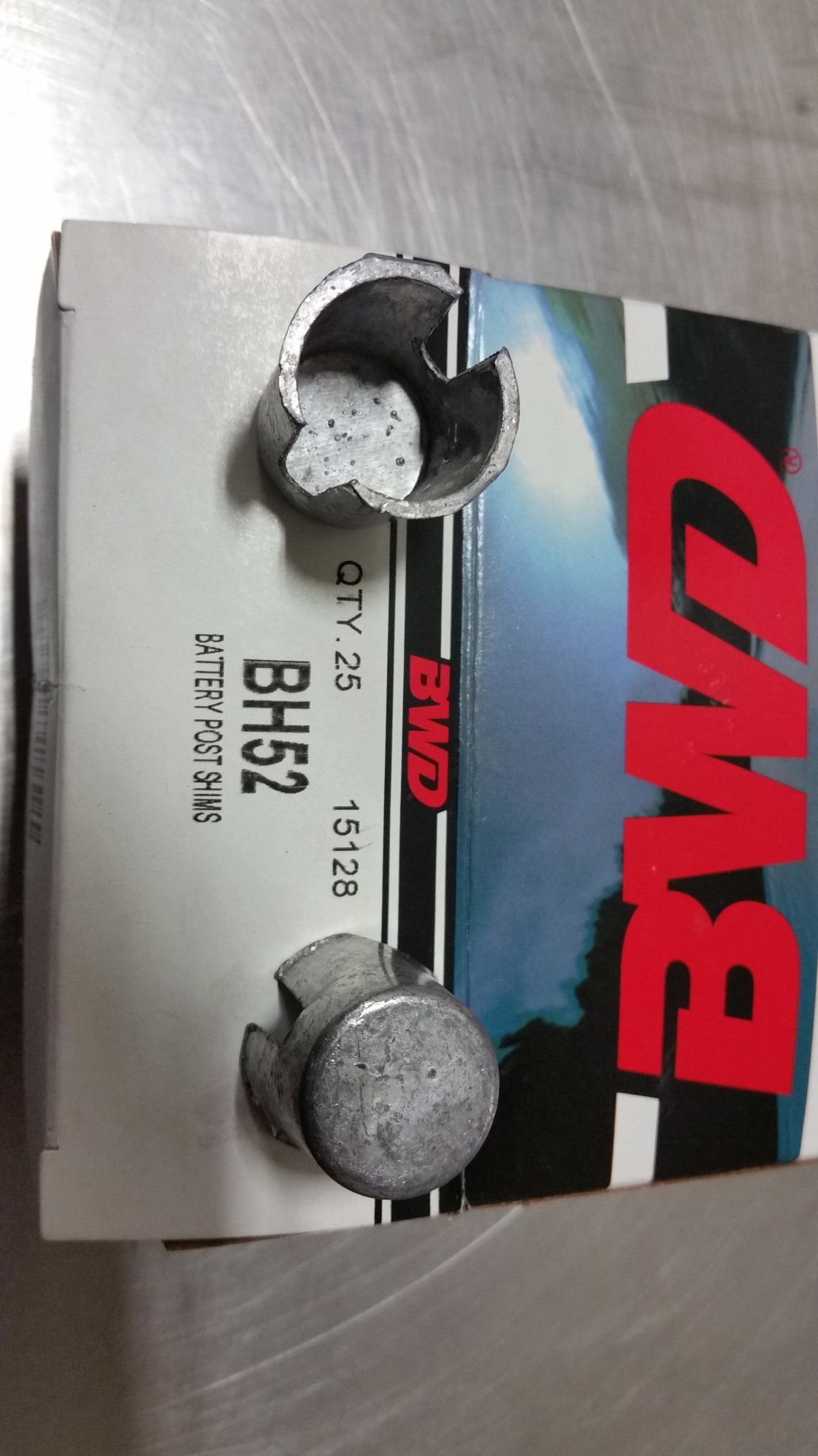

Looks like Honda makes you buy the positive cable.
We keep a supply these post shims at the shop just as a super cheap fix for stretched and deformed original cable clamps.
Tap to seat one in place over the post, loosen the clamp as far as the bolt will allow, install cable clamp as far down as possible. Tighten and go.
As long as the clamps are not broken, these have worked well for us.
I'm sure many parts stores will have some of these, I got a shot of the brand and its part number for you.

Been using a piece of house wire for a shim for years. Never an issue.

^^What e' says. Those shims are your best alternative to replacing the clamp with an OEM part. Easy, too. Just my opinion, of course.

I have needed to shim the battery terminals on both our Hondas.
You can buy the ones that ezone pictured, or make your own from one or two thicknesses of aluminum beer can. When I make the shims myself, the aluminum only goes halfway around the terminal...that way the original terminal provides the majority of the contact area.
