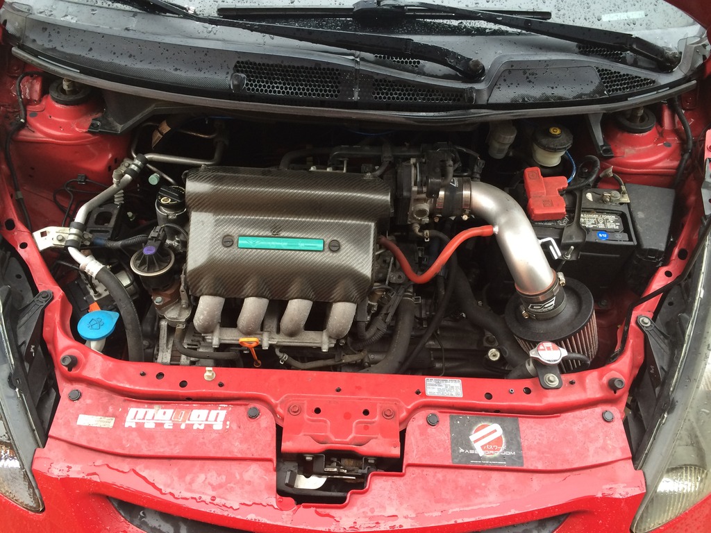

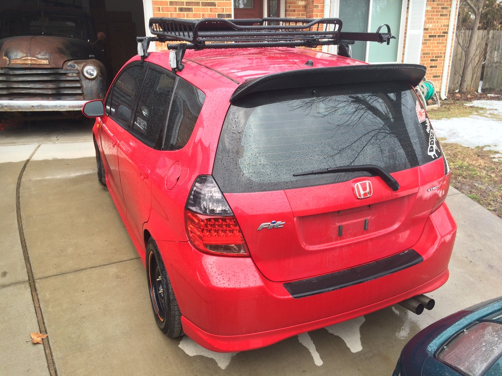

So it has been a long time since I built a car and done a build thread, but I absolutely love the GD3 chassis and have wanted to build one since I sold my first one way back in the day.
I've owned the car for a about two years now and most of the mods that have been done were me taking advantage of an opportunity to upgrade worn out components, but I also plan on making it a purpose built car that I can take to the track and have fun in.
Here is my last build before I took a leave of absence from the Honda Community:
Here is how the Fit looked the night I purchased her:

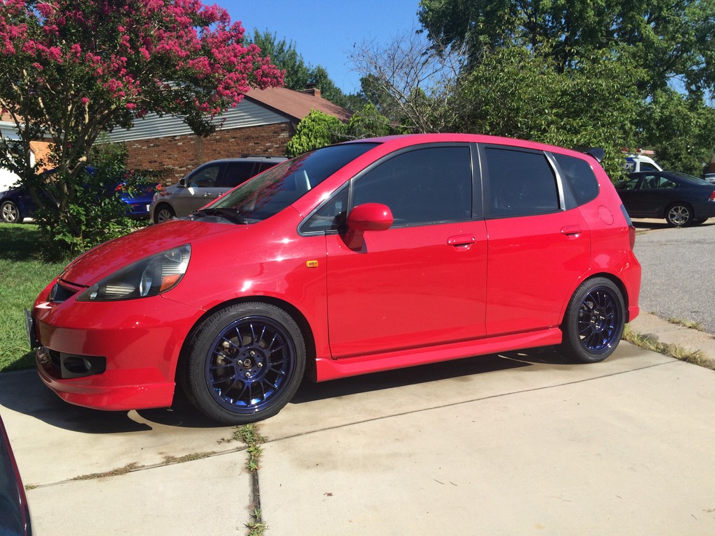

How she Currently sits now:

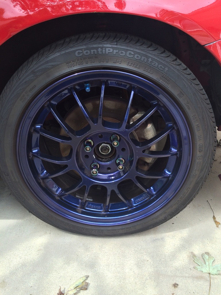

Obviously the first things to go were all the 5hp stickers lol. I ended up picking up a nail in one of my tires which was unrepairable so instead of buying new tires for 14" wheels I thought I would get a new to me set of wheels:
16x7 +35 Volk SE37's powder coated Mag Blue:
You can't have nice shoes without the proper strings:

SE37 are a great choice.
The color combo is a bit different, but I've seen worse
Welcome!

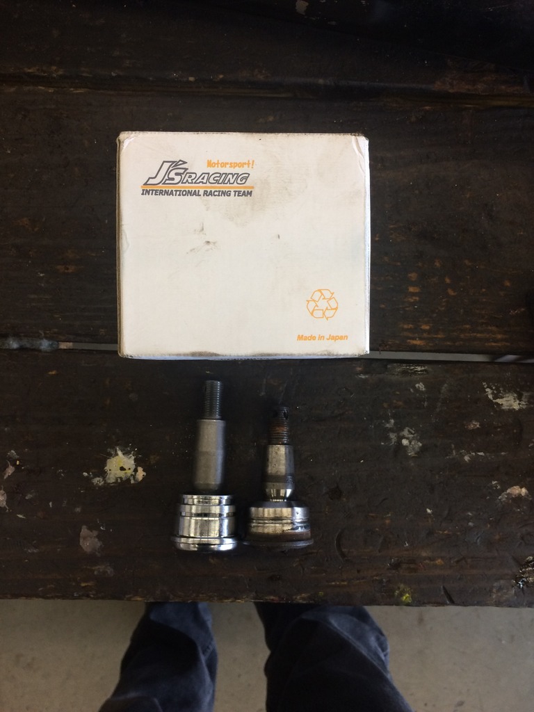

I also purchased the J's racing extended ball joints, but found out afterward that the JDM ball joint diameter is smaller than their USDM counterpart so if anybody knows how to get them to work with the USDM lca's or the JDM lca's to work on our cars that info would be great:

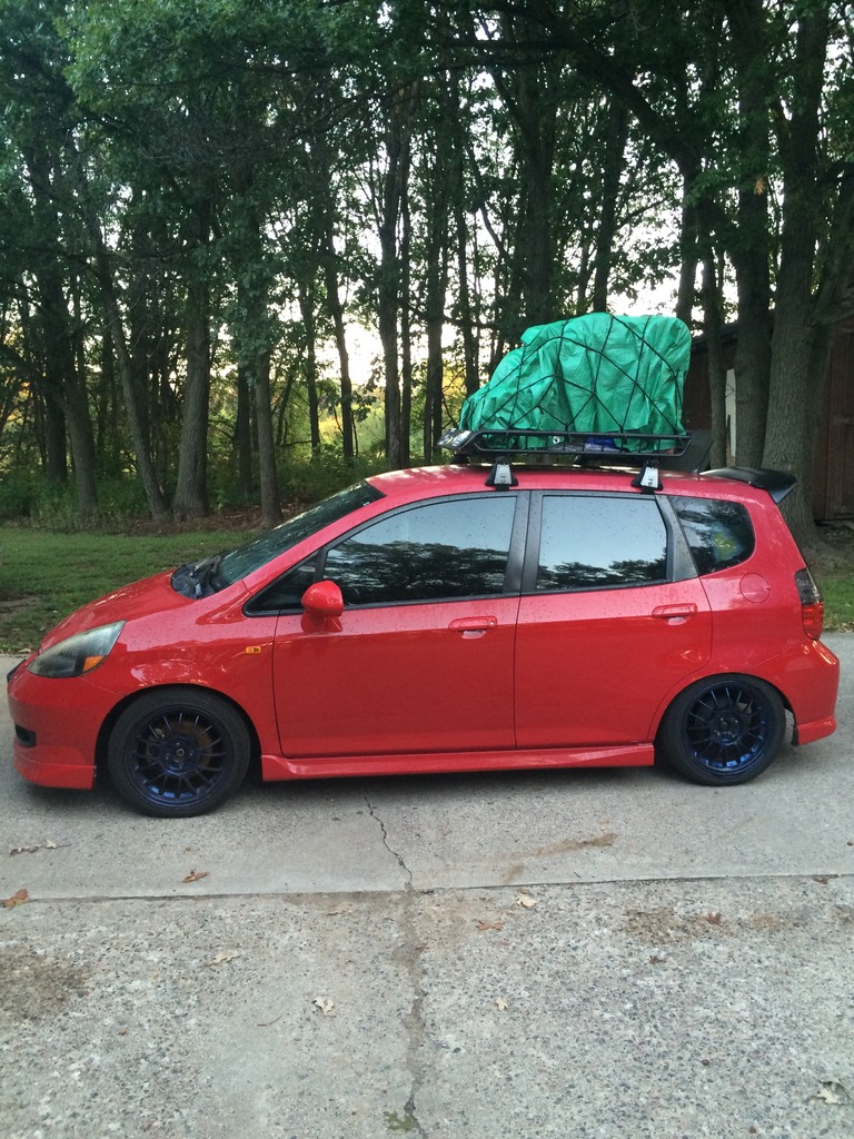

Loaded down family trip from VA to MN and back:
After that long as haul loaded down with all that cargo two adults and one baby, the Fit was definitely put through her paces. When we were getting back into the hills of VA we went from doing 75 on 95 to doing 45 with the pedal to the floor so that I when I knew it was time for a major upgrade. Which leads me to my time consuming, headache having, deployment enduring, shitty ass shop dealing almost complete situation I am in right now...

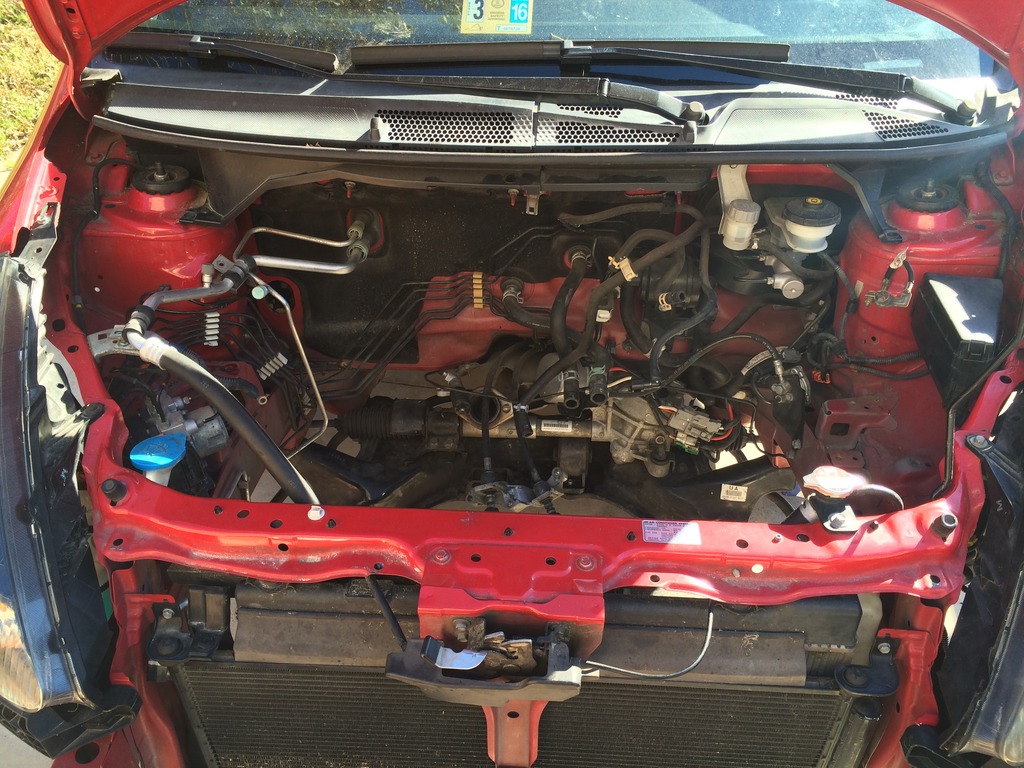

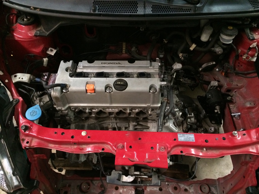

The last pic of the L15A installed in Sophia:
Empty bay:

Mike410b thanks brother! I don't mind the color combo, but some of the coating is chipping around the center cap holes so I will end up changing the color eventually.
Greg

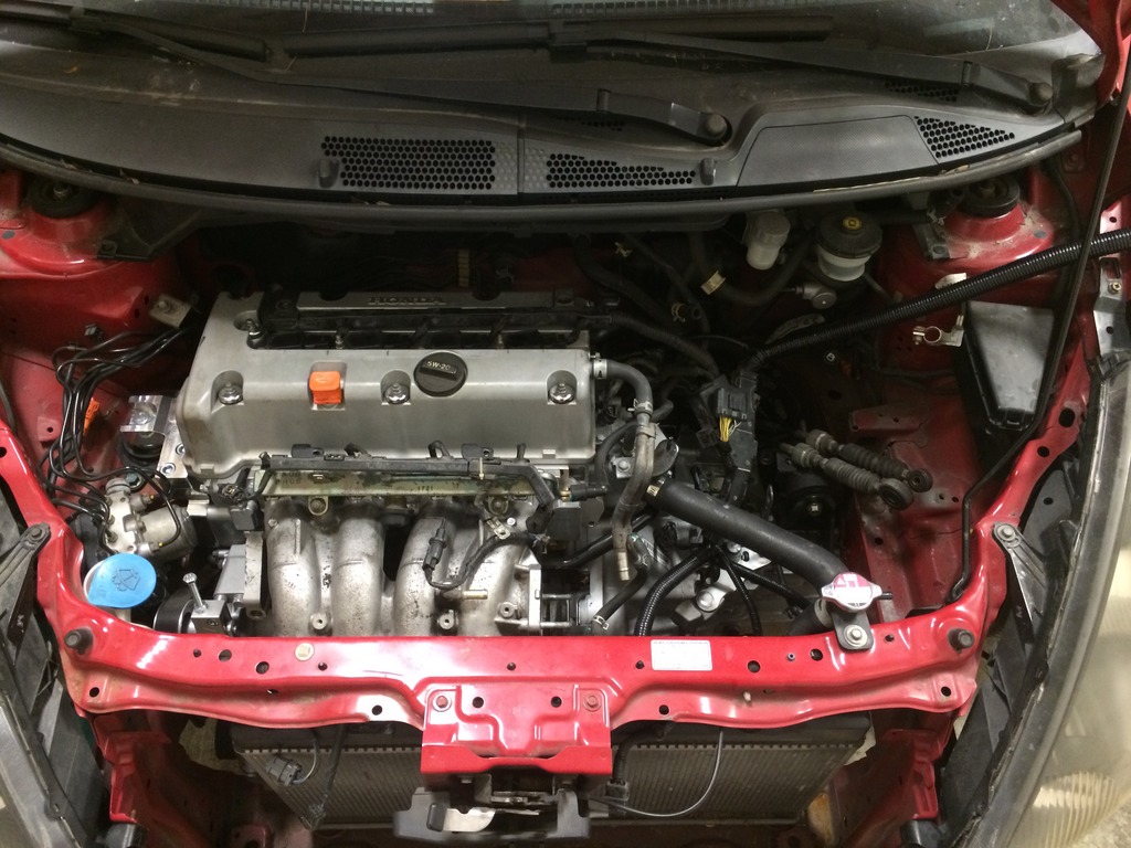

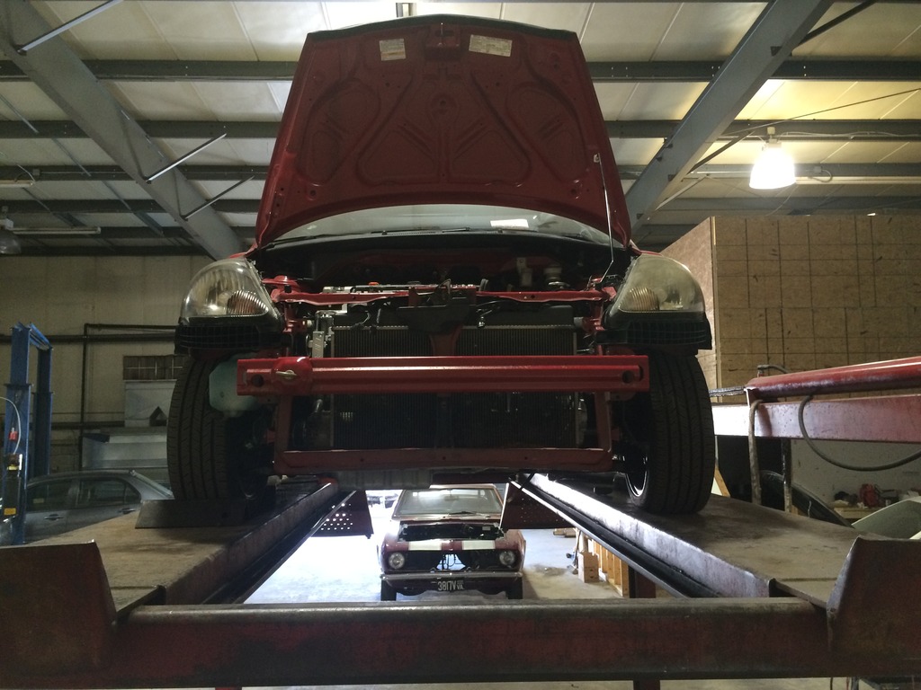

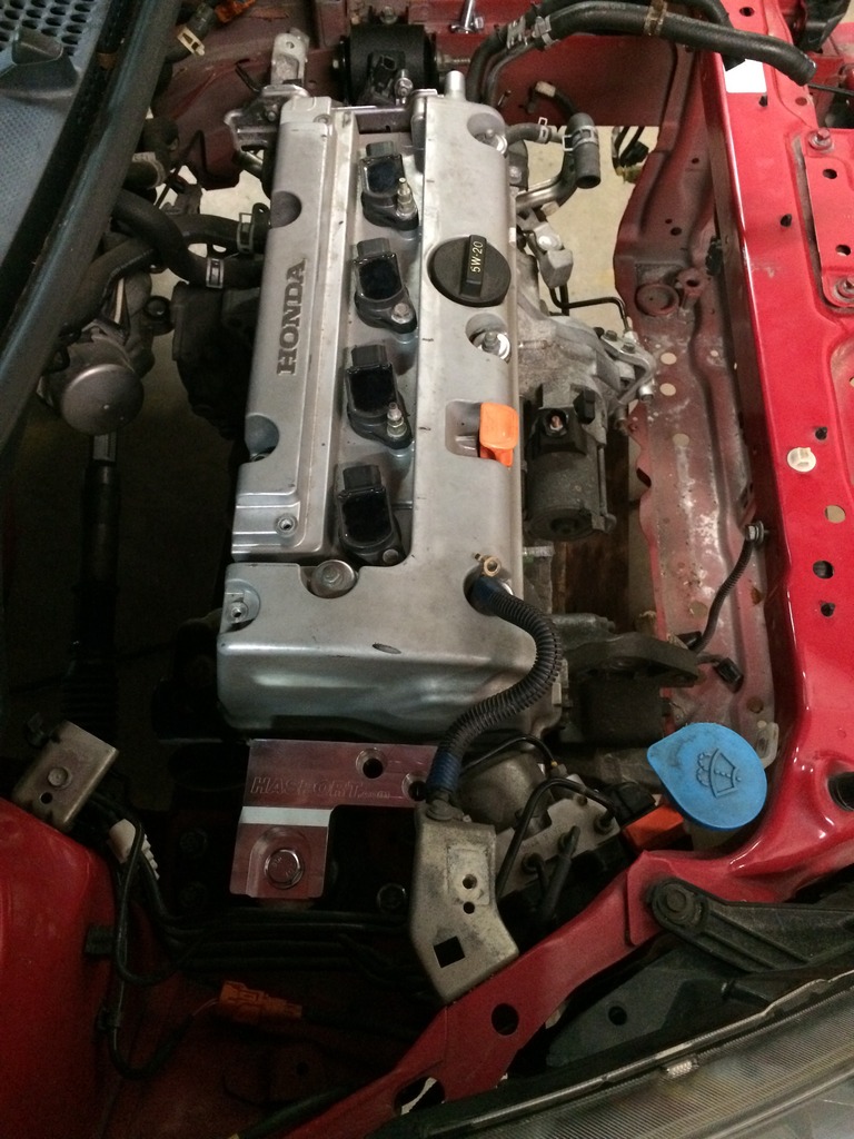

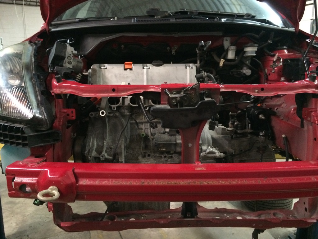

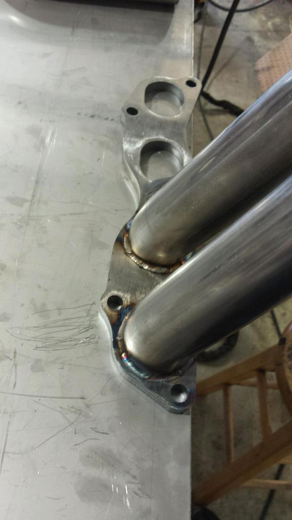

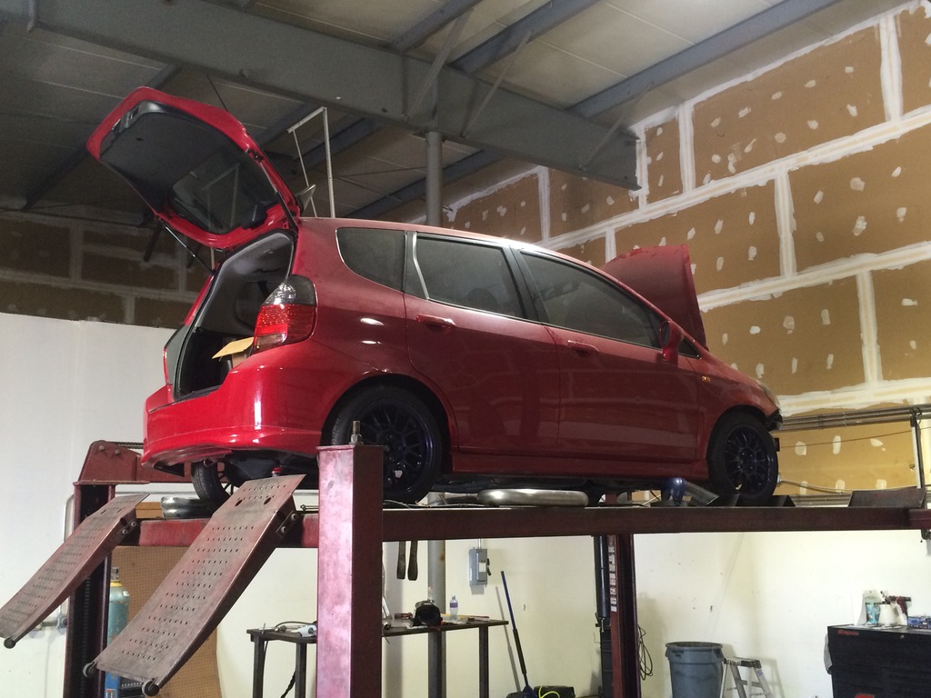

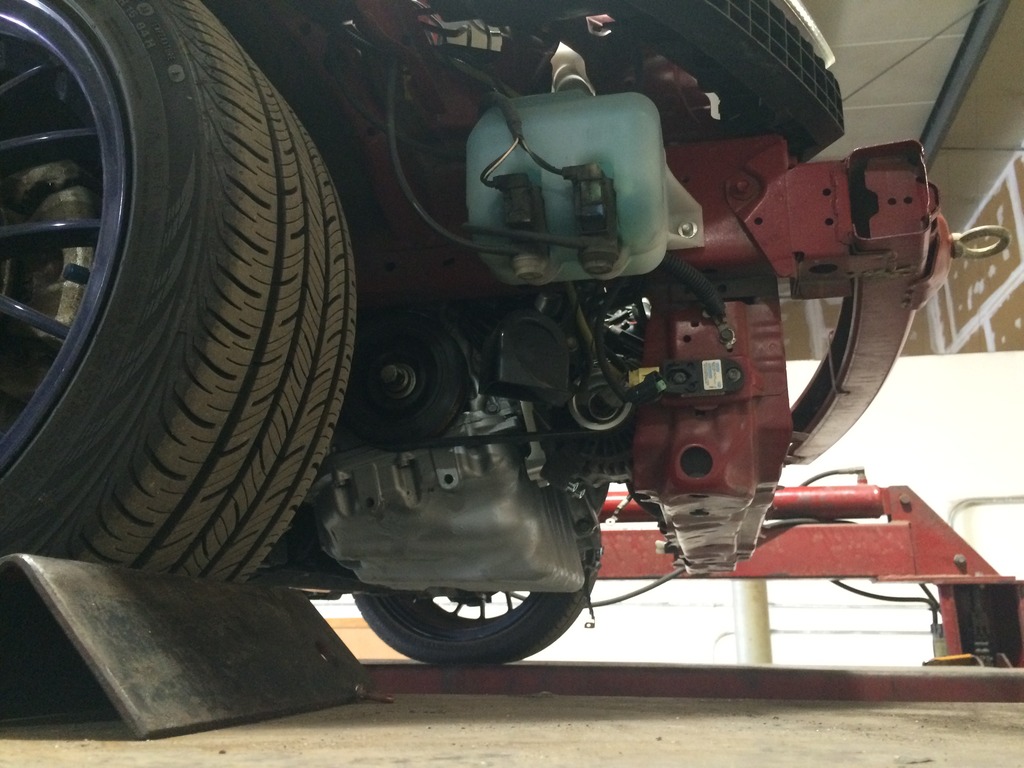

I’ve wanted to do this swap since I saw it done back in07, K20Z3 with matching trans:

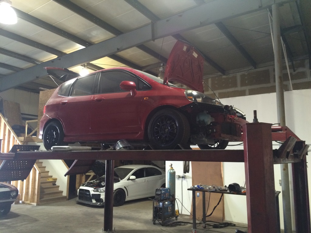

Some pics of the car on the lift:

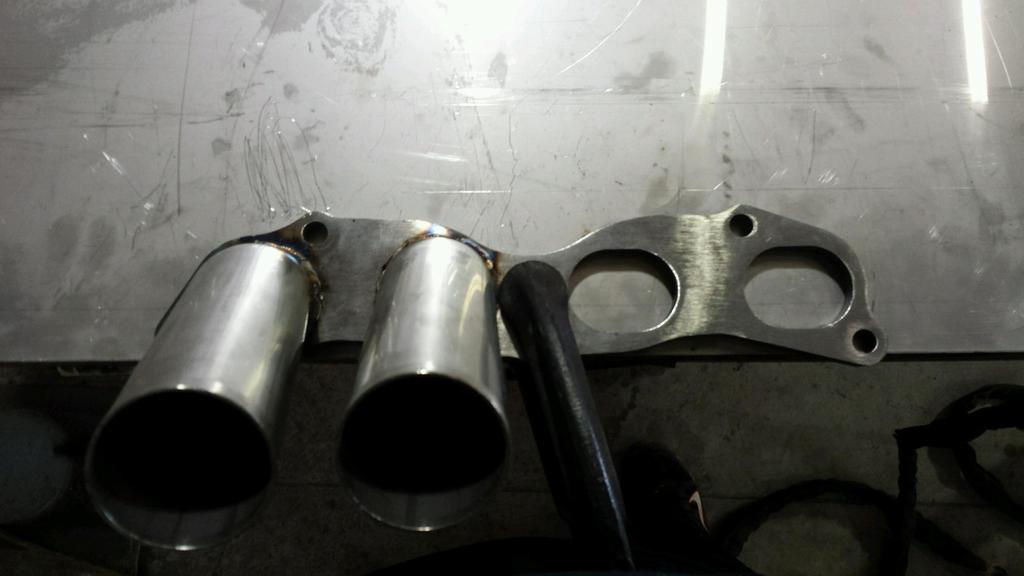

Pics of the start of the header, these are the last pics I was able to take before I deployed:
Attached Thumbnails MR. LS400's 07 MR GD3 (Sophia)-img_5153_zpsf2wqe9v2.jpg   MR. LS400's 07 MR GD3 (Sophia)-img_5154_zpshhbsixyk.jpg   MR. LS400's 07 MR GD3 (Sophia)-img_5156_zps4k4msa7b.jpg   MR. LS400's 07 MR GD3 (Sophia)-img_5259_zpsxbugbvdg.jpg   MR. LS400's 07 MR GD3 (Sophia)-img_5269_zpsxprzaaem.jpg
MR. LS400's 07 MR GD3 (Sophia)-img_5343_zps23nzbiel.jpg   MR. LS400's 07 MR GD3 (Sophia)-img_5342_zpst6gk5oli.jpg   MR. LS400's 07 MR GD3 (Sophia)-img_5341_zpsjmdnjrps.jpg   MR. LS400's 07 MR GD3 (Sophia)-img_5344_zpsosfp9ndj.jpg   MR. LS400's 07 MR GD3 (Sophia)-img_5270_zpswubiix4a.jpg

So as I was saying I went through a lot of headache and frustration with the shop that I originally went with. I will save you the trouble of reading 8 months worth of my agitation but here are a few of the things I dealt with. A complete shop relocation, multiple partner changes, multiple shop name changes a complete ownership change, and my least favorite sheer laziness. Finally after a lot of back and forth we get the call that the car is ready to be picked up. More to come on that as well, but here are a few of the things that were completed.

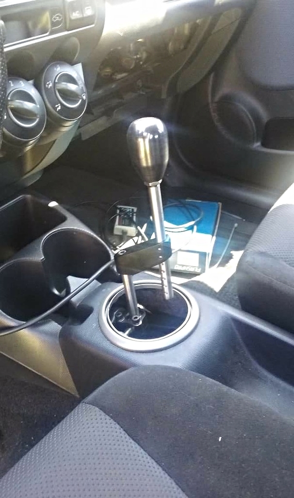

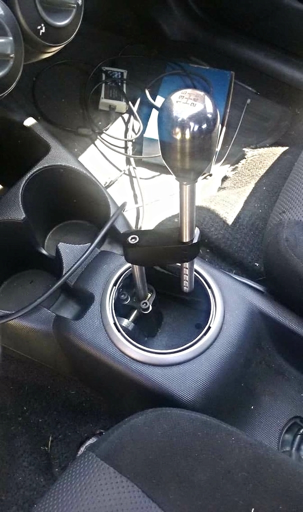

Modified Hybrid Racing Shifter box to fit center console with old school Skunk2 weighted shift knob (You can also see my Flashpro on the floorboard as well) lol:

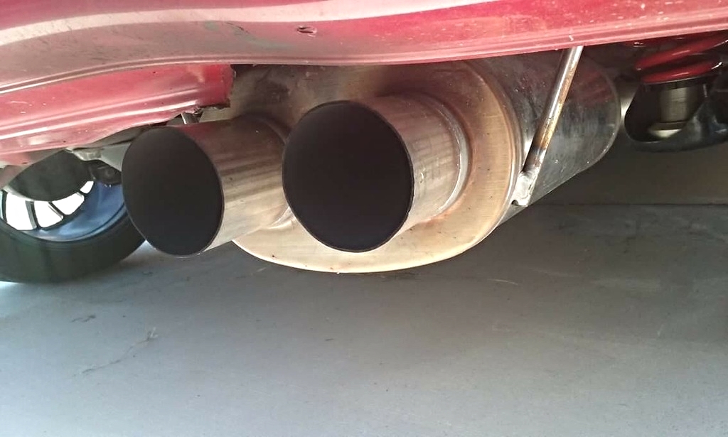

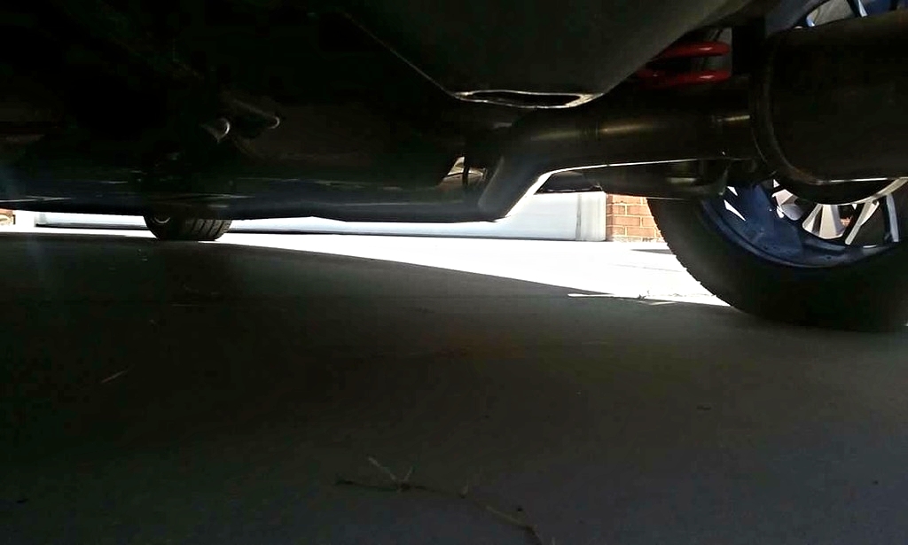

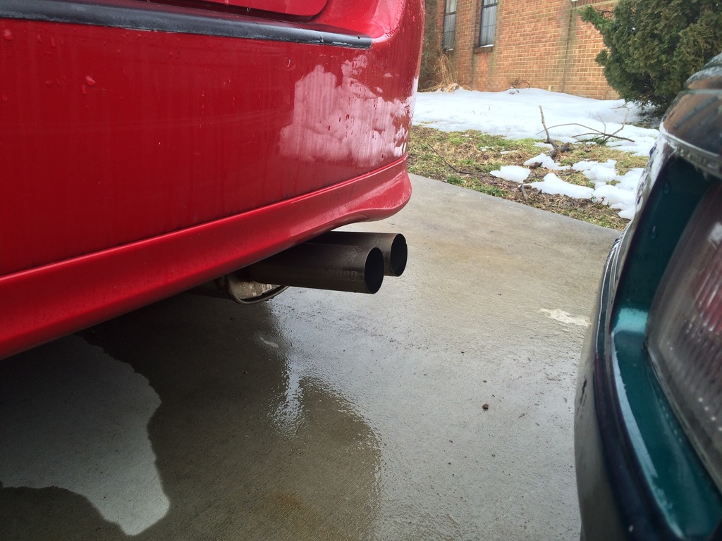

Custom 3" exhaust with Flowmaster Muffler and V-band clamps. I went with the dual outlet muffler because I want to put on Stainless tips like what was on the Megan muffler I had on the car:

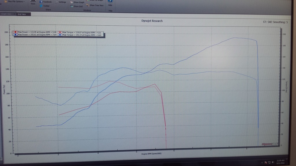

Last thing I got from the shop before my buddy went and picked up the car for me. 193 whp 142 ft lbs tq on stock internal motor with PRB im, custom intake, header, 3" exhaust and Flashpro:

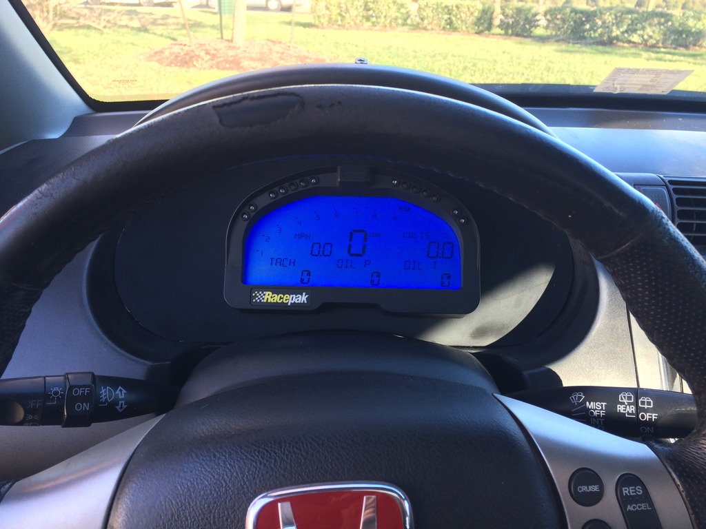

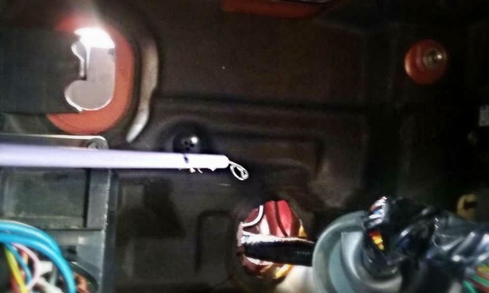

It's been a while since I have provided an update, but since my return from deployment, the holidays and just trying to get back into the swing of things I haven't had the chance to get on here. I have done a lot of little things to the car to try and troubleshoot my issues, but didn't think of taking pictures along the way to document my progress. I am still having issues with the gauges, so if there is anybody in the Virginia Beach area who is an electronics guru and is willing to help out I would greatly appreciate it since that is not my area of expertise.
This is what I am looking at, a Racepak with nothing displayed on the dash:

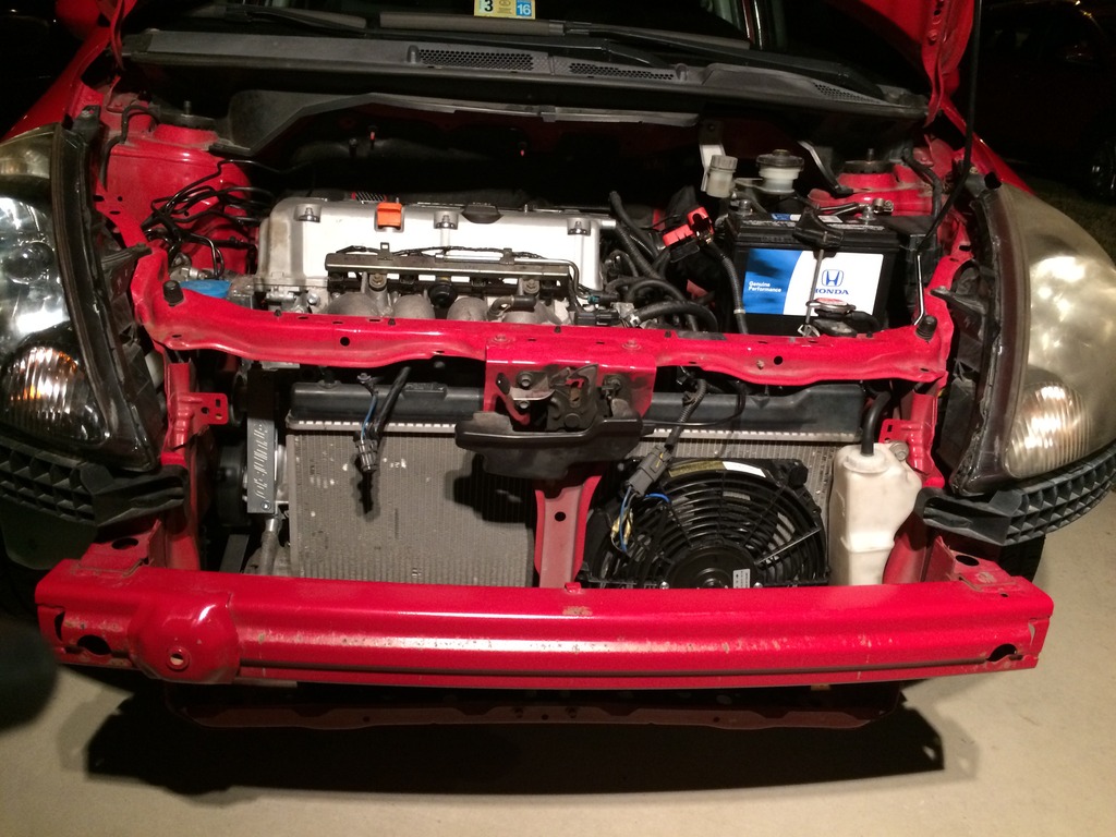

I noticed there was no overflow tank installed so I found a place to mount the factory tank:
