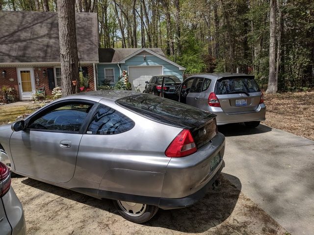

My GF recently picked up a "new" 2007 Fit Sport 5MT in silver to match my Insight, and I've fallen in love with the car. I could probably go on and on about its virtues, but you're all already aware of them. I have some serious car envy, and my only gripe is how very short 5th gear is. I did a bit of searching before deciding to register and ask, but has anyone ever produced a taller 5th gear for these cars? Or, if not, where would be a good place to have one made? I know eventually we'll have to do an ISB or clutch or something, and figure that would be a good time to tear apart the gearbox and do the swap if I can find a replacement. Price isn't a huge concern so long as it's not unreasonably expensive. I would do a few hundred, but definitely not approaching a thousand for a gear.
Some relevant and fun bits:
The GD is only 2" longer than Honda's tiny G1 Insight, 7" taller, and no wider. If you count the mirrors it's actually a hair less wide.
The GD weighs ~33% more, but has ~50% more horsepower and torque at the same RPM.
In 5th gear, the Insight cruises along at a very relaxed 2700rpm at 80mph, just below VTEC engagement, compared with with Fit's ~3750rpm - 40% higher at the same speed!
I understand many people don't like to need more than 1 gear at highway speeds for any reason, but frankly it makes sense to me to have a quieter and more relaxed drive, higher fuel economy and reduced engine wear, in exchange for needing to shift down to 4th for particularly steep hills or passing. I'm thinking 3400-3600rpm would be "about right", which would mean I'm looking for a ~0.647-0.689. Interestingly, 0.689 is the exact gearing of the CR-Z's 6th gear, though I don't imagine they're interchangeable. If it were my daily driver I'd be tempted to go even taller.
Anyhow, a couple of pictures for visiting my thread:
