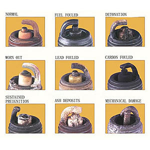

When my fit started misfiring, a mechanic friend hooked up his expensive shop computer, and was able to tell me which coil pack was faulty. Replaced it with OEM part from Amazon. That was a year ago, and it has worked fine since.
The internet proposes the strategy of swapping a good (new) coil pack for each of the 4 coil packs in turn, until you find the culprit. Won't take very long. All you need is a 10 mm wrench IIRC and one good coil pack.
I guess it could also be a spark plug. Common signs of faulty spark plugs include slow acceleration, loss of power, poor fuel economy, engine misfires, and difficulty starting the car. If it's just misfiring under load, my vote is for faulty coil. You could take each one out and visually inspect. Compare how they look to a chart for visual diagnosis of spark plug problems.
