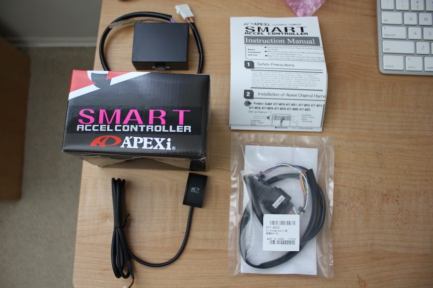

Here is a photo of what you get with the kit (Control Unit, toggle switch, directions, and Throttle linkage)
