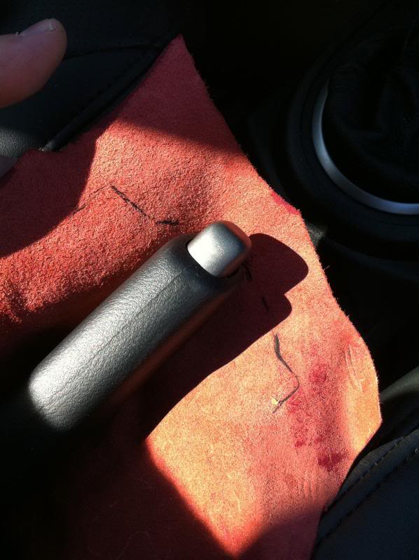

Start by sketching the rough outline onto the back of the leather:

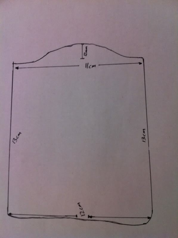

Here is a sketch with dims:

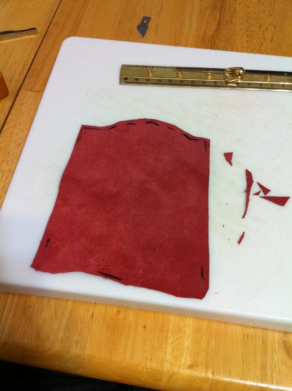

Once the sketch is transferred cut out using exacto knife:

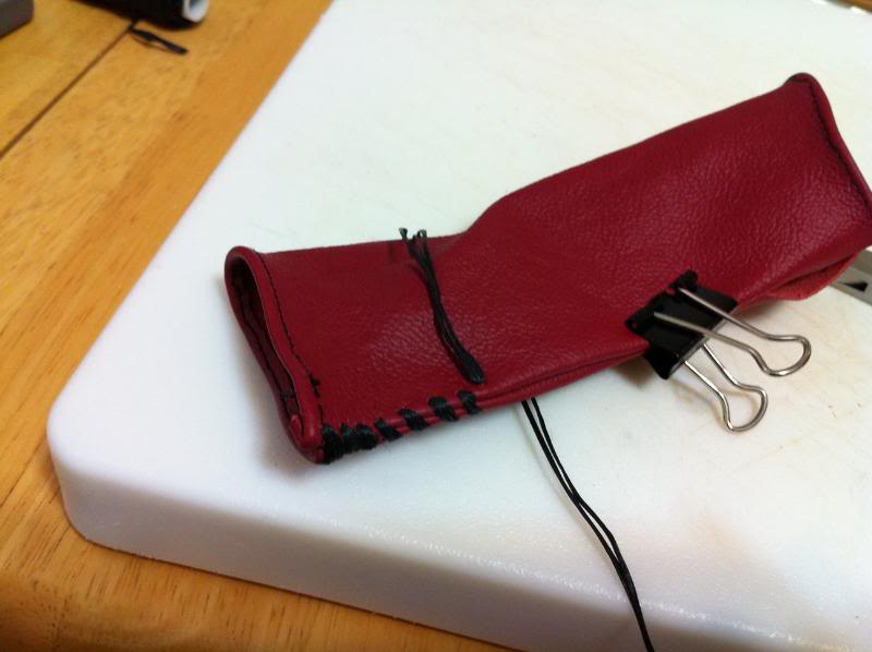

Now fold in each of the sides about 3-4mm and bring them together. I used an office clip to hold it in place. Thread your nylon yearn through a needle and start sewing the two sides together:
When done tie off the end and you should have something like this:

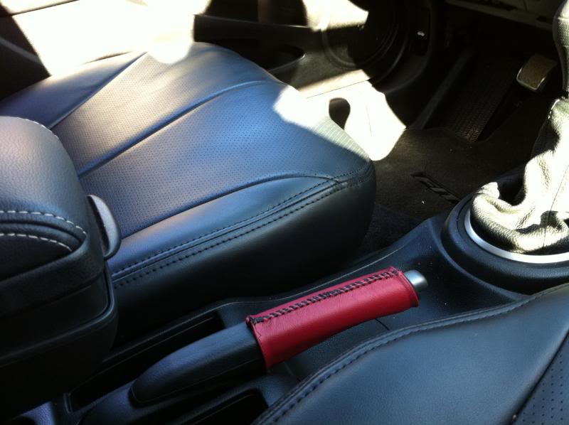

Now just slide over your e-brake handle. It will be tight but will fit. Once on it should look something like this:
I know this same thing is avail to import from Honda. But the leather and yarn was less than $10 and doesn't take too much time to make.
