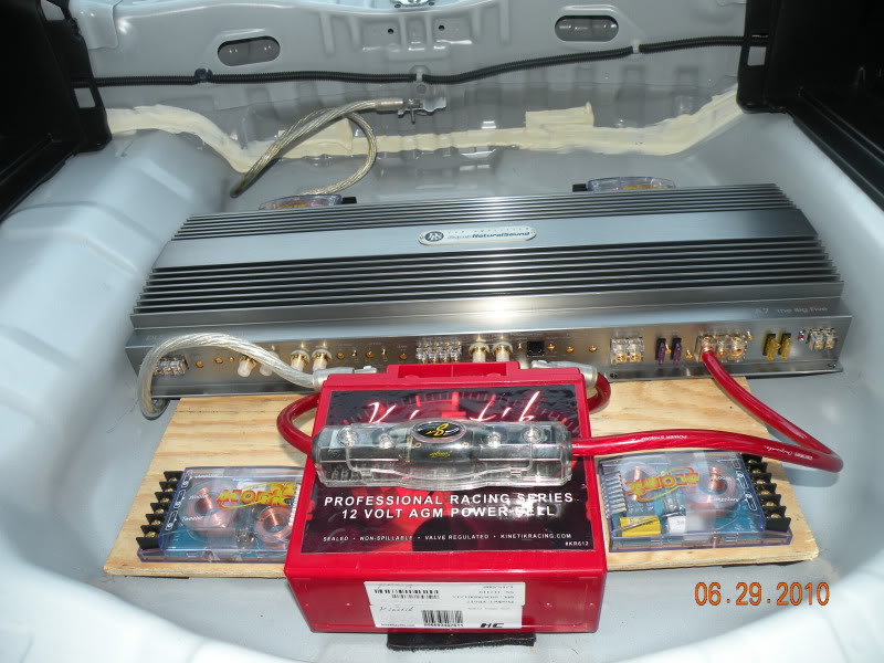

Originally Posted by sdwldcom
I have the PDX-5 and the Alpine SPR-13C/13S, I removed my spare tire and had the installers put the PDX-5 and the CrossOvers in the Wheel well, check my gallery
Steve
Thanks for your input. I don't want to take the spare out, so this isn't an option. Interesting install, though. Why would they put the crossovers in that area? That would just mean you have to run double the speaker wire to the fronts.

Old Apr 9, 2011 | 12:01 PM
britdevine's Avatar
Joined: Dec 2009
Posts: 229
From: CNY
Taking the spare out and putting everything in there just makes everything so much easier......until you need the spare...but thats what AAA is for.
