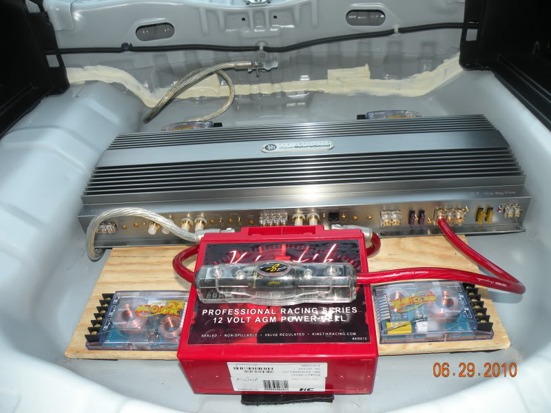

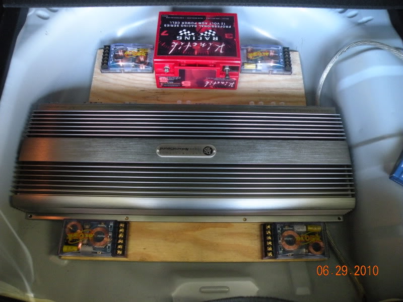

DLS A7 5 channel in the tire well with an Extra Kinetec HC600 Battery...I curently am running a pair of Shok Industries 6.5 components in the front seeing 200w per side...Have a set of Massive RK6 components on the way

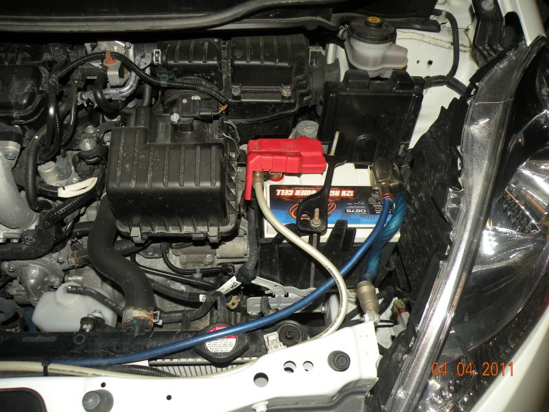

XS Power D975 under the hood

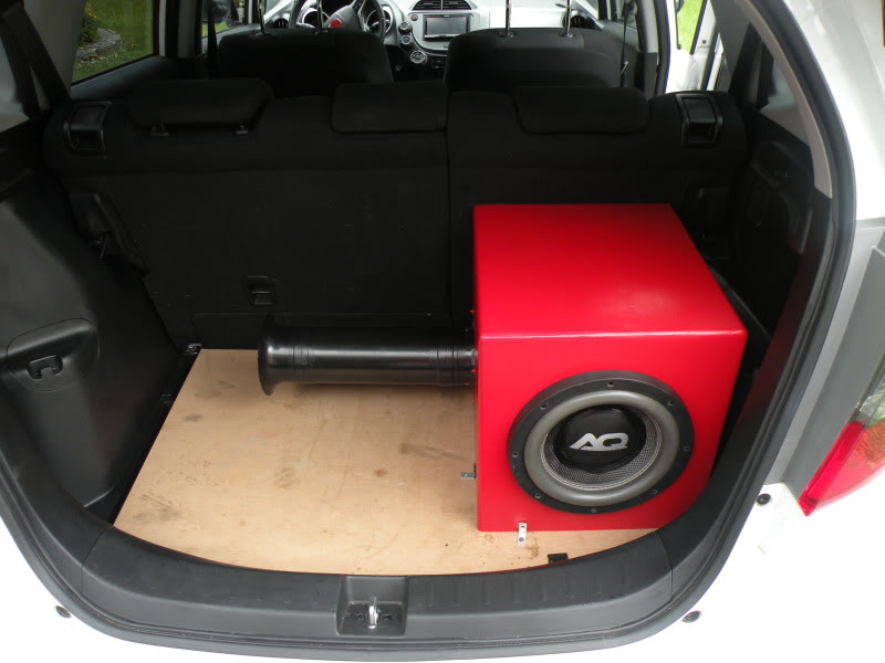

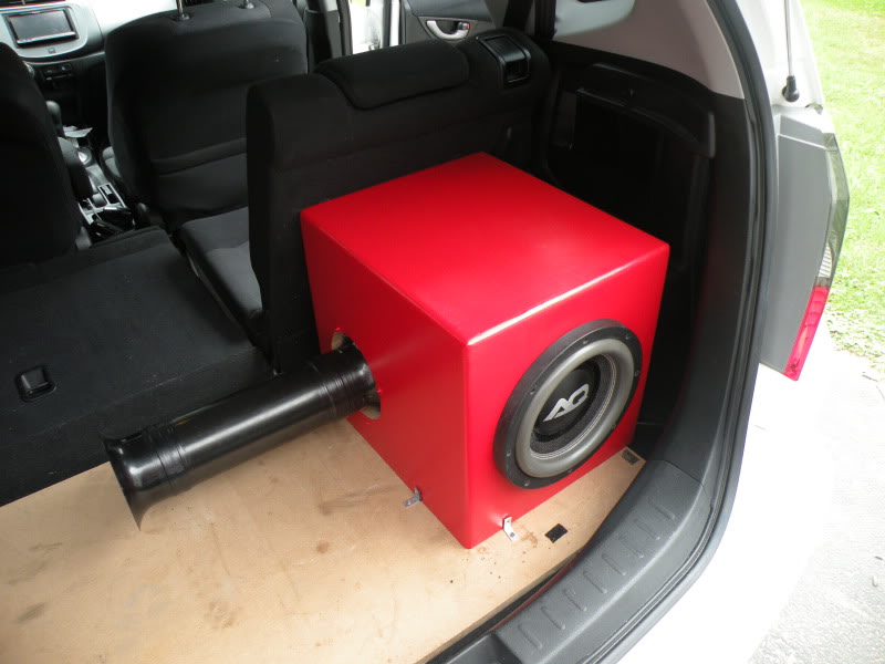

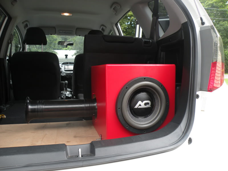

New Sub box I built and painted...Sub is an AudioQue HDC3 10 Dual 2 ohm...I spent ALOT of time building this...so much sanding...sanded between all 3 coats of primer...and all 3 coats of paint. I need to carpet the floorboard and I will be all set now! Box can be taken out in about 1 minute, so It's easily removable if I need the hatch area.
Box is 1.45 cuft net..tuned to 36.5 with a 4 inch aeroport..it is the best sounding sub/box combo I have had for daily ever....and I have had alot

Originally Posted by britdevine
S
just curious as to where those extra power and ground wires are running to?
is it directly to your alternator and block?
Old Aug 8, 2011 | 03:01 PM
britdevine's Avatar
Joined: Dec 2009
Posts: 229
From: CNY
The 4 gauge are going to the battery I have in the tire well of the car, 1 wire for + 1 for -, to connect the batteries together to allow more power to the amplifier which is hooked to about 1 ft away from the battery in the spare tire well.
The 0 gauge off the negative is just a bigger ground.
There aren't any "extra" wires.

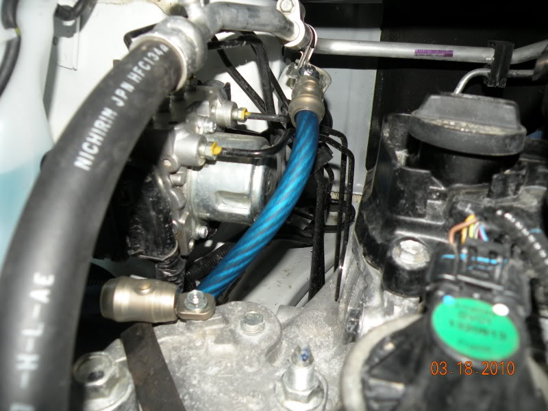

Might wanna ground to the block of the motor or strut tower, will improve your resistance level on the ground side. But you know this!
Old Aug 8, 2011 | 05:49 PM
britdevine's Avatar
Joined: Dec 2009
Posts: 229
From: CNY
I upgraded the ground on the left side of the engine a long time ago

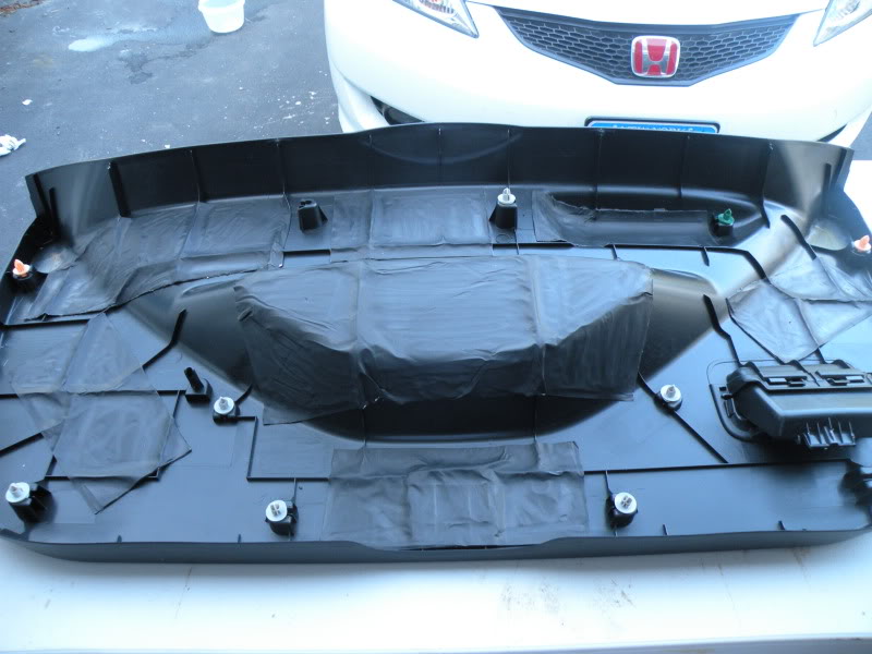

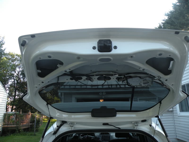

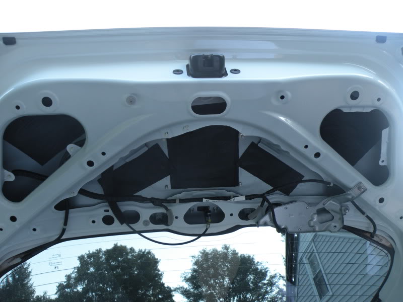

Bye Bye Hatch Rattle...this was super easy to do...and the difference is night and day...took 20 minutes. I used Damplifier Pro in case anyone is wondering.
Before
After

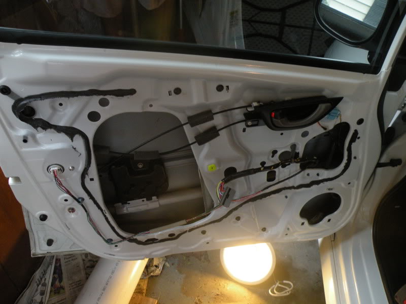

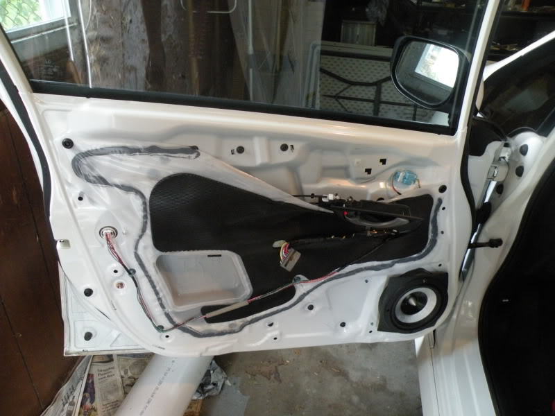

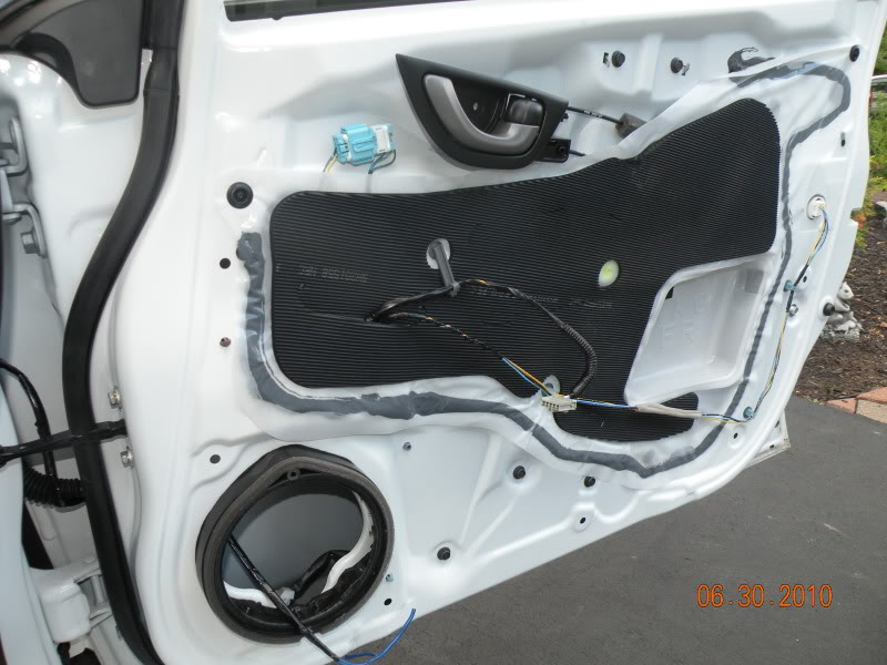

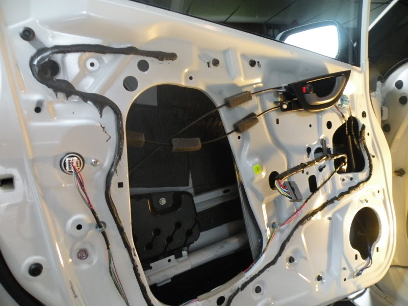

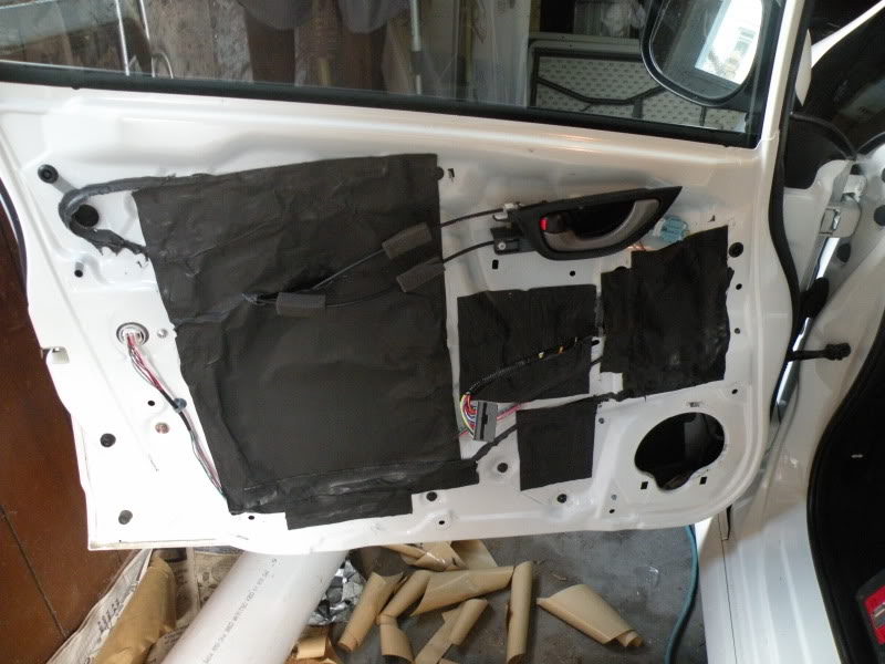

Put in New Components and Put some Second Skin Damplifier Pro on the doors

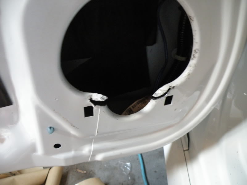

These new Massive RK6 component sets midbass were so huge I had to cut of some of the factory metal on the speaker area to get them to fit....no on will ever see it..and it doesnt affect anything at all if I ever want to put something else in.
Stock Vapor barrier
Vapor barrier Off
Deading the Outer Door Skin
Inner Door Skin
Modification - Had to cut that little bit out
