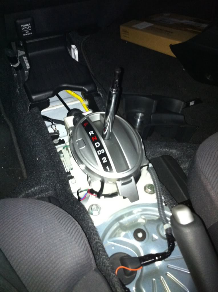

Ok,
I got another picture from one of fitfreak member's post,
and on this pictures you can see the Plastic rod/plunger that I am talking about,
the plastic rod/plunger on Honda Fit is BLACK in color:
Done!
Finally I am able to get it installed.
The FIT ROD/PLUNGER were actually NOT longer than CR-Z's ROD/PLUNGER,
but the different is, the CR-Z one have it's top end cut at an angle,
while Fit one have it's top end flat.
So, I cut the Fit Rod/Plunger at an angle like CR-Z,
and then I also need to trim the outer diameter near the top,
because the hole inside CR-Z Shift knob have smaller diameter,
compare to Fit's shift knob.(actually it is not a square but kind of rectangular shape). But I keep the length the same.
Above picture are CR-Z's Rod/Plunger so you can have idea how much angle you need to cut.
Also when you plug the Rod/Plunger into the Shift BASE/Assy hole,
make sure you push it all the way in (there is a square like socket/female socket at the bottom end of the Rod/Plunger), shake it to the left and right until you manage to get it seat onto the male socket at the base).
