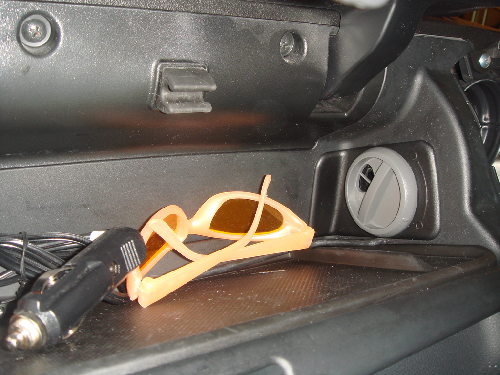

Start by removing the stock blank cover from your upper glovebox like so
(mine had the valve already in this pic)

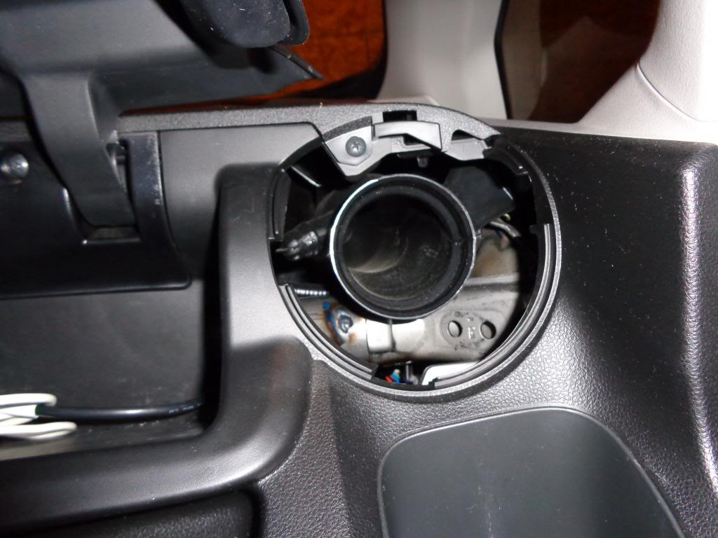

Remove the vent cover by prying with the same tool from the top, it'll come off pretty easily.

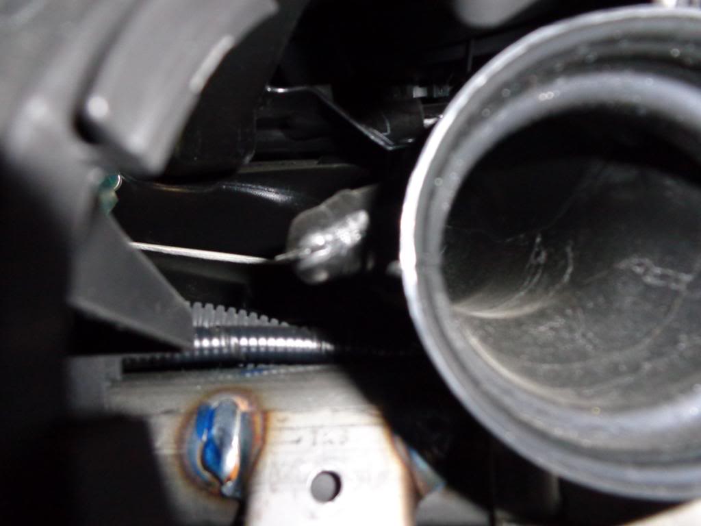

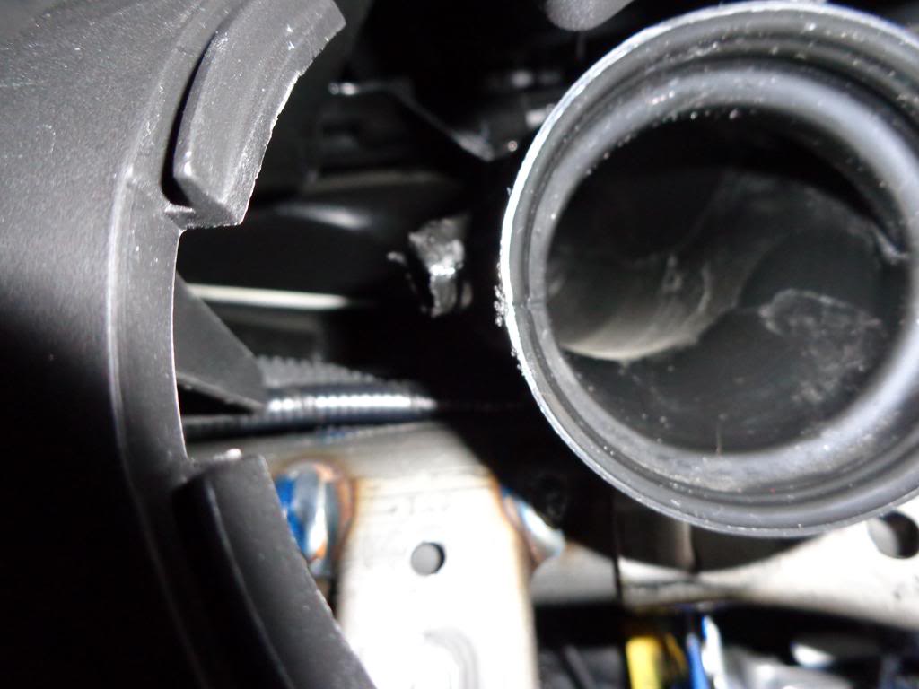

Locate the little nub on the left of the vent. This is where the tube will connect to.
Use the garden trimmer to cut about 1/2 inches of the end of the nub.

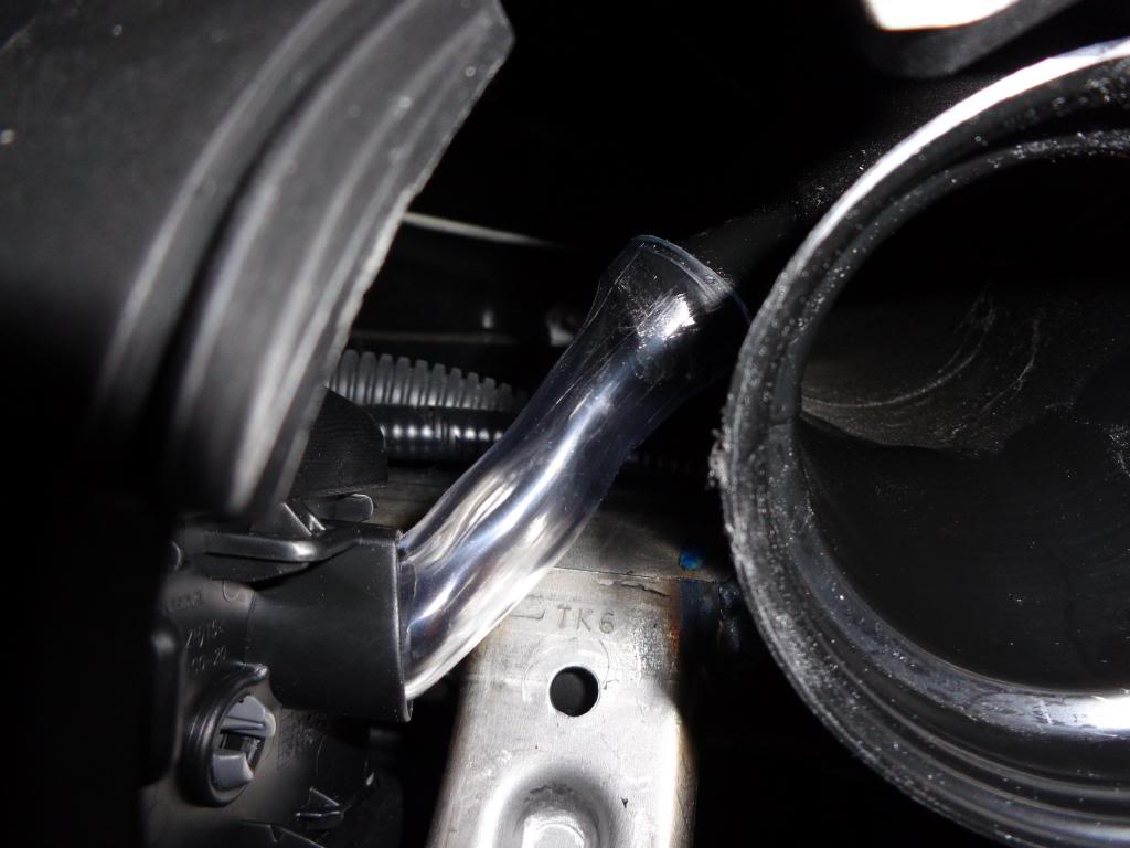

Slide the rubber tubing over the nub until it is secure. Figure out the length of tubing needed by test fitting it in the valve cover and clipping it into the glovebox.
Once you get the right length of tubing you will end up with something like this.
Put the vent cover back on, and you're done! Turn the valve up or down to activate the heated/chilled glovebox. Closing the vent will help the performance as well. Here's the final result:
Enjoy!
