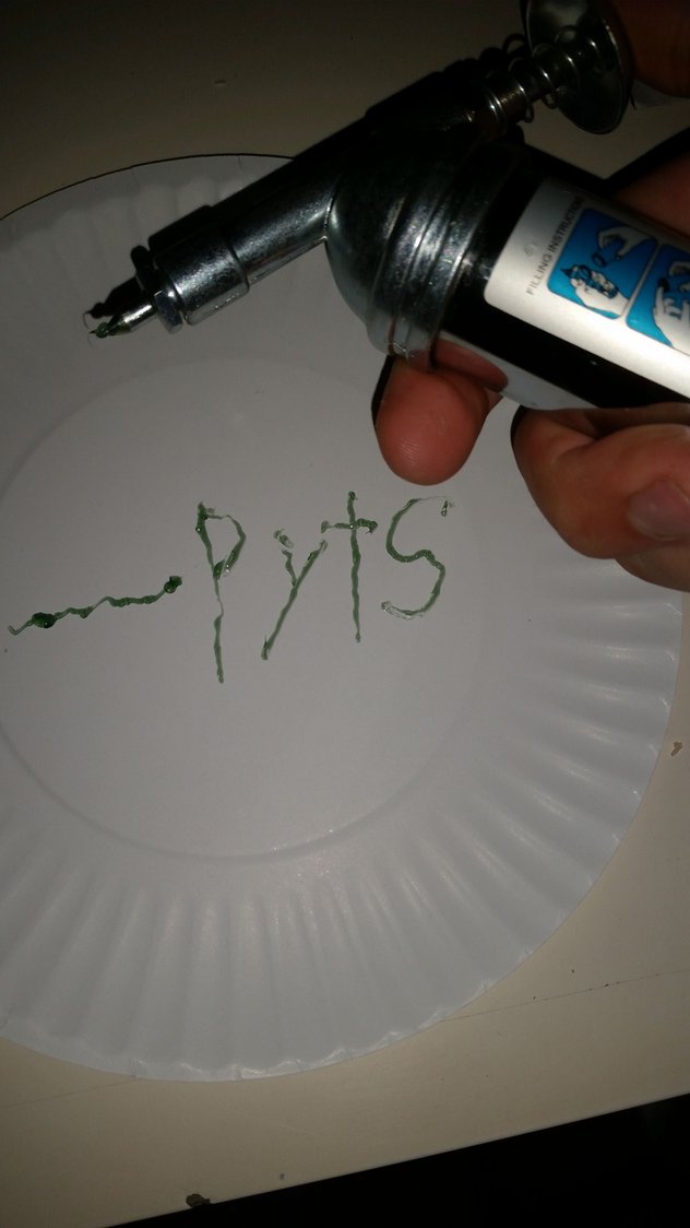

I took a minute to look up low-temp chassis lube and found "lubriplate low temp", popular for garage door openers.. ahwell, one thing I can honestly recommend is this:
Its a mini grease gun with a needle tip Its a mini grease gun with a needle tip
, the link is to amazon. Its chincy, you hand pack it, it doesnt come with a rod to push the base plate up and compress the grease, and its the best grease gun I've ever used. Would require component removal, but you could use a heavy grease and it would go where you want it.
The squiggly lines are due to unsteady hands.
Almost forgot to mention why its the favorite. Doesnt leak.

Interesting , less mess be a plus . Have to keep the gun I use in a covered bucket . Good lookin' gun writing . How about in cursive ?

. Thats' better than my cursive with a pen . It's disappearing with the younger generations .
