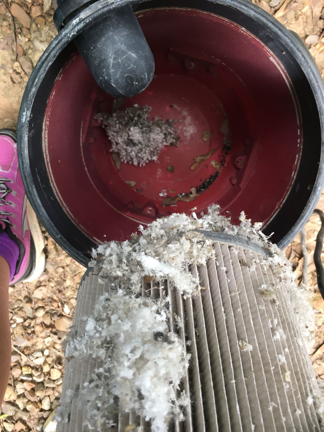

I was able to find the nasty mess of a nest. I took out the glove box. Two easy screws underneath. There is also a molding under the glovebox I took off as well. Easy clips.
took out the cabin filter. From there one can see the trap door activate as you switch from recirculated air to inside air. With the trap door in a certain position that trap door made evidently the perfect spot to make the nest. Unfortunately the foam that insulated the trap door is mouse urine soaked. I diluted by soaking and then sopping most all out. My results make air quality a thousand times better, but I’d really like to change that trap door. OR second best, maybe get some activated charcoal in a small porous container to absorb odor and moisture
It was gross.
I also was able to snake my vac hose up inside somewhat.
