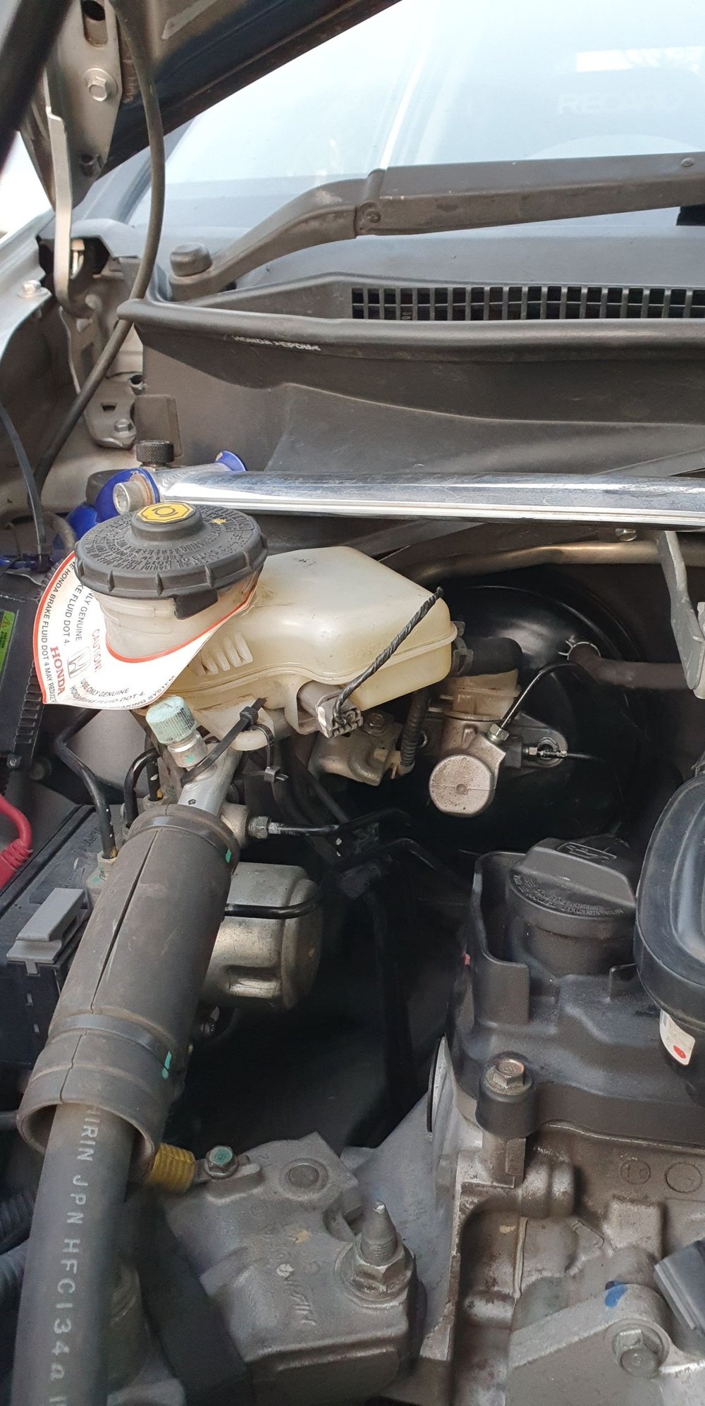

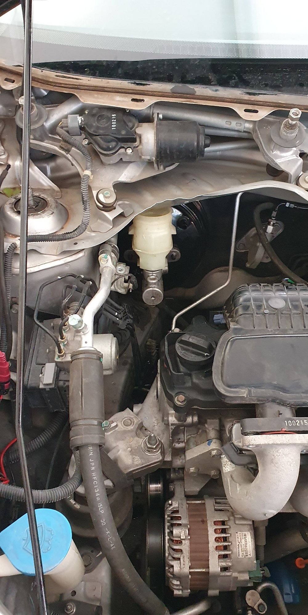

I recently change my ge8 brake master to the odysessy master using an ek9/dc2 brake booster.
I also test fitted an ek9 one... well it fit but didn't at the same time

Thanks for that reply, that was actually really helpful! I'll see what I can source from Japan/Australia for an M/C, unless someone has a cheap J's racing M/C that they want to part with. Don't want to go through the hassle of swapping out all the lines and brakes (DC2R front, Hybrid/EP3Si rear) just to have to redo all the brake bleeding. Much rather do everything at one time and save myself the hassle.
