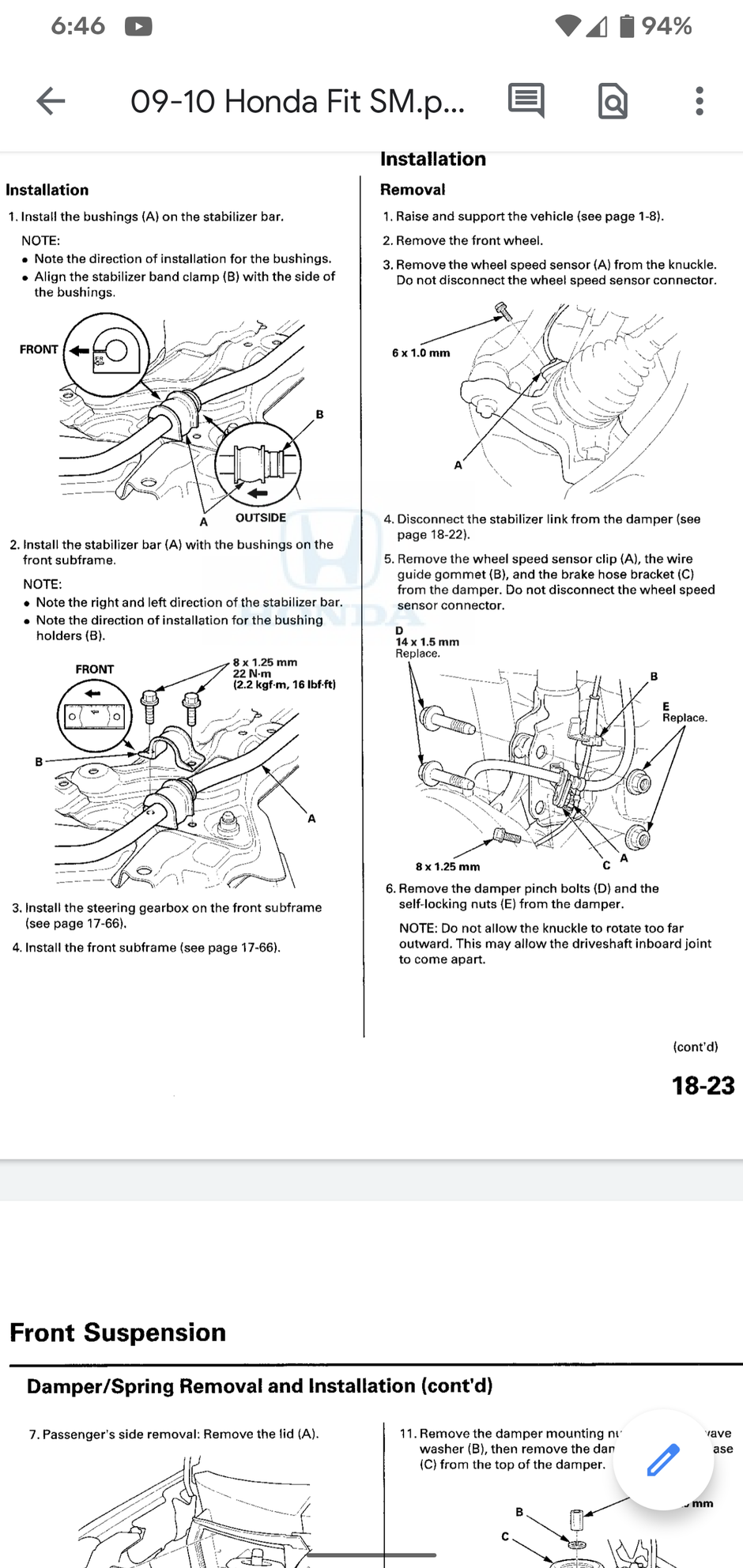

Service manual on strut job. The pages might be out of order, I'm uploading on mobile. Anywho, easy to do.

Thanks for the info. I'm not too good at drawings but I'll take the wheel off today to have a look. Thanks again!
