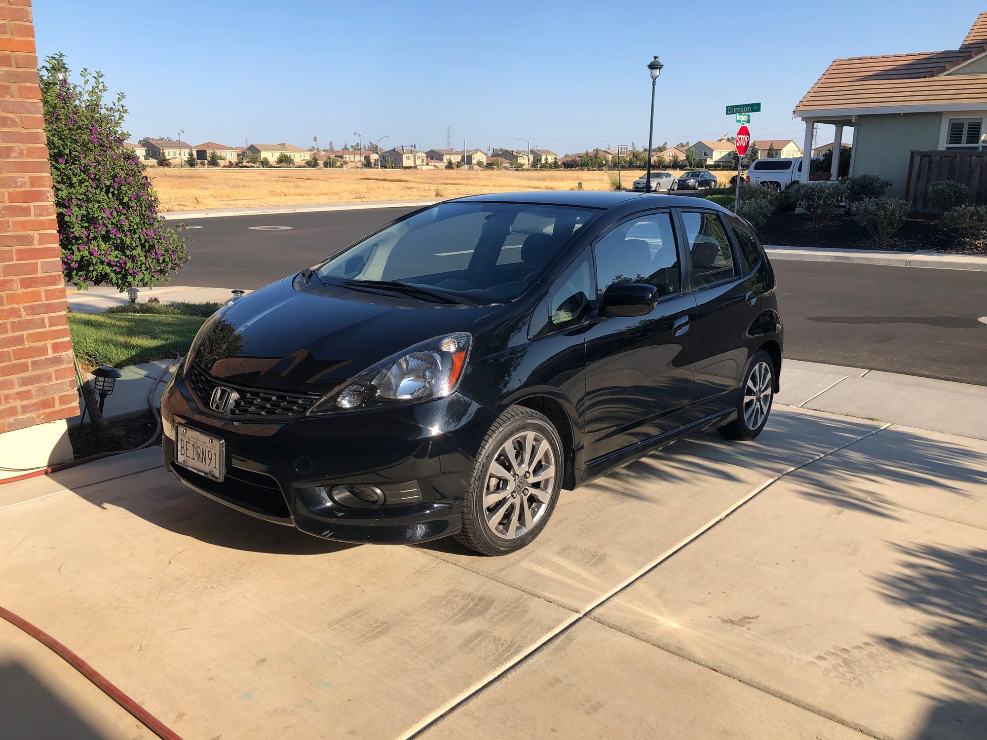

Hello, just bought my second Fit. 2012 5spd black on black. No real plans, just drive and maintain. That said I may do basics. I’ll start lurking to get smart on maintenance stuff.

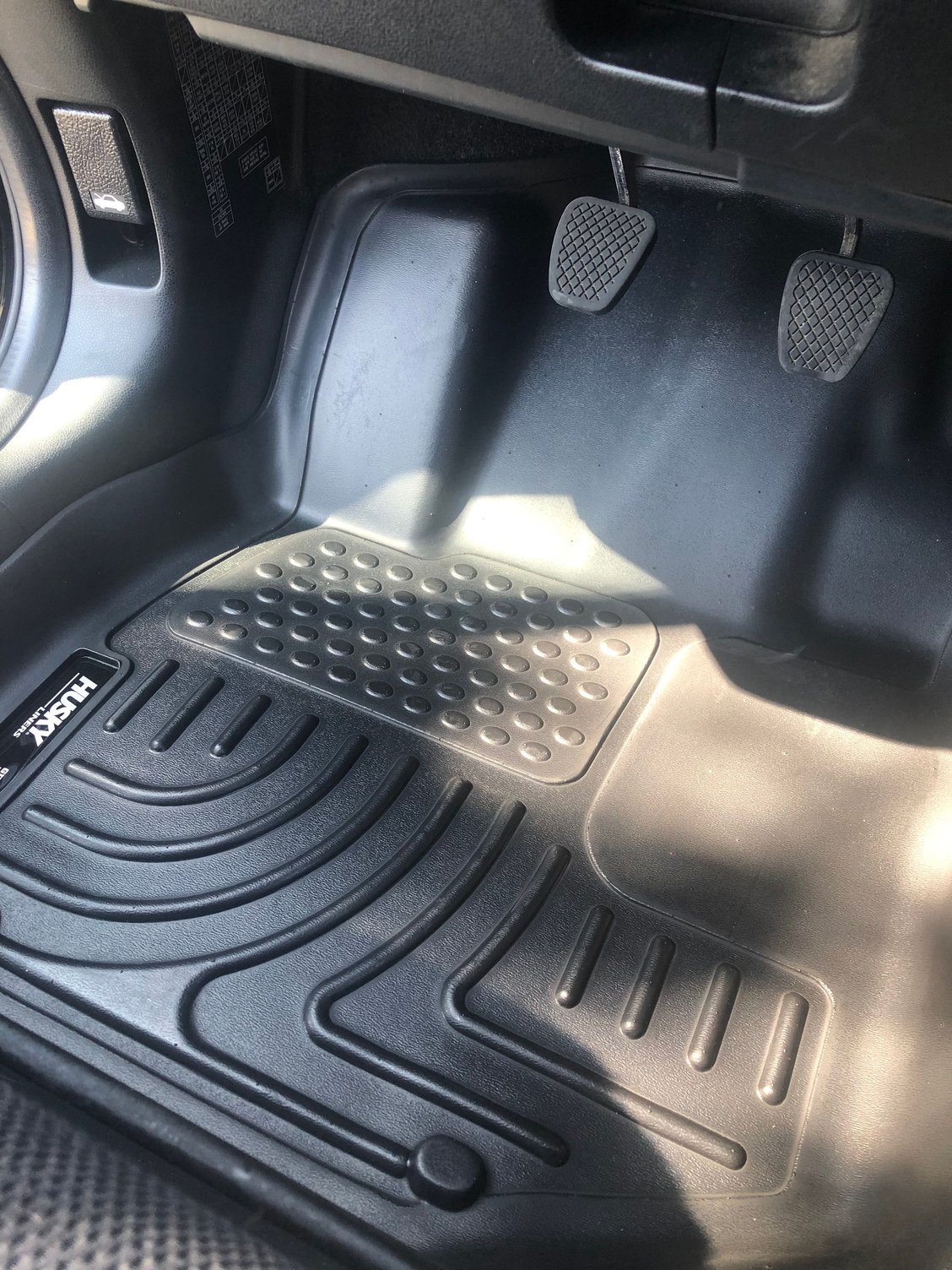

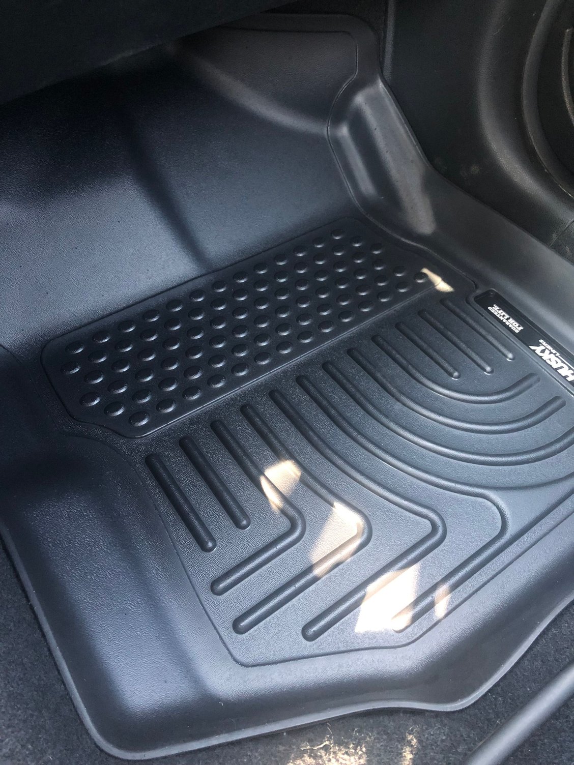

Put my husky liners in. I switched them them in my Land Cruiser after dealing with poor fitment from weather tech. 9/10 would recommend.
decided to place over the factory carpet mats in an effort to control cabin sound.

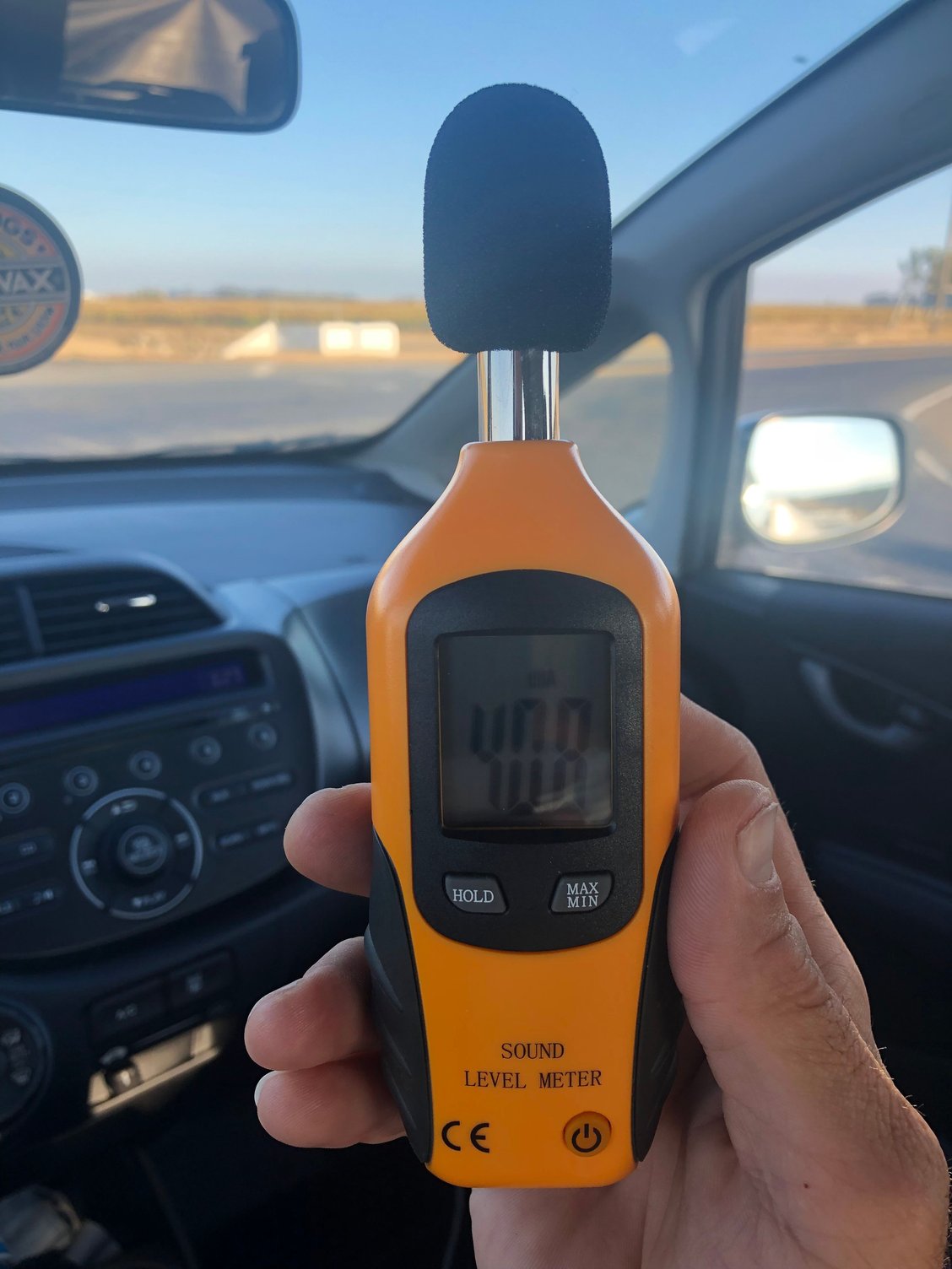

So after lurking a bunch of threads on sound deadening I’ve decided to add to the brain trust. I will document objective and subjective info on what I do to cut cabin sounds.
Baseline is established on the same stretch of farm road. Meter is roughly shoulder-height in the center between the front seats. Sitting in car: 35 dba
Closing door: 77 dba
Sitting in car at idle: 41 dba
Sitting in car at idle ac blasting: 67 dba
Cruise ac blast at 45mph: 72 dba
Cruise ac off at 45mph: 70 dba
Cruise ac blast at 75 mph: 76 dba
Cruise ac off at 75mph: 76 dba
Old Aug 26, 2021 | 11:30 AM

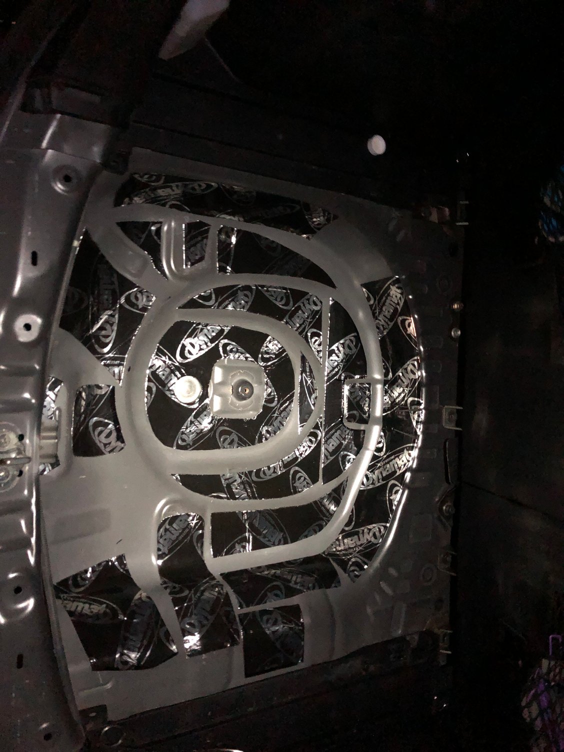

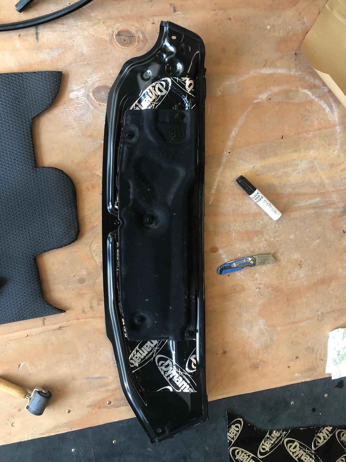

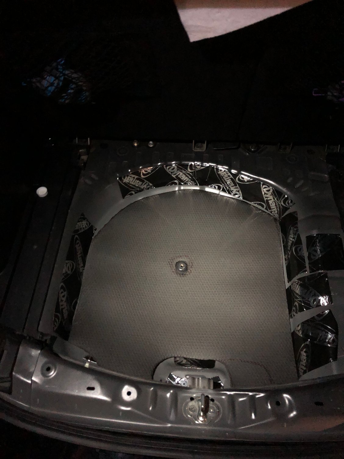

I started in the engine bay, I just covered the bottom of the metal deck above the motor. No changes to db level but the pitch is noticeable better. If/when I do a k swap I’m going to use a damplifier blanket and accustic paint to insulate the firewall.
The trunk is done too. I just covered areas that had a tin sound when tapped. I used a thick yoga pad to fill the spare tire area.
