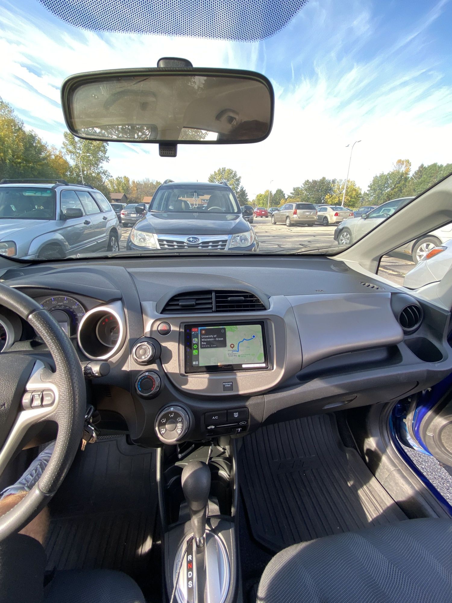

Just installed a new double din radio that has apple carplay. I got it from crutchfield and it was very straight forward to install. It is a Pioneer DMH-2660NEX. I was able to route the cable under the side of the center counsole for an extremely clean install.

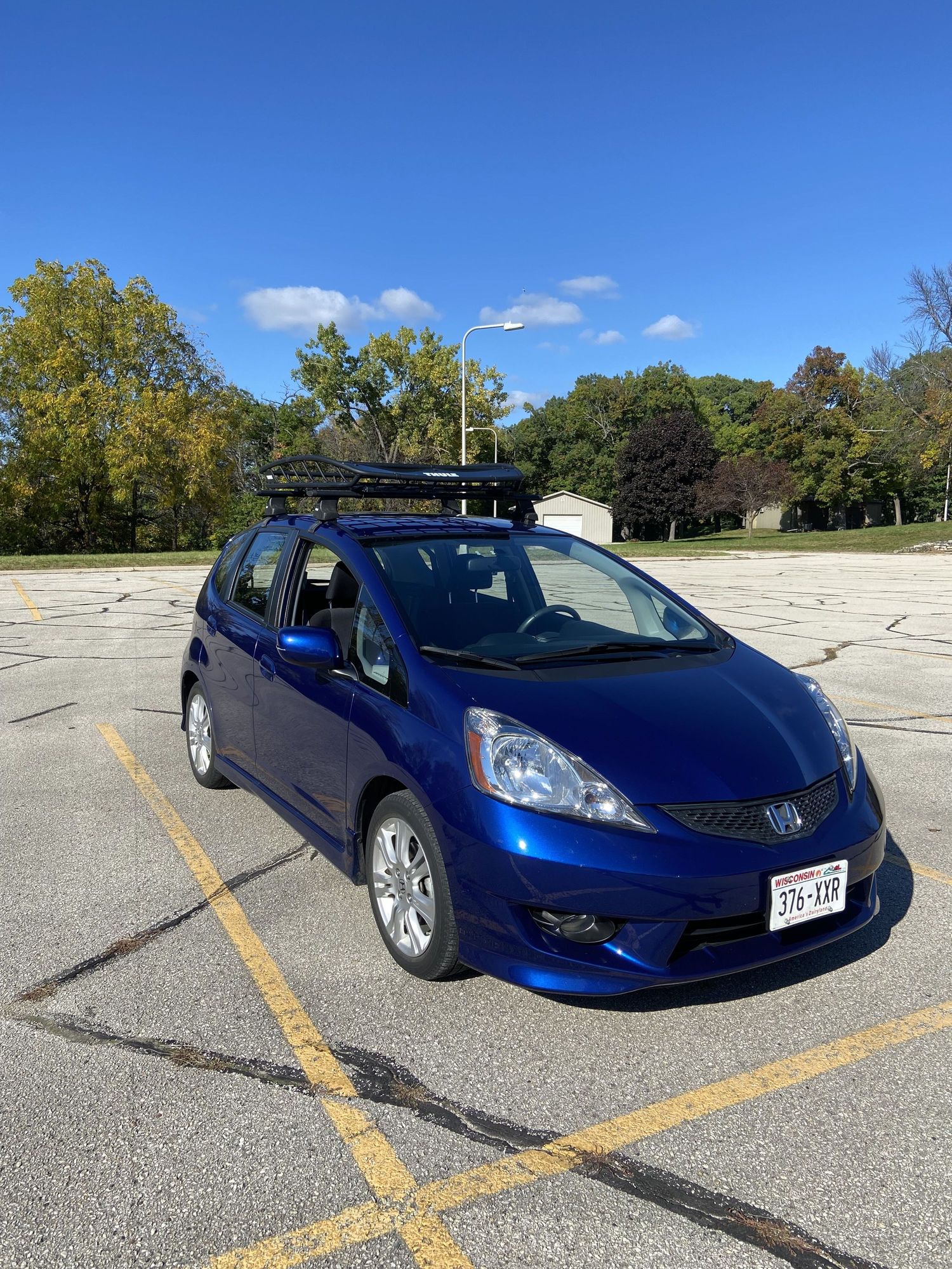

Just picked up a slightly used Thule Canyon XT Roof Basket.

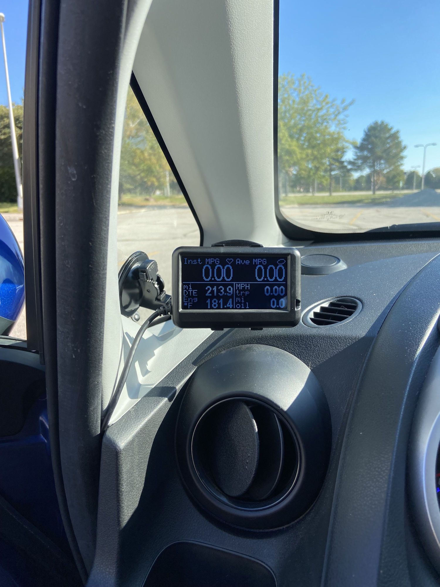

I also just installed an Ultragauge. I am still deciding on what gauges I want to display. The cabel runs perfectly in the door seal and underneath to the OBDII plug.

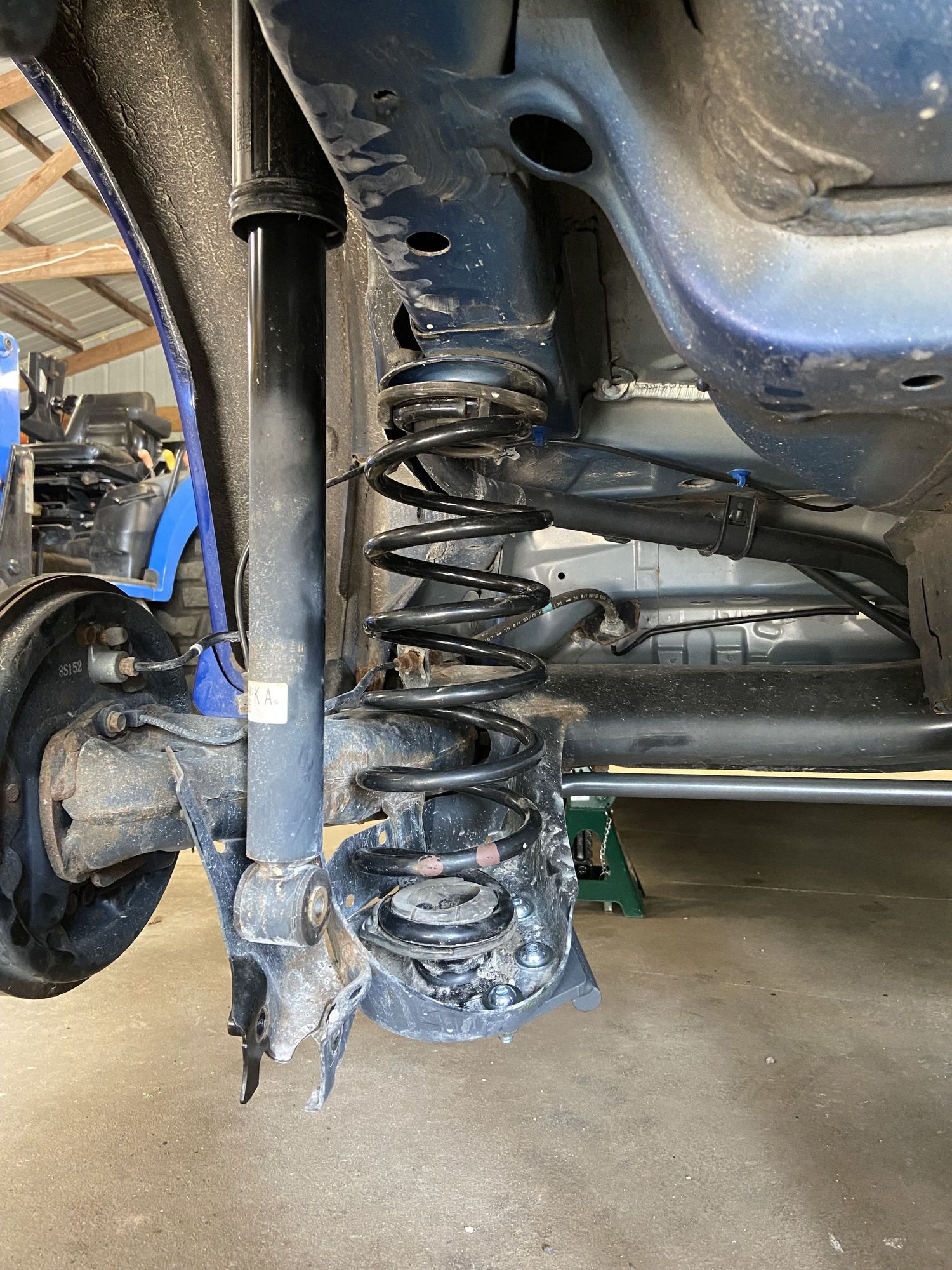

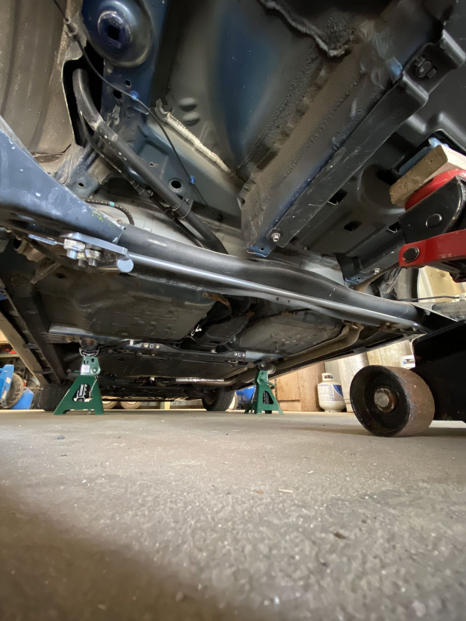

Installed the rear coil springs out of a 2010 Honda Insight.
Old Oct 17, 2021 | 04:42 PM
kylestoll's Avatar
Joined: Sep 2021
Posts: 14
From: Green Bay, Wisconsin, USA
A Progress Technology rear sway bar was also installed while I was under messing with the springs.

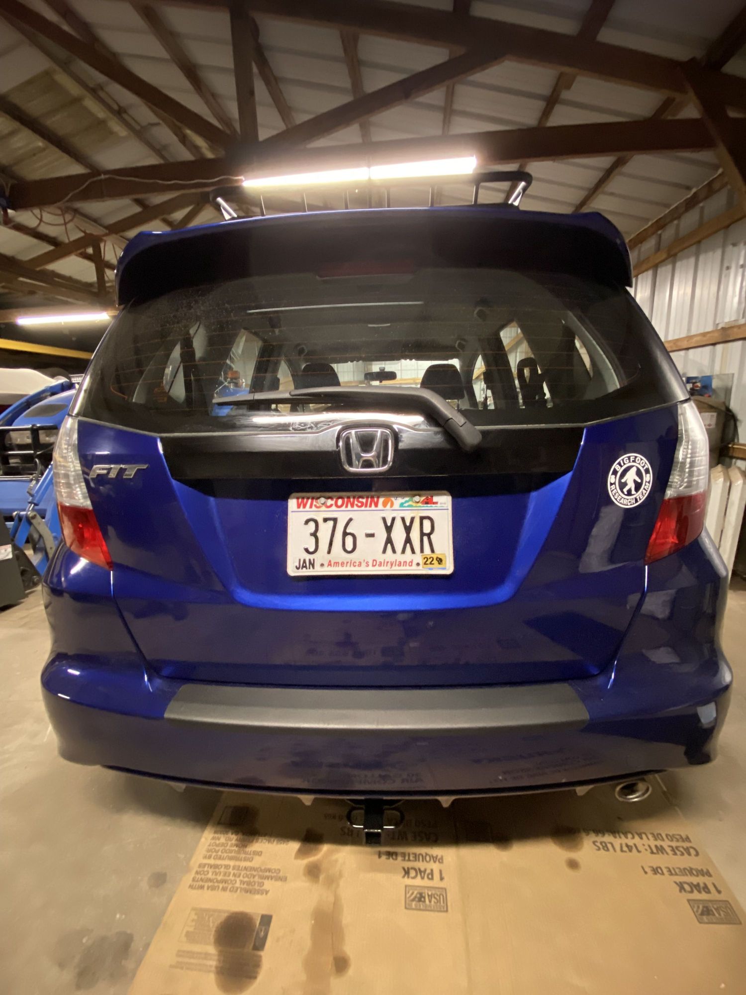

The last thing in the rear of the car was a draw tite hitch that bolted right up. I also got rid of the Van's Honda sticker and replaced it with one of my own...

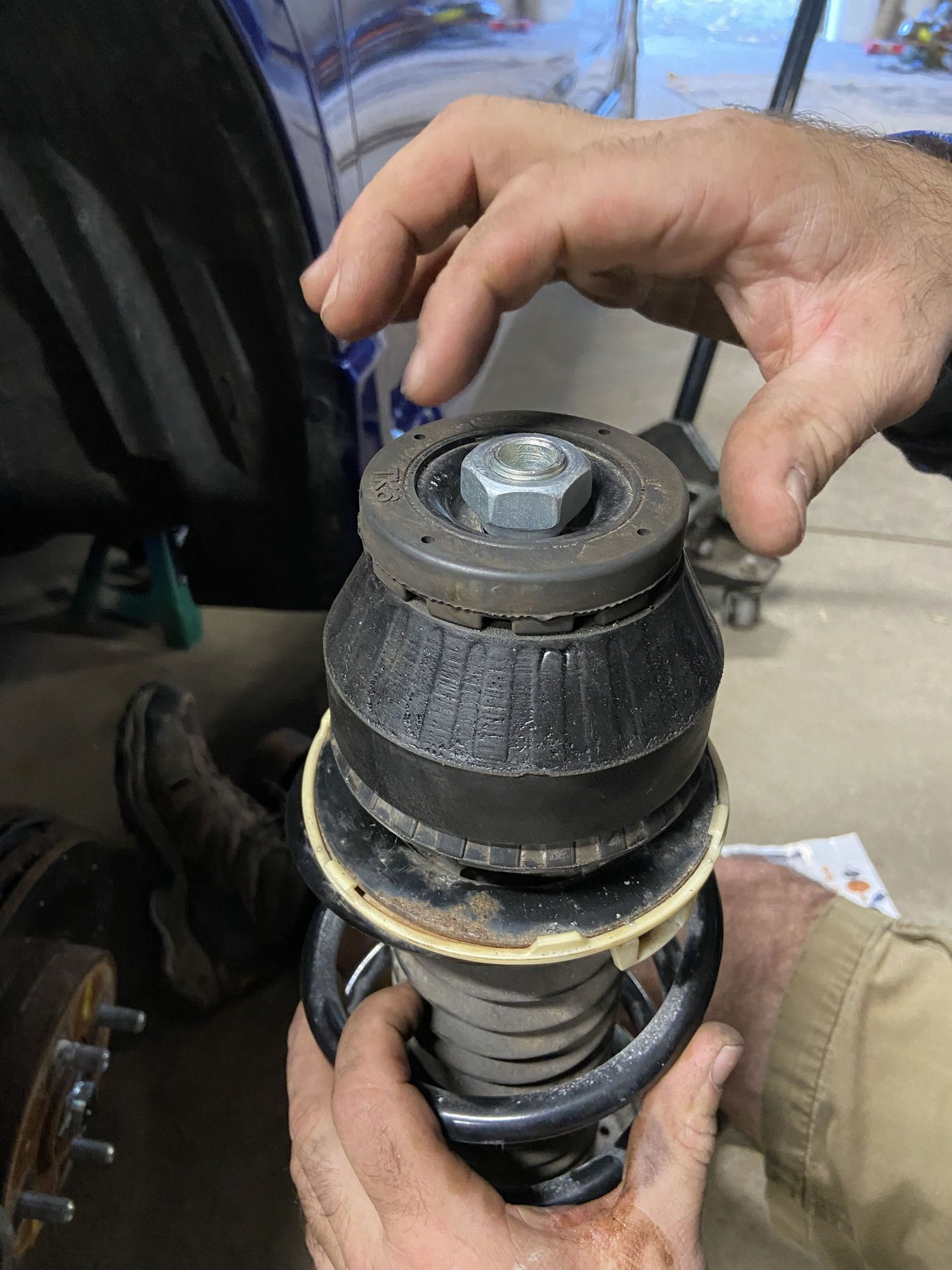

Up front, I went for the Tema4x4 front strut assembly spacers to level out the car. This is how I installed it with the top of the strut tower in between the top rubber part and the added spacer. I only had to enlarge the hole on the top rubber piece.
