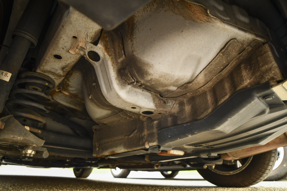

I've had my '09 since it was new and it's been exposed to northern Ohio winters. We get a lot of salt too, but our salt season is probably shorter than Newfoundland. Most GE Fits that I've seen around here don't have any visible rust, but I did see one a couple of years ago that was astonishingly rusty - wheel wells, door bottom edges, etc. So they do rust under the right conditions and level of care. Mine is practically rust free, but I'm very diligent with rinsing off the salt whenever the temperature gets above freezing. I use a lawn sprinkler attached to the end of a 2x4 and sweep it back and forth under the car. Most people wouldn't think this is fun, and even with rubber gloves it is a pain in the neck and my fingers get very cold. But the reward is that my '09 Fit looks like this (the red things are Air Lift 1000 air helper springs).

@Ultrawolf That's one heck of a contrast! I'm really appreciative also to see how well your chassis has faired with maintenance.

For reference, here's a photo of my Fit's rear end at August '20 when it had 546k miles (880k kilometers). Currently has 576k miles (928k km). The car has rarely been cleaned up while living most of its life in New Jersey from 2008-2016 at 390k miles (627k km)

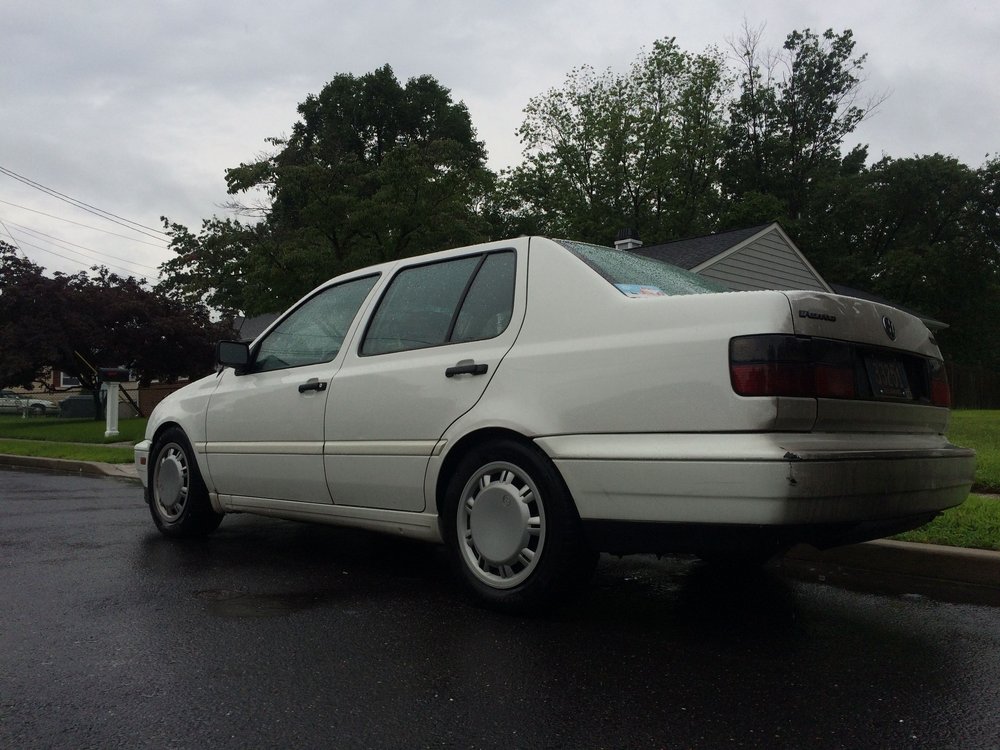

This is applied to any car, despite the body style. Ever noticed when a car drives through powdery snow or a gravel road that the rear end is always covered? The same goes for the underside. Here's a photo of my daily before the Fit: a '98 Jetta TDI. The end of the exhaust was pointed down, but the soot always ended up at the back.
