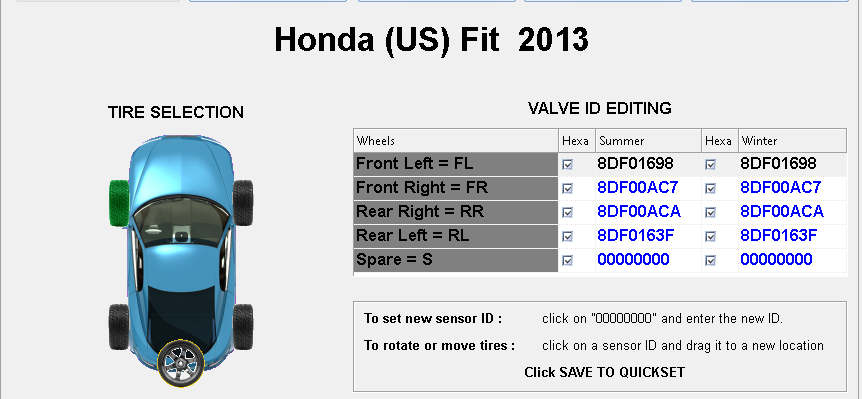

Sorry to resurrect an old thread. I have a 2013 Honda Fit Sport. The TPMs light will not turn off. I have verified each will sensor is communicating however I am getting a code for left rear sensor communication. The Honda technician confirmed all sensors are communicating and was showing green with the honda dealer scan tool. When the code is cleared it comes back.
code: 38 I believe.
I bought a ATEQ-QuickSet tool. I can see all the sensor ID’s for each wheel.

Old Apr 20, 2022 | 10:56 AM
1QWK96GT's Avatar
Joined: Mar 2022
Posts: 8
From: Springfield, Va
This is what came from the PCM from the ATEQ-QuickSet I have.
Does that only pull the IDs from the PCM? You need to also pull the IDs from the sensors and make sure they all match

Old Apr 21, 2022 | 09:00 AM
1QWK96GT's Avatar
Joined: Mar 2022
Posts: 8
Yes its my understanding that this ATEQ-Quickset is pulling the sensor ID's stored in the PCM.
So yes it would be best to check to see they actually match the sensors.
