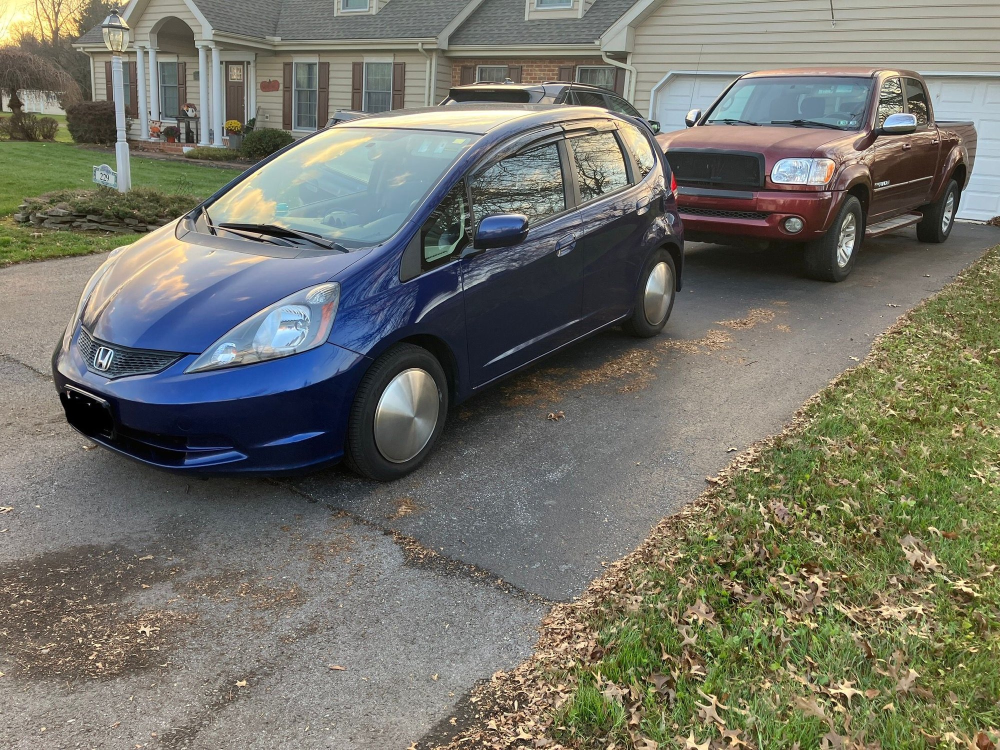

Installed!

Choice! 👌 How'd it go?

Easy-peezy. I’ll post the instruction once I get on a laptop. The headrest part was sourcing a drill with a big enough chuck to hold >10mm drill bit. Everything else was a piece of cake. It probably took me 30 minutes.
