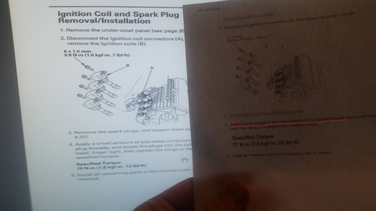

At your discretion. I understand the basic concept of how anti seize affects torque values by reducing friction and do recall someone stating it can increase overall value by up to 20%. Assuming that's correct you'd be left with a value of 15.6. I've done my plugs a ton of times trying different things. Dry, copper, nickel, copper spray gasket, including a few months back where I ran 'em with nickel anti-seize at 20, and they loosened within just a few months. BUT I do use Denso IK22 powersports plugs (referenced in my superstreet/import tuner thread by Kraftwerks, purposed to address cylinder hotspot in L15A7), so thats an additional variable.
Somebody recently uploaded my old pic comparing the bishko manual to an updated print from the Honda dealership in Escondido, CA, where they raised the value to 20 ft.lbs. and made no mention of anti-seize.
That may not carry over across all dealerships though.
Just curious, if this is the manual/pic you're referring to? I agree that you will find many posts on many forums for many different auto manufacturers/models debating the pros and cons, but there is mention of anti-seize in this manual.
This is what I did the last time I replaced mine. I used copper anti-seize on mine at 199k miles 3 years and 27k miles ago and they (NGK) are still tight. First time in 40 years I've ever had the need to use a torque wrench or anti-seize to install plugs in aluminum heads. All my vehicles have had aluminum heads. I checked them at 210k (still tight) and just the other day at 226k because of this reminder post. The first set that I installed in my Fit (no torque wrench or anti-seize) loosened but did not eject after ~90k miles. For reference, 2010 and owned since new. As always, YMMV.

@zcargo
You're dead-on. I'd recognize that filthy thumb nail anywhere. It would appear that I've been more recently misleading folks about anti-seize. I'll look and correct my threads & posts. Thank you for catching this.
I'll see if I can get another print from the dealer in my new area, too.

No worries. I had been wondering about all your posts regarding this and thought maybe you knew something I didn't, but didn't want to be "that guy."
Honda got it wrong the 1st time. Who's to say that got it right the 2nd time. Time will tell.
My plan is to check mine again in 25k miles.
