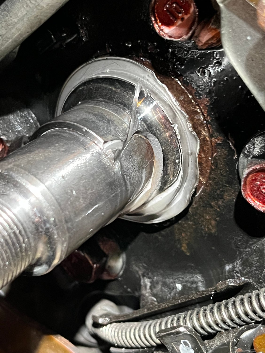

FINALLY got the damn thing off. Unfortunately I cut a little bit into the spindle. Hope that doesn't cause any issues. If I do need to replace the spindle, does anyone know the part #? I could only find the 2007-2008 spindle (part #52200-SLN-A00). For the 2009 model it seems every supplier only carries the rear axle assembly and not the spindle alone. While I'm sure it wouldn't hurt to replace the entire thing, I simply don't have $1000 to drop on something like that.
Gouged the spindle when I was cutting the inner race off
