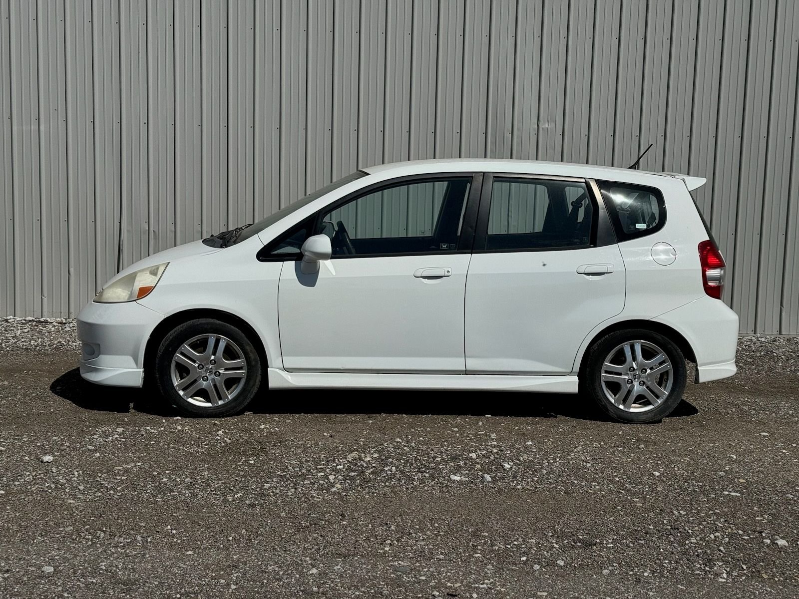

As for my dilemma…….. All the wheel bearing noise coming from the front drivers side, which I replaced that bearing, WASN’T the bad one. It was the front passenger side. Which is freaky. Cause the bearing noise increased when unloading weight on right side, by turning right! Good thing I have Monday off. I’ll get the bearing tomorrow & put it on Monday.
Thanks for all the advice. I’m a newer Fit owner, and although I don’t have a manual, I do have flappy paddles. I’ll check in now & again as I look to upgrade my Fit. I’ve done a few small things, replaced the antenna with a shark fin, storage space cover, and center console/arm rest. I want to put in cold air intake, but don’t want a cheap $60 kit, nor spend $400 on a kit. Any suggestions on that.
Opps wrong phot, stupid antenna still on.
