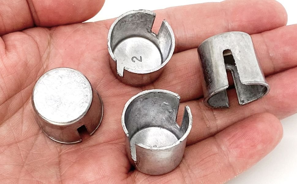

Have a 2009 Sport that has a grinding starter noise when cold (I live in the Chicago area).rest of day starts normally Battery tests good, checked water and bench charged it - same issue on cold mornings. Local repair shop said I probably needed a new battery and starter.
Was going to do the larger battery upgrade (either 15r or 26r) but mine is too tight a fit for either and I don't want to give up my plastic battery tray. Then I took a good look at my cables and terminal clamps - both are a bit loose even when clamp is fully tightened. So I cleaned and roughed up the batter terminals and clamps and installed these shims for a very tight fit now. So far the starter has not made a noise since the install so maybe a crappy cable connection was my main issue....

Sounds possible. Weak power to the starter (either weak battery or bad connection) are the cause of most starting issues, especially in colder temps.

Shims are not a bad idea. You could put some dielectric grease on there, as well. I don't know why Honda used battery clamps that are the wrong size for the battery terminals. In fact, the numerous battery complaints on Fits have aggravated a lot of customers. Honda really blew it on an issue that would have been so simple to get right.
