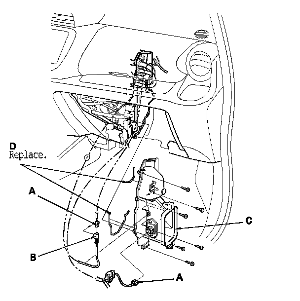

Diagram shows 6 screws. Probably missed the top and bottom ones.
Got the diagram from here. Good site to bookmark
I really appreciate it. I found them and wow were they tough to get to😄😄
