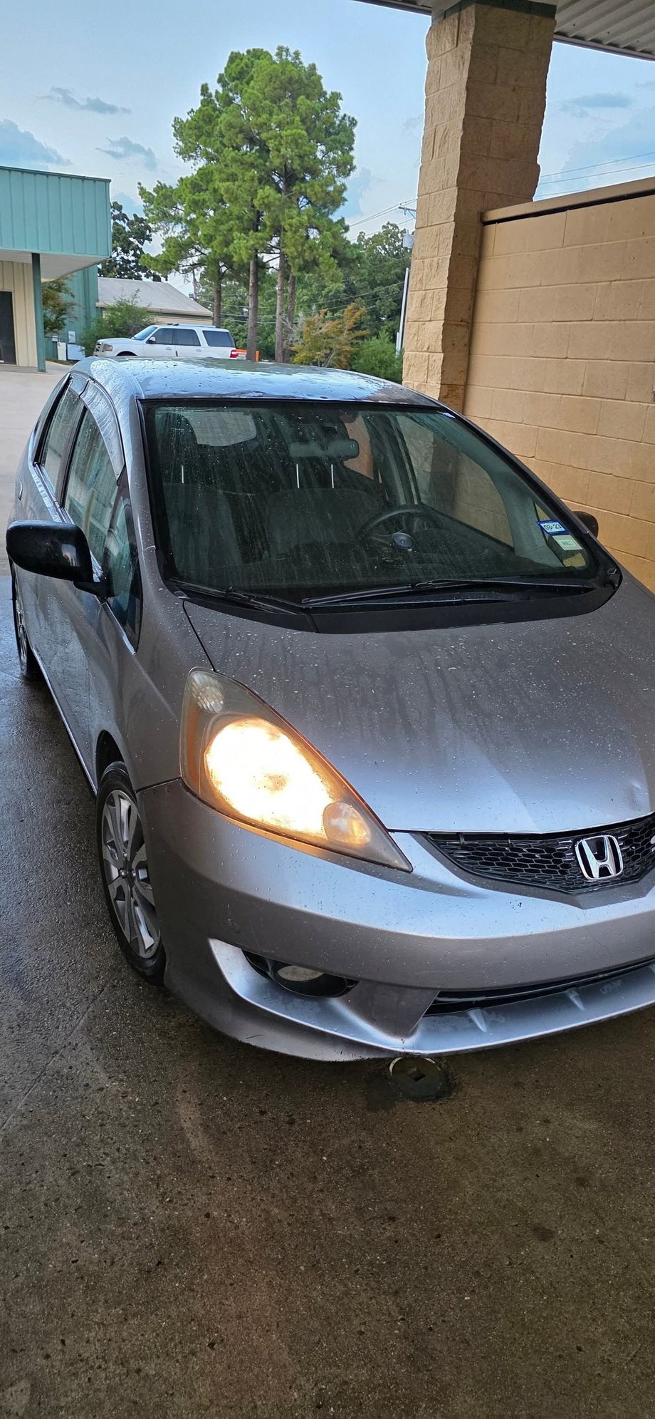

Hi guys I picked up my 3rd Honda fit and couple days ago since my daily has bad oil leak. The one I got the other day is a 2010 fit sport and the issue im having is the dam windows won't roll down! Only one that will roll down is the front passenger window. I figuerd it was something to do with the window switch but NOPE! I ended up swapping both the driver side doors out as the ones that was on the car had dents and a hole ripped in it so I swapped them with mine from my 09 fit which by the way the windows worked perfect in that fit. So that begin said I know for fact the motors are good. The window switch is good because all that came from my other car. I checked all the fuses and there fine. I don't know what the hell there is left that it could be! Only thing I didn't change was the passenger rear door or motor. I wouldn't think that would have any effect on the other windows though. They also won't roll down with the switches on the corresponding doors. Im all out of ideas! Anyone have any ideas?
